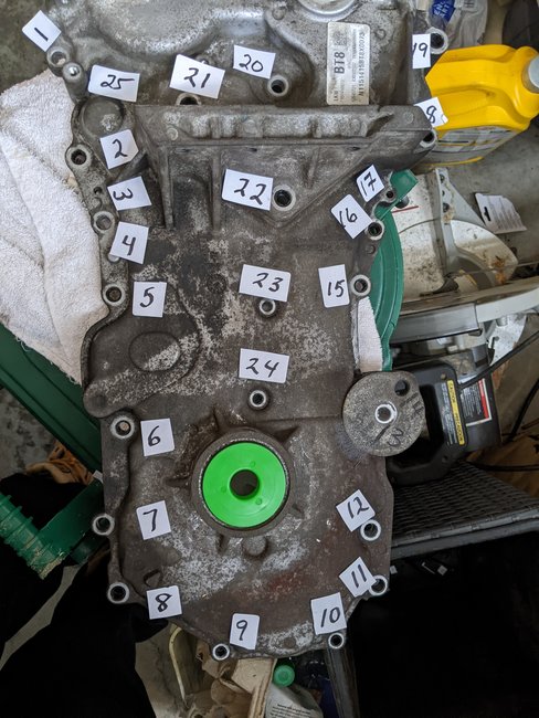

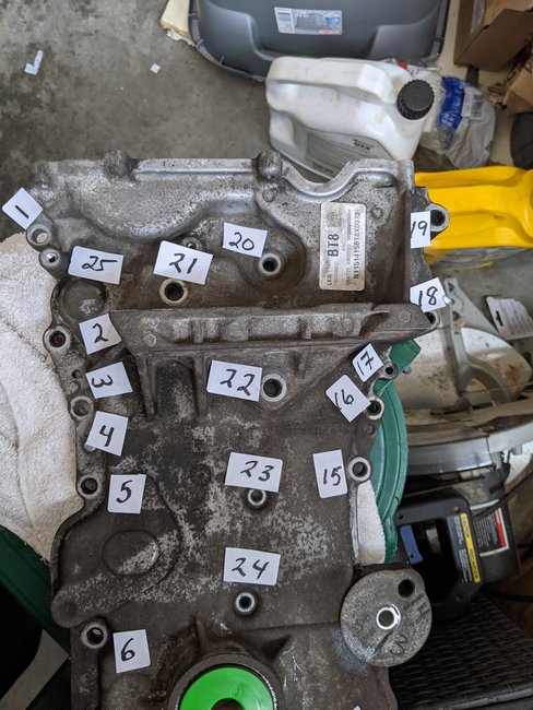

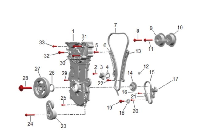

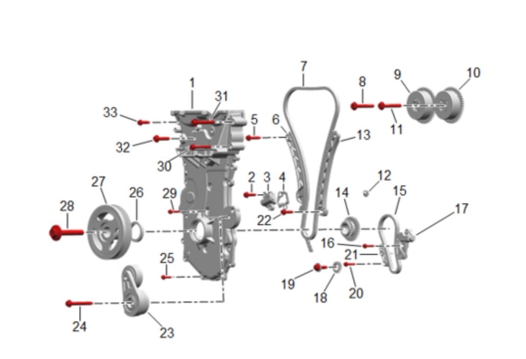

Unfortunately, I didn't take a picture of either cam before I took them out. You wouldn't happen to have a diagram of both of them where the bolts go, do you? For both.
Thanks
Friday, December 31st, 2021 AT 5:04 PM
TOSKY
  • 22 POSTS

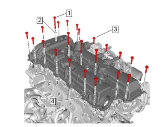

I meant covers. The front timing cover and the valve cover. I'm lost, I am all mixed up where which bolt goes where.
Friday, December 31st, 2021 AT 5:05 PM
  • 52,797 POSTS

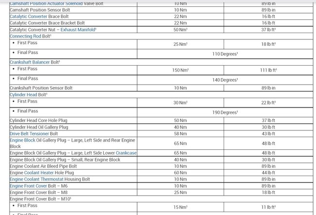

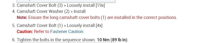

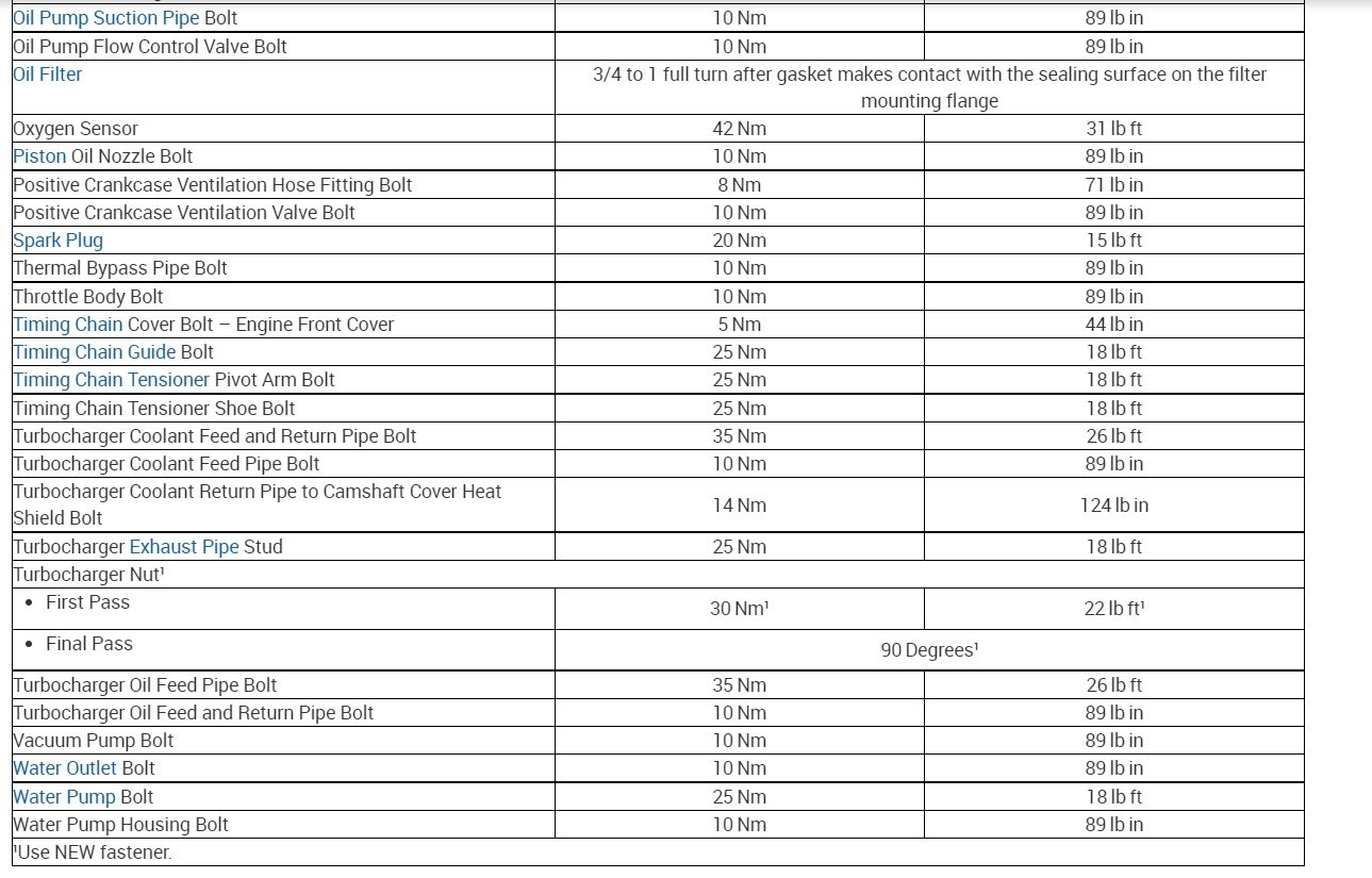

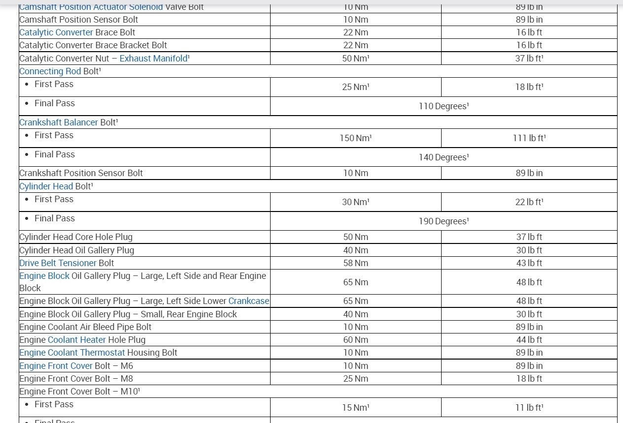

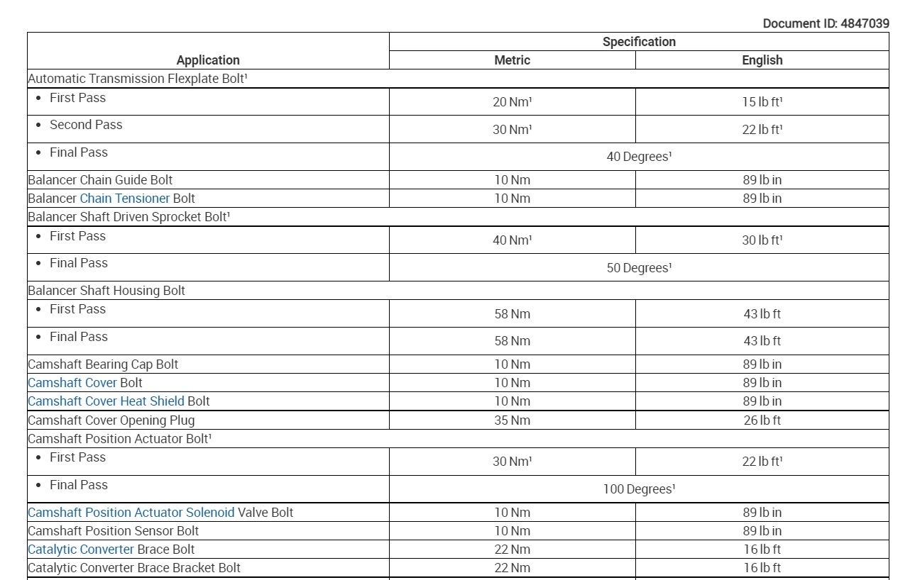

I attached the diagram for you and the torque space.
Saturday, January 1st, 2022 AT 3:59 PM
TOSKY
  • 22 POSTS

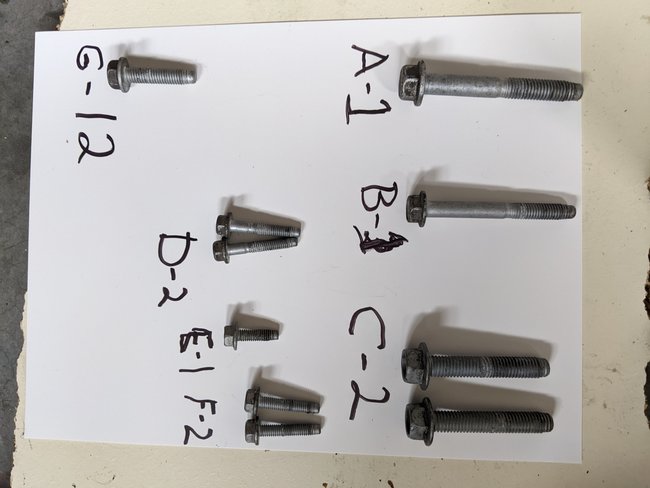

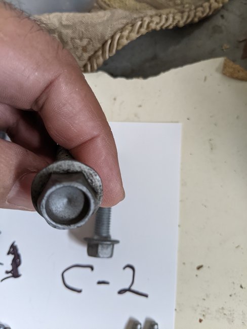

Thank you very much. I don't know what I would do without you. I'm just a bit confused which size bolts go where, but I'll have to figure it out, I should have marked them. Also, the sequence includes the inside behind the cover. It's just me, I am not very smart. I hope I didn't lose any bolts. Thanks.
Sunday, January 2nd, 2022 AT 7:15 AM
TOSKY
  • 22 POSTS
This is what I have: A total of 21 bolts. The bolt for the tensioner is on it right now, so that one is not missing. I named these to simplify it. There is A-1. B-1. C-2 D-2. E-1 F-2. And G-12 for a total of 21 bolts altogether. And because I was a dummy and didn't take a picture, I am having a tough time remembering what goes where. If you have anything else that could help me, I would appreciate it. If not, you have already helped me enough. Thanks.
Sunday, January 2nd, 2022 AT 10:52 AM
  • 52,797 POSTS
I wish I could help you here, but you are going to have to try each one at a time.
If I was there, I could do it for you but unfortunately, I am not.
Monday, January 3rd, 2022 AT 2:54 AM
TOSKY
  • 22 POSTS

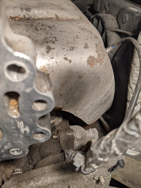

I understand, thanks anyways. Do you know what goes herein these two side holes on this picture, the 2 outside ones? It's been a while since I took apart and I can't remember. Thanks.
Monday, January 3rd, 2022 AT 6:48 PM
  • 52,797 POSTS
It looks like a bracket may be mounted there for something to bolt on.
What extra parts do you have at this time?
