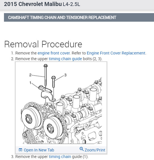

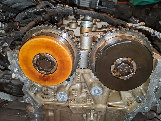

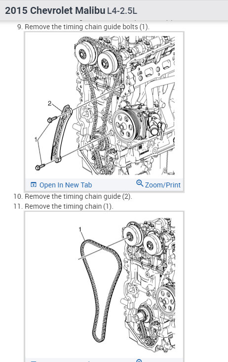

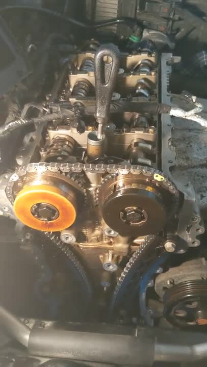

After getting OBD code P0016 on the car listed above I spent a few days erasing the code and driving the car. The car was running fine, but I was afraid of damage, so after checking a few things, I took the covers off to replace the timing chain and tensioners. Since I had no knowledge of this as it was the first time, I didn't bother to make any marks. The marks didn't line up so put the chain on the crank and the intake (diamond) and moved it to mark. Then I tried to do it to the exhaust (triangle) to shaft to try to get the mark lined at 2 o'clock but it wouldn't move clockwise so i stopped. Then i had a friend with knowledge come and help me, so he put the chain on, but the exhaust (diamond) would not move to 2 'oclock position. It is more 1 0'clock and the diamond is at 2 o'clock. So when we put the chain on, we had to pull the triangle to the right because the still position, the chain would not reach from the 5 o'clock to the triangle mark, which would be 1'oclock. So we put it on the marks after pushing it over. Anyways, after so many revolutions, the chain marks are all 3 a tooth behind the marks. Never match, chain and sprocket marks. We did a few more revolutions and still all 3 on the tooth before the mark. We tried quite a few times that he finally said, you are going to have to get someone with more knowledge than me. Any idea why that happens? Thanks. I don't know if you can tell on the picture but the one on the right is only at about 1 o'clock. They are just sitting in place and lightly bolted, not torqued and the chain is off btw.
Dec 17, 2021 at 9:55 AM
SQM
  • 6,383 POSTS

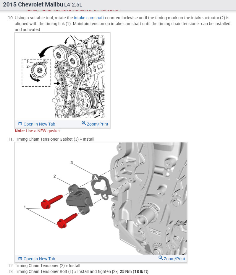

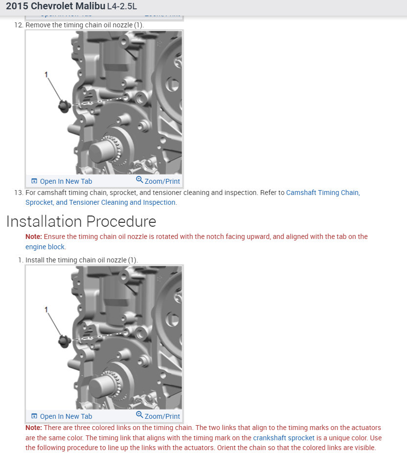

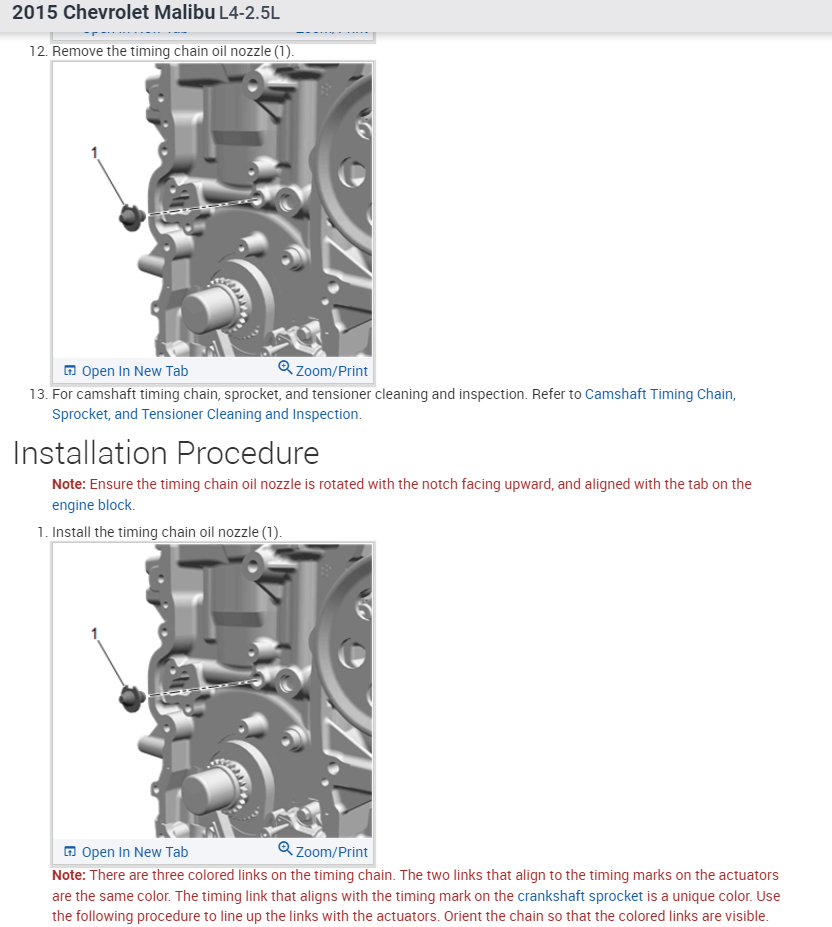

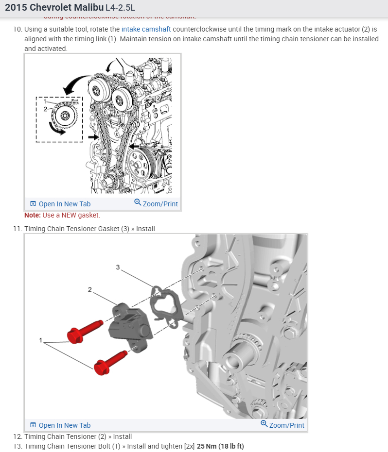

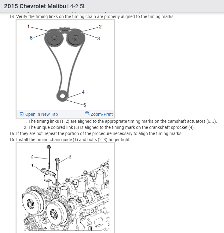

It is critical to do the chain in the correct order. This can help keep everything in place as even with a little variation you will end up with a misaligned chain.
I have attached the timing chain replacement guide below.
Look through this and go over these steps. It might even be helpful to start over.
Let me know if you have any questions.
Dec 17, 2021 at 10:06 AM

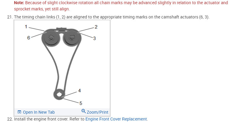

Thanks for the help, but it's not working. When I try to line up the marks of the chain with the exhaust sprocket(triangle) with the crank shaft, it's like the chain is too short between those two. I'm always a tooth short. |n order for the marks to match, the shaft is at about 11 o'clock and when i do the revolutions, it moves a tooth back in all 3 of them. Any idea why? You ever see anything like this? Thanks for any help.

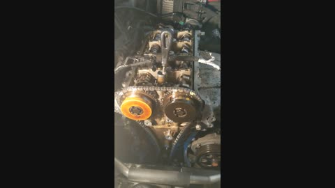

I made a video and put it on YouTube.
Dec 19, 2021 at 4:02 AM
Good morning,
Are those yellow marks permanent or did you paint those marks?
Dec 19, 2021 at 9:16 PM
TOSKY
  • 22 POSTS

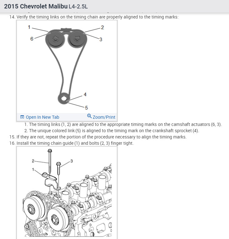

Yes, those marks on the chain are permanent. This is a new chain, and the old chain has the same marks. I don't know if you heard me on the video, but me not knowing anything at the time, when i opened the cover, I didn't rotate the crank to see how the time would wind up. I just took the chain out and moved the diamond to position. The Dymond must have been at probably 4 o'clock position because it hadn't finished the stroke, I guess. and i think i tried to move the triangle to position too but i got resistance from it, so i stopped at where the mark on the triangle is. I had a friend who is used to work on old cars. Came over and I told him what happened and with a wrench he moved the cam back probably 180. So, needless to say, those marks, diamond and triangle are facing the right way, but the problem is I don't know what stroke that is at. Correct? Because those engines are timed when they are built, you have to stay with their marks and only move the teeth you need to, correct? So I guess i wrecked it and there is no way of fixing it from scratch without taking the engine apart, is there? I'm asking. So, I don't know if I can't put the chain on those marks without the crank procket getting off the 12 o'clock position, as you see in the video. What do you think.? Thanks for all your help.
Dec 19, 2021 at 10:47 PM
The marks on the chain are for the initial setting only. Rotating after installing, the marks will never line up again.
Set the marks on all 3 gears and set the tensioner.
Dec 19, 2021 at 10:52 PM
TOSKY
  • 22 POSTS

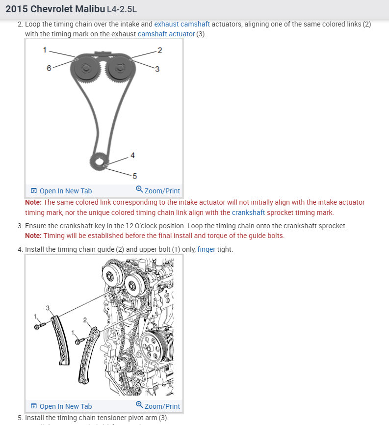

I can only get all 3 marks on the right if the crank shaft is at 11 o'clock. There is no way the chain reaches the dot on the crank shaft if it's in the 12 o'clock position. l wonder if it's because they are on different strokes, intake and exhaust cams? Thanks for putting up with a dumbo.
Dec 20, 2021 at 12:33 AM
The marks need to be set to where they belong. Then install the chain with the color links at the marks on the gears.
Move the crank back to where it should be.
If the links do not line up, make sure the chain is on correctly. The links can be off and if they are, move the chain around until the links line up.
Dec 20, 2021 at 6:47 AM

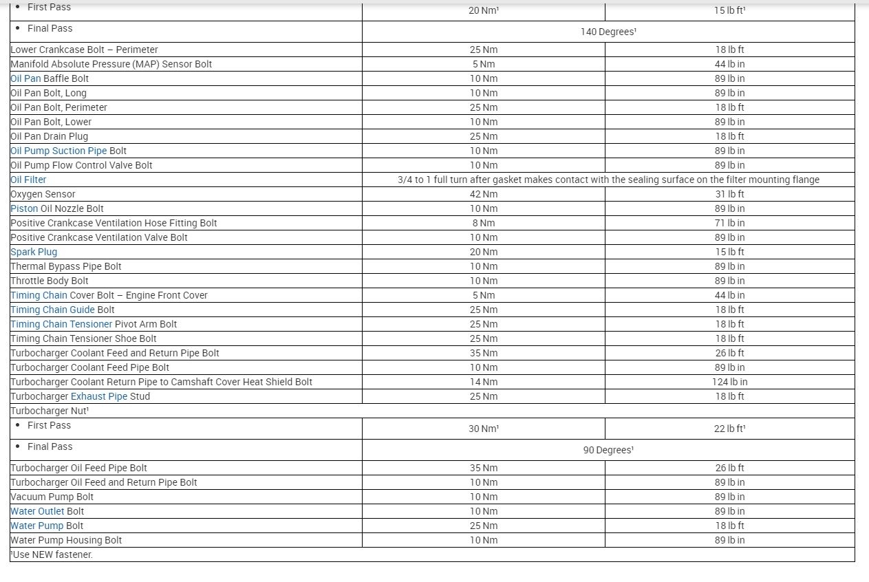

I put the chain together and i put a wrench on each cam to hold them in the mark. However, the exhaust cam, I had another person pulling it hard while i put all the marks together because it pulls back so much really hard on me. Once I had it all centered out, put all the tensioners in and the chain guides, I released the intake cam side tensioner and when he stopped pulling the exhaust came out so the mark on the sprocket would be on its position, it had so much force clockwise that the chain at the crank moved a tooth up towards the cam. I'm starting to wonder if the cam is pushing on some valves and that's where the resistance is. What do you think? Also, I didn't have the specs for the bolts on the cam phasers and saw the guy on cloyes and he set his at 63 ft pounds and plus another 30 degrees, so I torqued mine the same torque. But I don't think GM's specs are that high. Do you know all the specs for all the bolts on the timing chain area for 2015 Chevrolet Malibu 2.5? I'm afraid i gave them too much torque on the cam phasers and the tensioners and guides. I see the diagram you put there, it says 18-foot pounds for the bolts on guides and tensioners. He says 89 inch pounds. Also, he says 37 pounds for the balance sprocket. Do you know the GM specs for all those please? Thanks.
Dec 25, 2021 at 8:14 AM

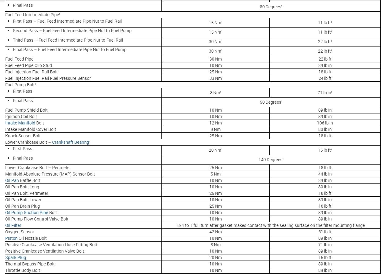

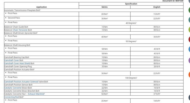

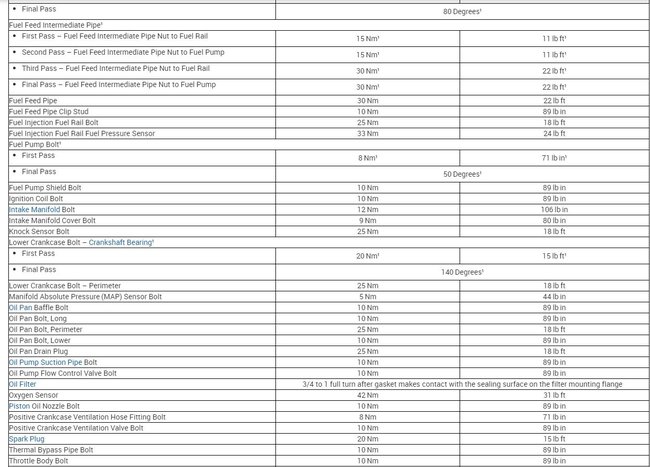

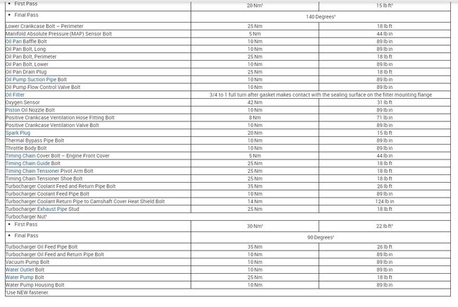

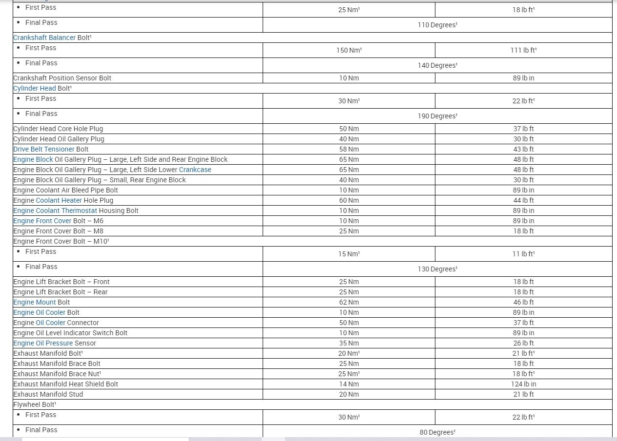

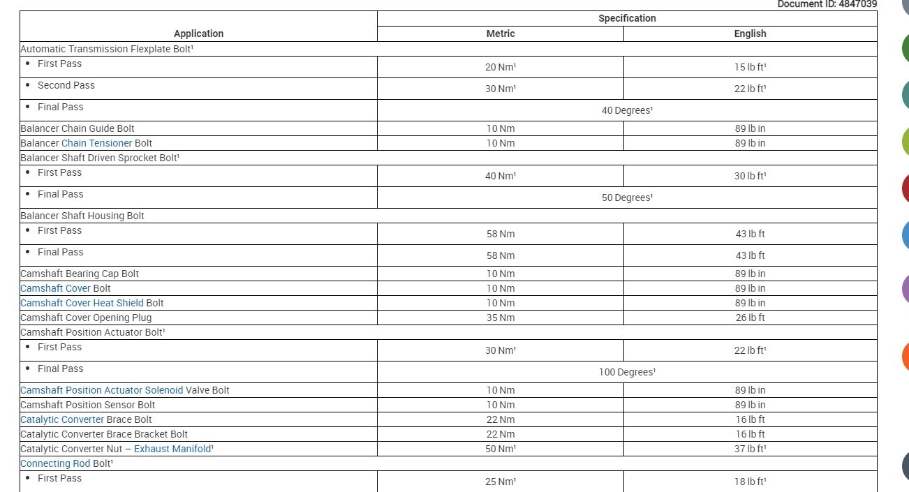

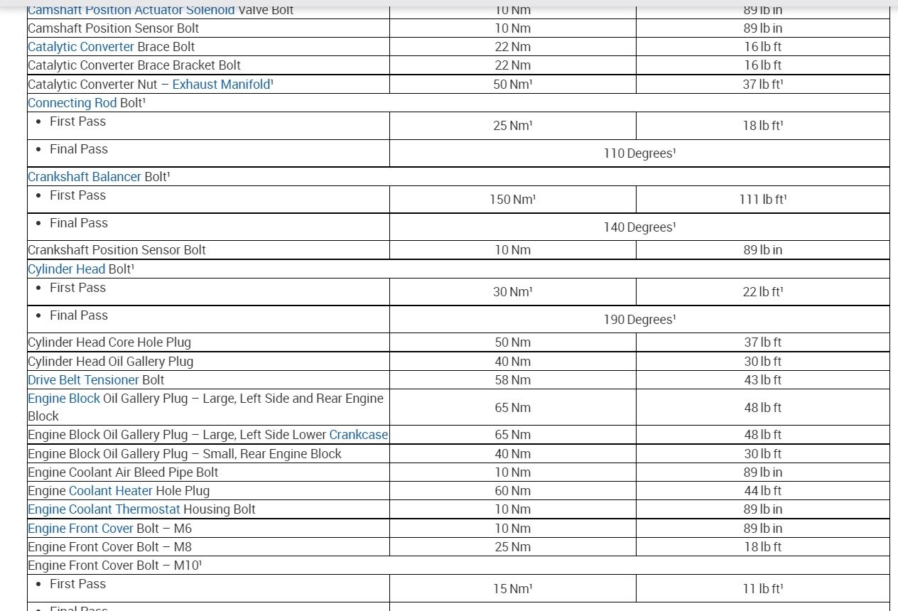

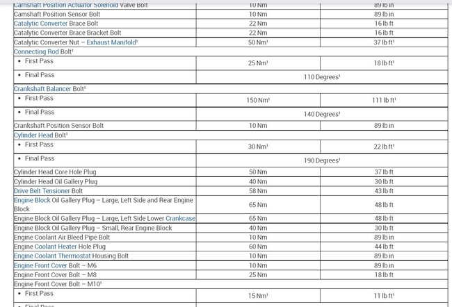

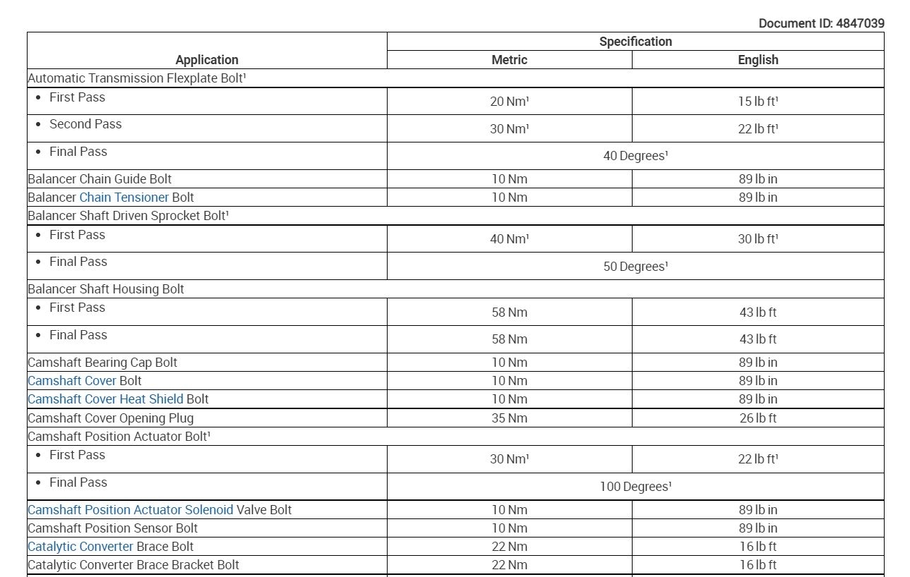

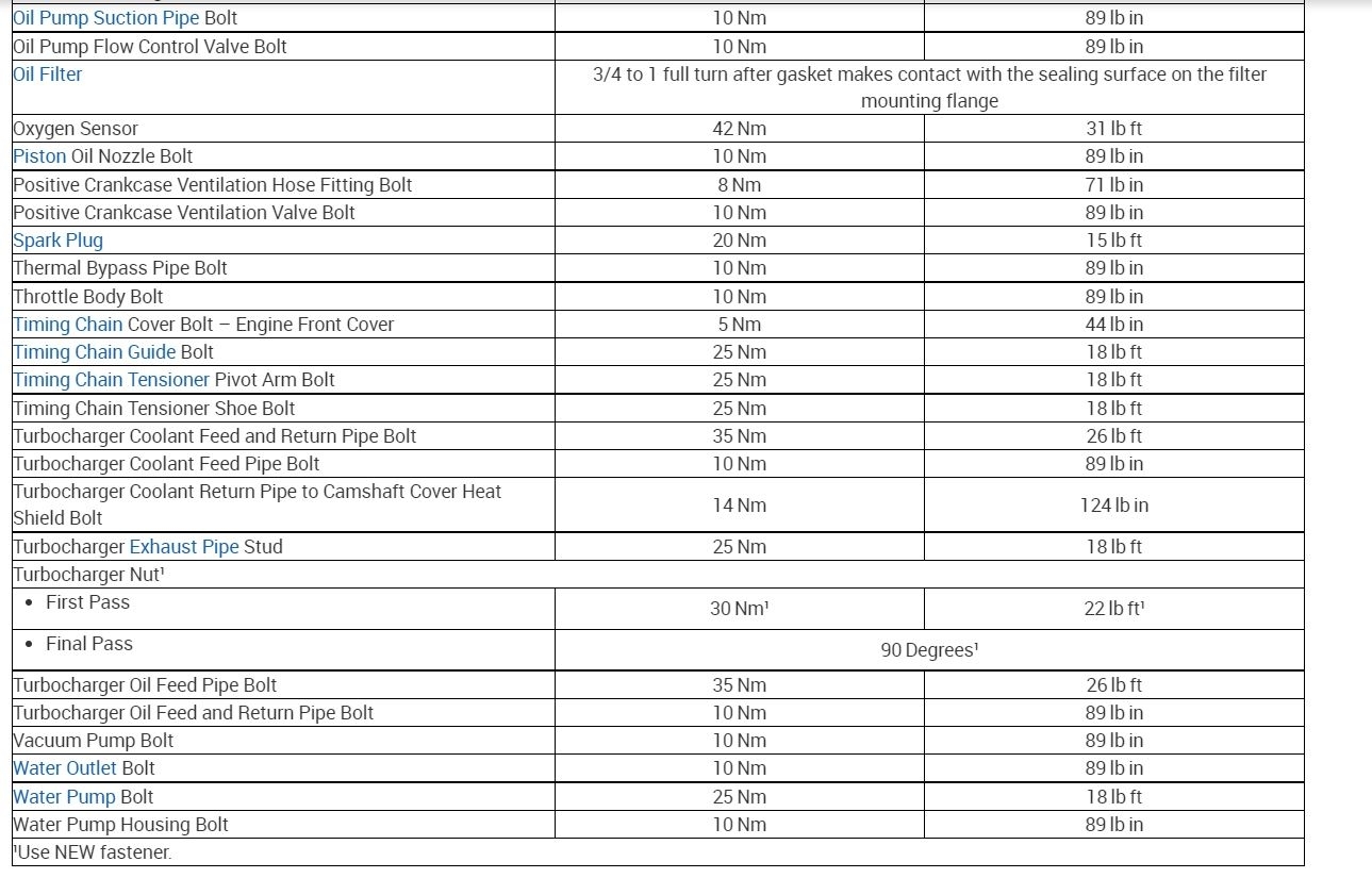

Okay, I attached the torque specs for all the bolts on the engine.
Any bolt that requires an additional turn of degrees is called a TTY or torque to yield bolt. They are one-time use only and cannot be reused without the possibility of the bolt either breaking or coming loose.
Replace those bolts.
Dec 25, 2021 at 9:33 AM

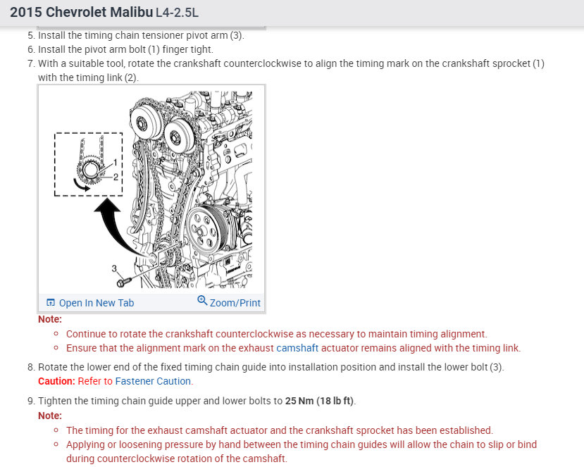

I really appreciate your help. You have stopped me from making huge mistakes. But now I still have the issue of the resistance from the triangle sprocket side. It's pulling everything back, that cam, which is exhaust i believe. I made a video so you can see what I mean. I appreciate any further input. Thanks.
https://www.youtube.com/watch?v=SuDceNgue1k
Dec 28, 2021 at 11:15 AM

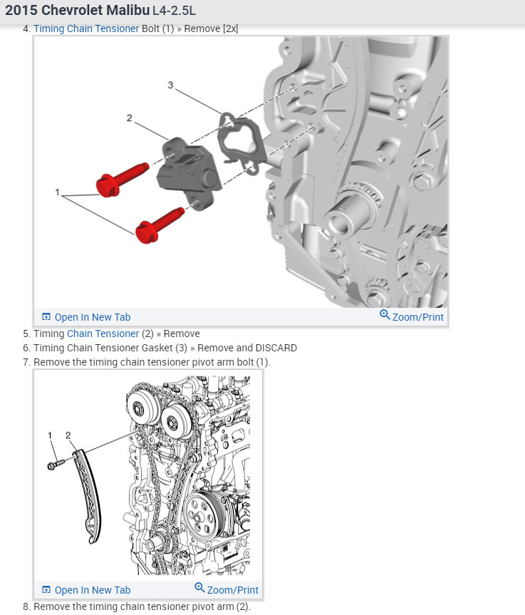

The chain looks loose. Did you install the tensioner?
Remove the other 3 plugs and see if it turns free.
Dec 28, 2021 at 7:28 PM
TOSKY
  • 22 POSTS
That's the old chain on. The problem is that on the right side when i put the chain on the triangle and then down on the crank shaft position, i have to pull hard with a wrench on the cam. I had someone applying pressure clockwise on the cam, so I could put it in at the bottom. I had to tie it with a zip lock tie to hold it in place due to the amount of pressure back, as you can see it pulls the crankshaft out of 12 o'clock position. The chain does look loose, but i had the new chain on and it's real tight that the pressure makes it skip a tooth. I've tried everything and that cam pressure counterclockwise is always there. I'm not sure what 3 plugs you are talking about. Thanks for the help.
Dec 28, 2021 at 7:46 PM
Take out the remaining 3 spark plugs and rotate the motor.
Dec 28, 2021 at 8:02 PM
TOSKY
  • 22 POSTS
i got them all out from the beginning. I have rotated the motor. Doesn't feel like it's hitting anything but there is still a lot of pressure.
Dec 28, 2021 at 8:42 PM
As long as it turns freely without hitting anything, then you don't have a bent valve.

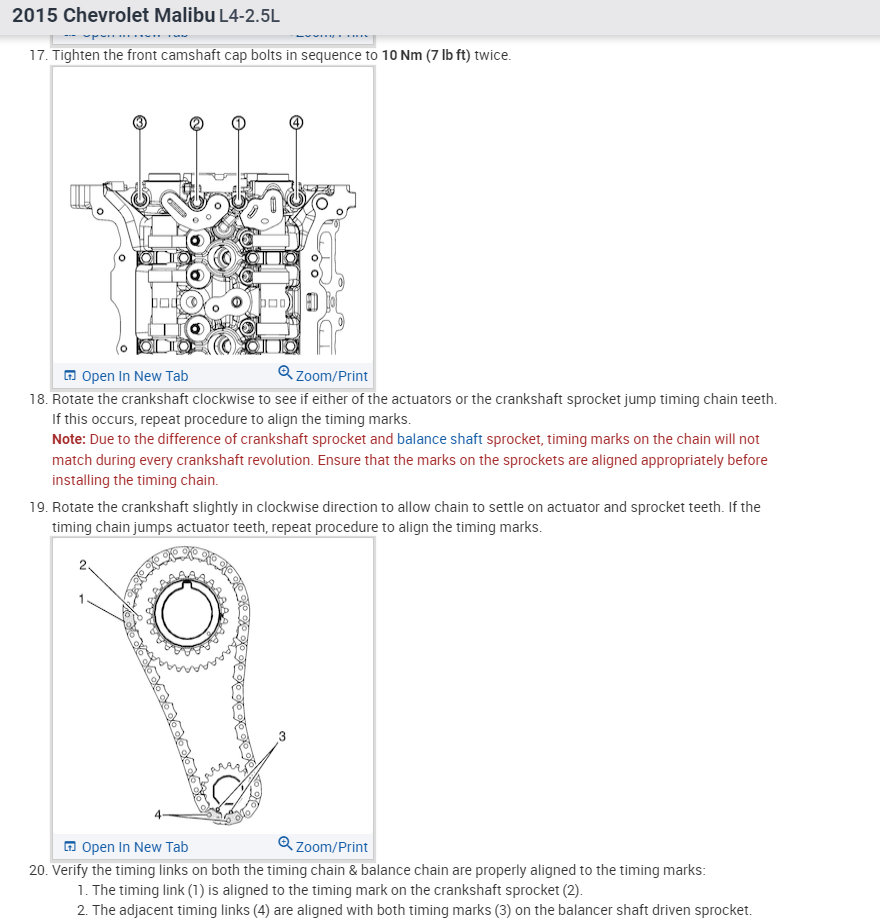

I replaced the balance chain with a new sprocket. I did it a few days ago with everything on TDC. I put it on the mark in the crank sprocket and the balance shaft driven sprocket. However, I have rotated the crank and cams several times and put the old chain in and new in and out trying everything. So, every time i took the chain out and put it back in, the chain had not stopped on the marks, it was just TDC on the sprockets and the crank shaft sprocket. Does it matter that the balance chain marks are not matched with the sprocket marks at the same time as the timing chain on the cams and crank? It was still put in on TDC. I originally put the balance chain at the same time as the timing chain, but i wasn't planning to take it out so many times, so every time i took it out, i had to leave the balance one in. Thanks
Dec 29, 2021 at 8:58 AM
The engine, the marks on the chain will never line up again. That is normal.
The marks on the chain are for initial setup only.
Once you turn the engine, the marks will never line up again.
Dec 29, 2021 at 9:14 AM
TOSKY
  • 22 POSTS
What i meant was, does the balance chain have to be put in their respective marks at the same time the timing chain is done, or is it okay that it was there already? I don't know how a balance chain works, so i ask.
Dec 29, 2021 at 9:57 AM
This chain is not timed. It just runs the oil pump. No worries on aligning any marks.

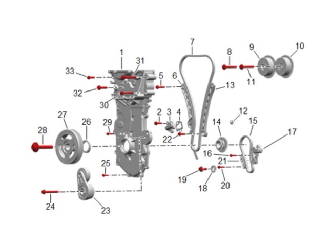

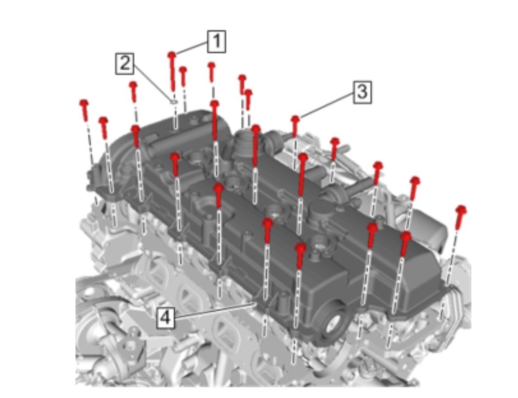

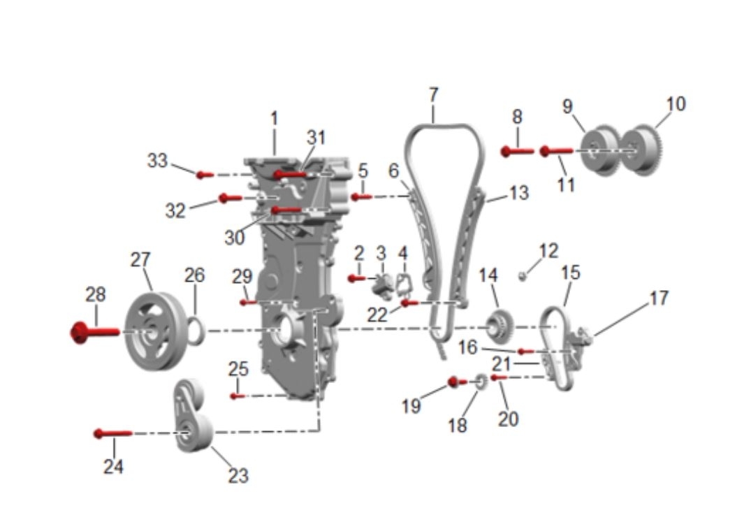

Unfortunately, I didn't take a picture of either cam before I took them out. You wouldn't happen to have a diagram of both of them where the bolts go, do you? For both.
Thanks
Dec 31, 2021 at 9:04 AM
TOSKY
  • 22 POSTS

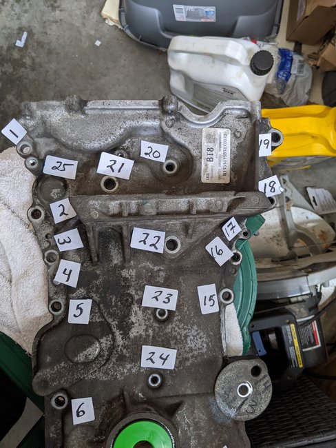

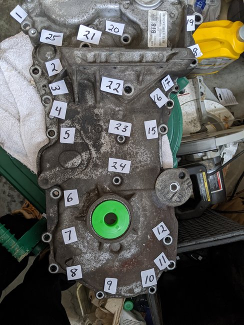

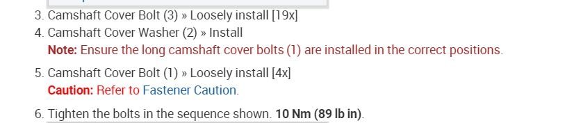

I meant covers. The front timing cover and the valve cover. I'm lost, I am all mixed up where which bolt goes where.
Dec 31, 2021 at 9:05 AM
I attached the diagram for you and the torque space.
Jan 1, 2022 at 7:59 AM

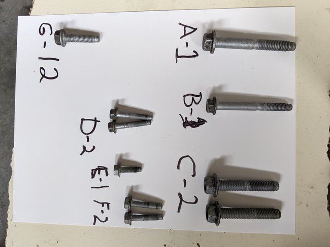

TOSKY
  • 22 POSTS
Thank you very much. I don't know what I would do without you. I'm just a bit confused which size bolts go where, but I'll have to figure it out, I should have marked them. Also, the sequence includes the inside behind the cover. It's just me, I am not very smart. I hope I didn't lose any bolts. Thanks.
Jan 1, 2022 at 11:15 PM
TOSKY
  • 22 POSTS

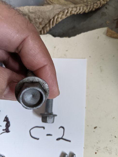

This is what I have: A total of 21 bolts. The bolt for the tensioner is on it right now, so that one is not missing. I named these to simplify it. There is A-1. B-1. C-2 D-2. E-1 F-2. and G-12 for a total of 21 bolts altogether. And because I was a dummy and didn't take a picture, I am having a tough time remembering what goes where. If you have anything else that could help me, I would appreciate it. If not, you have already helped me enough. Thanks.
Jan 2, 2022 at 2:52 AM
I wish I could help you here, but you are going to have to try each one at a time.
If I was there, I could do it for you but unfortunately, I am not.
Jan 2, 2022 at 6:54 PM
TOSKY
  • 22 POSTS

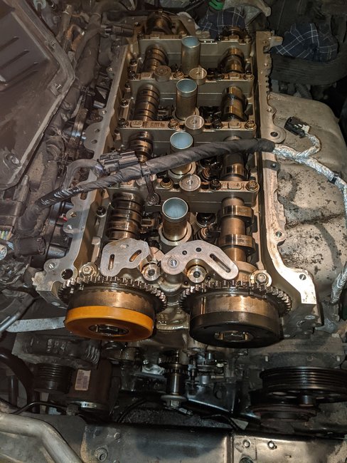

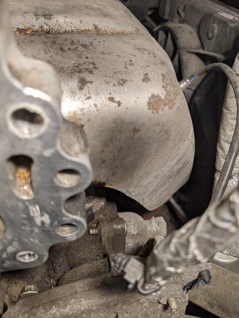

I understand, thanks anyways. Do you know what goes herein these two side holes on this picture, the 2 outside ones? It's been a while since i took apart and I can't remember. Thanks.
Jan 3, 2022 at 10:48 AM
It looks like a bracket may be mounted there for something to bolt on.
What extra parts do you have at this time?
Jan 3, 2022 at 7:55 PM
