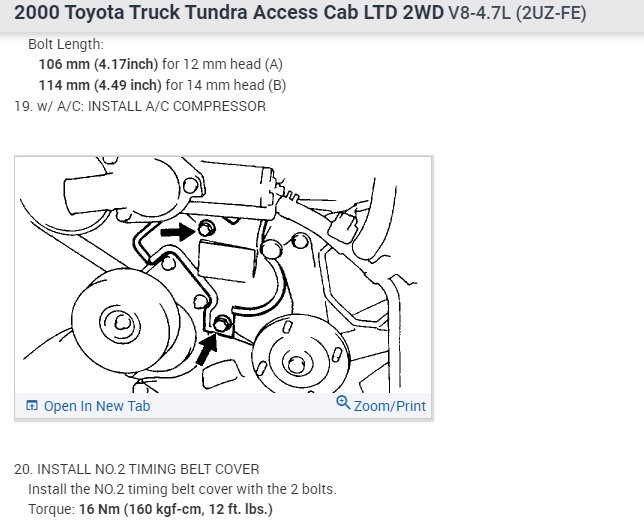

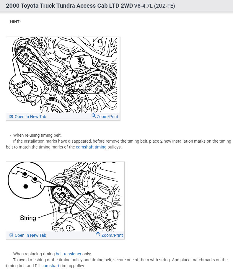

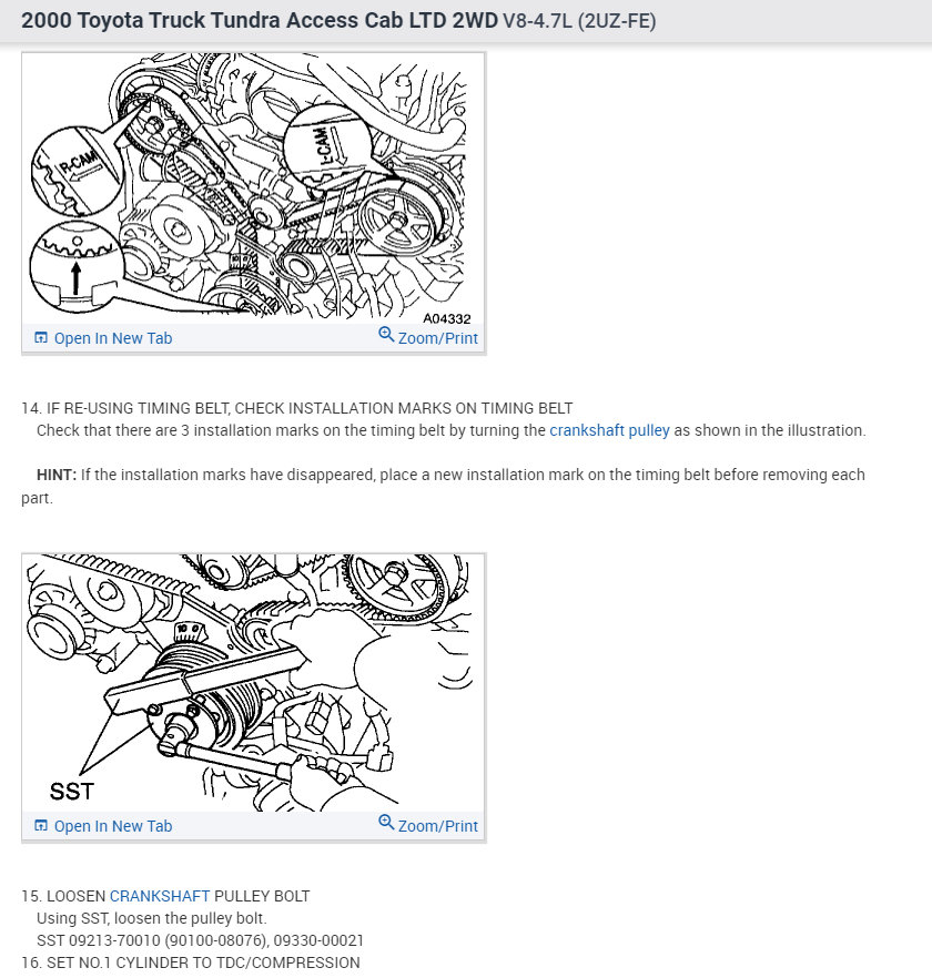

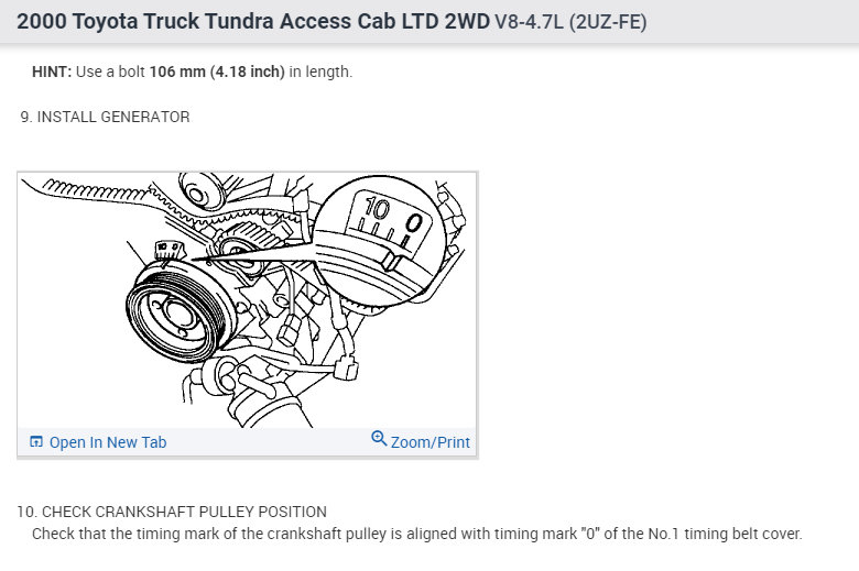

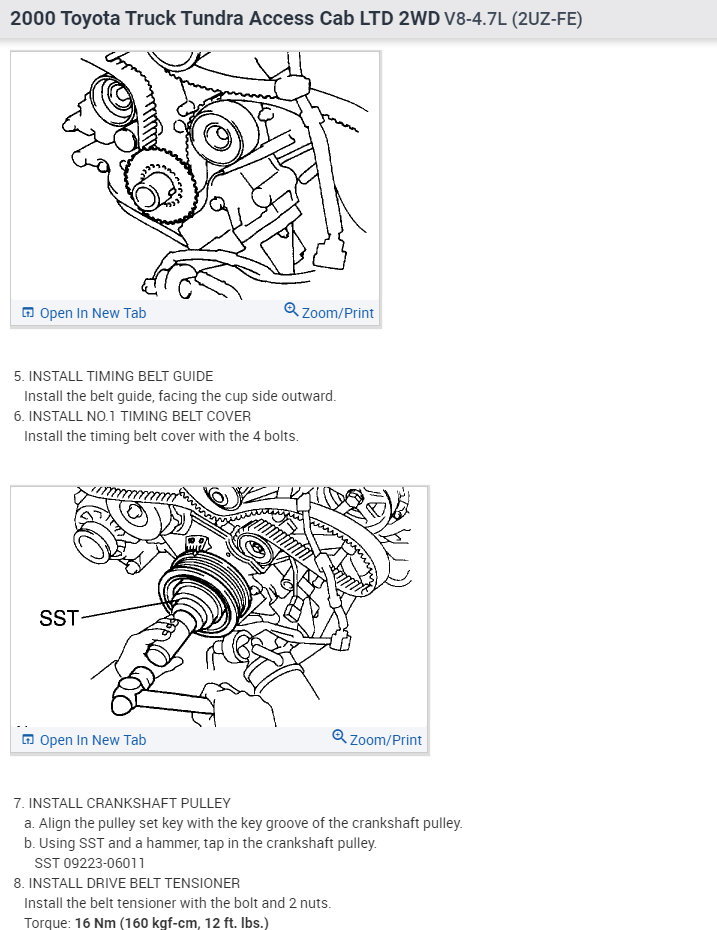

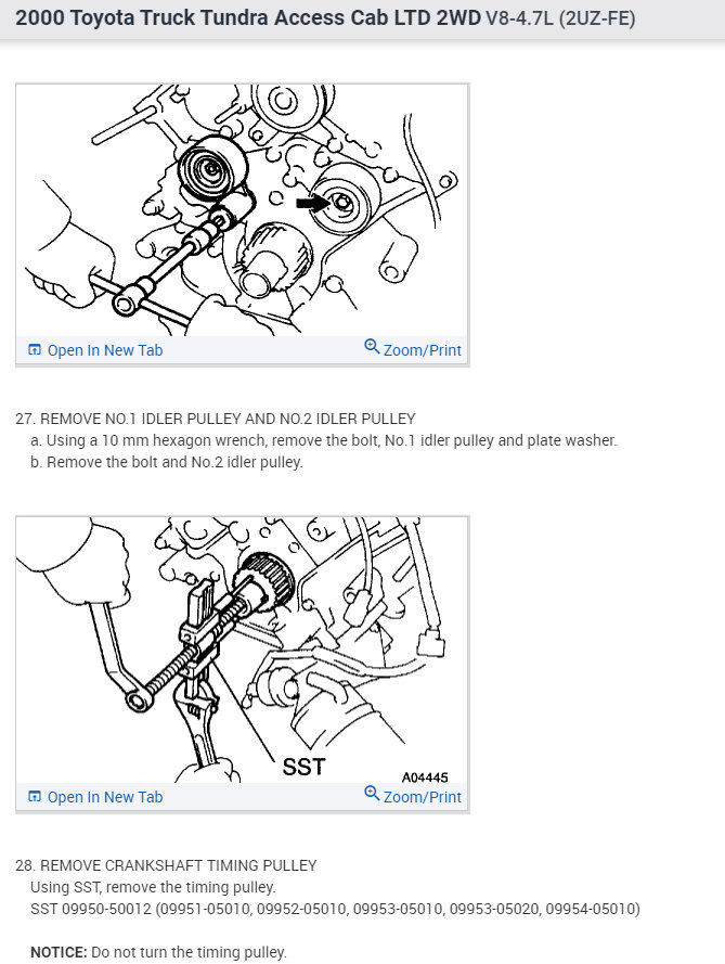

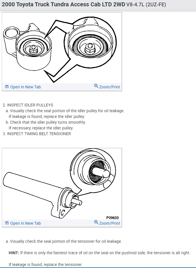

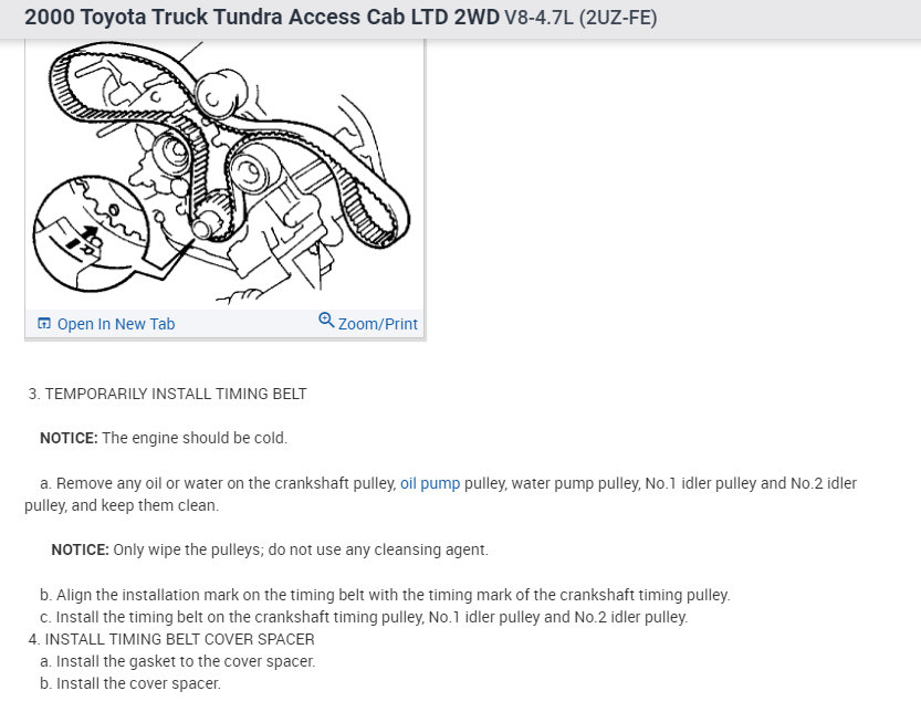

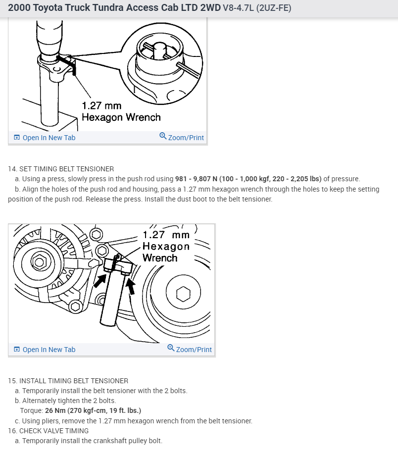

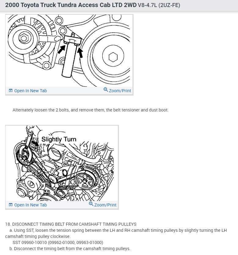

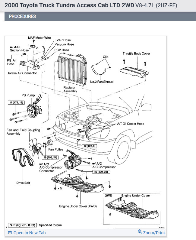

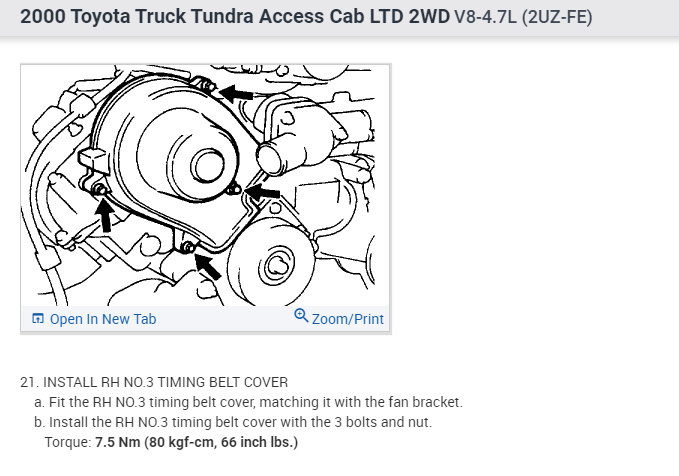

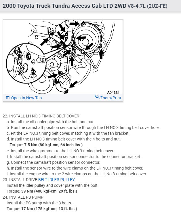

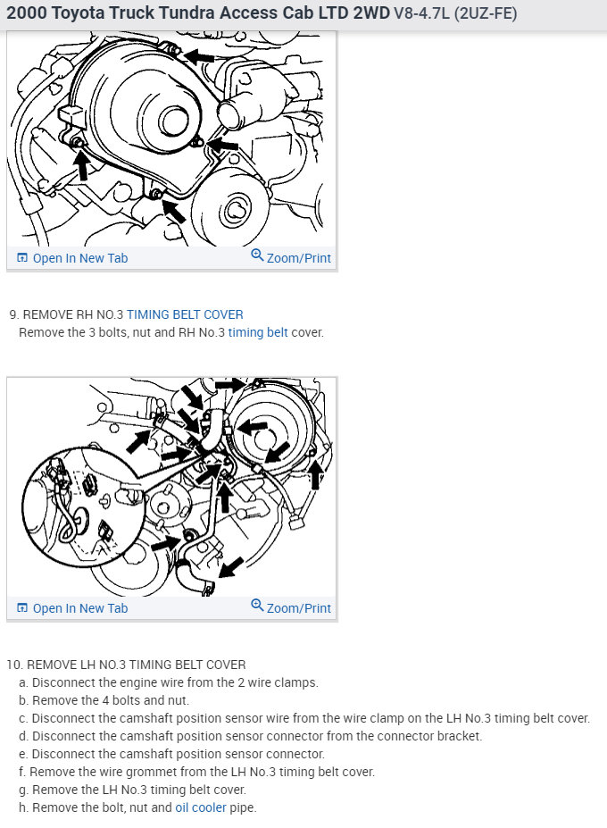

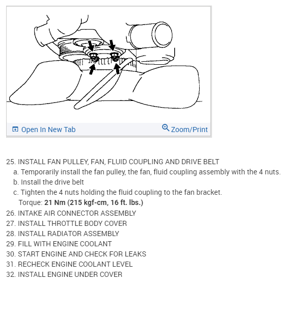

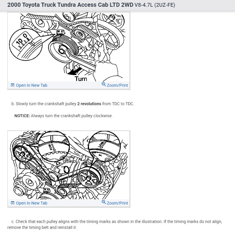

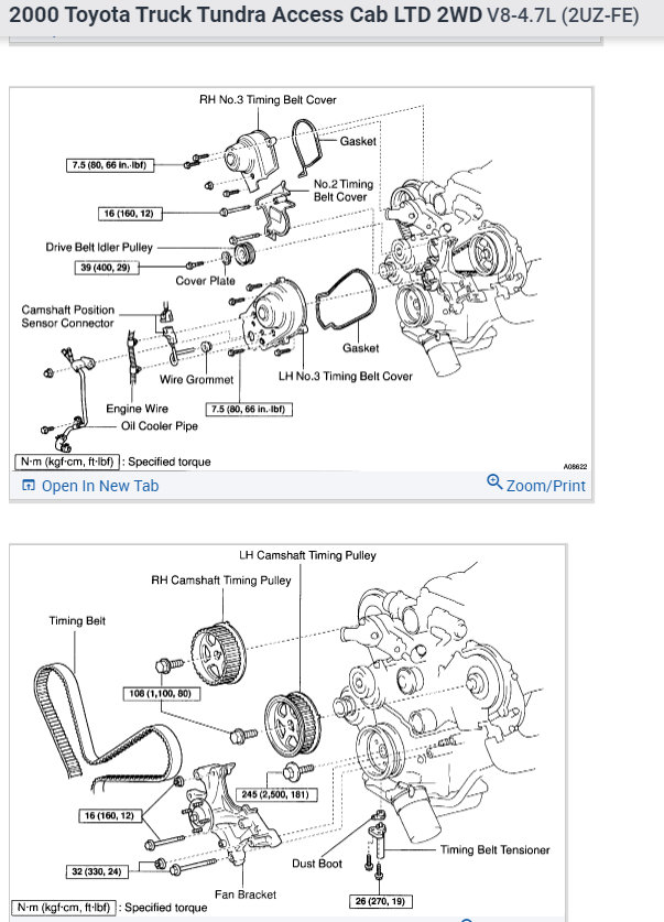

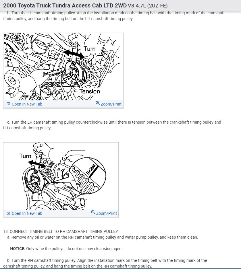

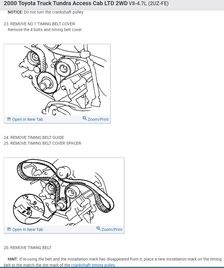

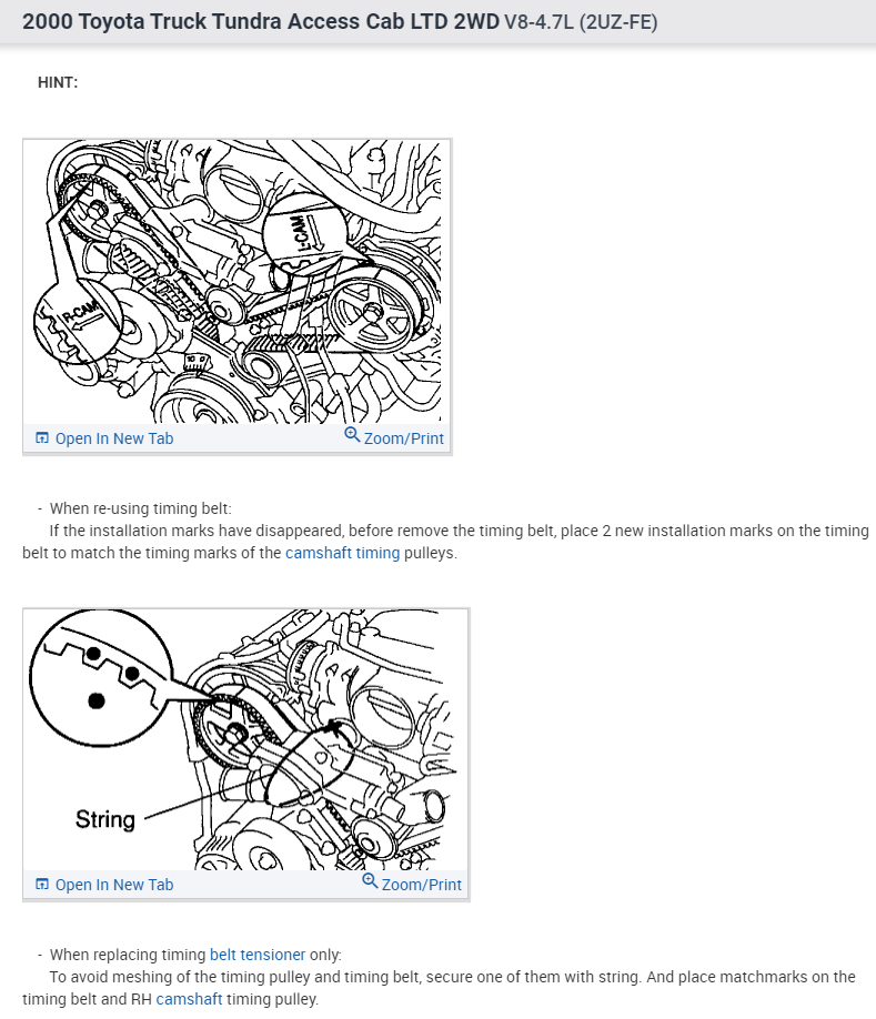

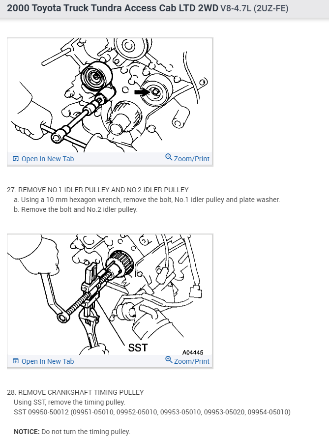

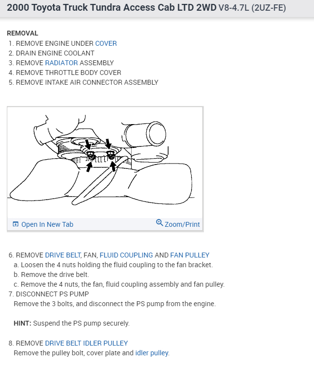

The timing belt i have only has one positioning make. Nothing for the left or right cam. How do i install it?
May 30, 2022 at 8:10 AM
SQM
  • CAR REPAIR CONTRIBUTOR
  • 6,383 POSTS

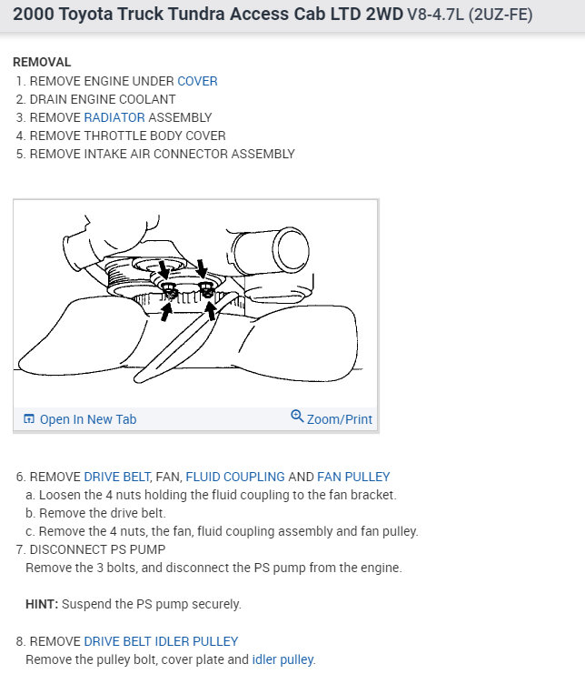

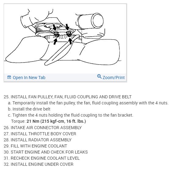

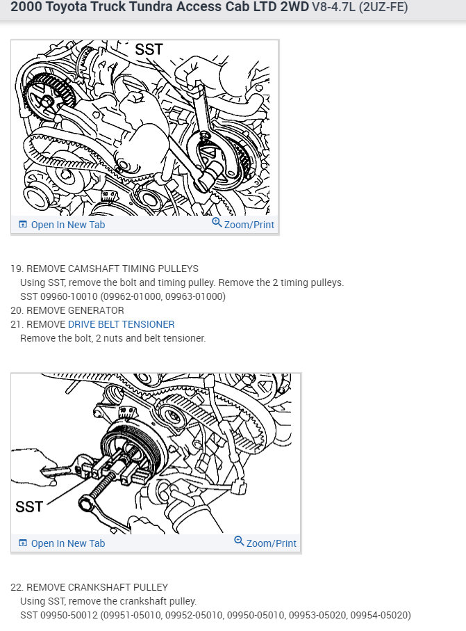

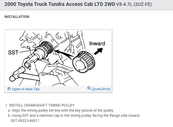

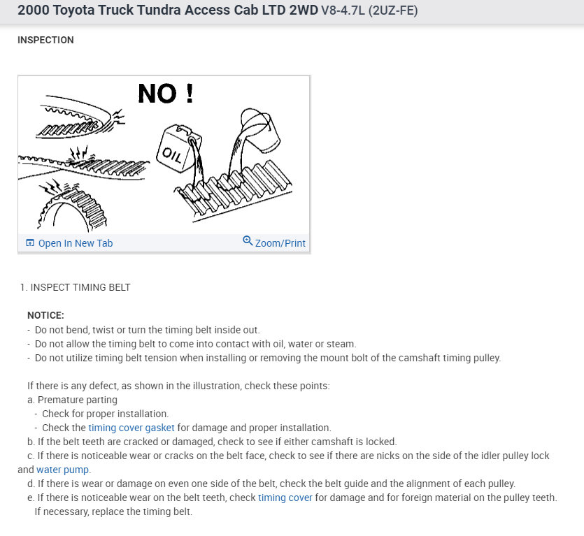

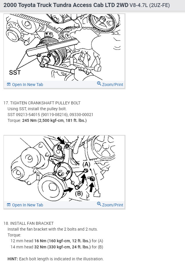

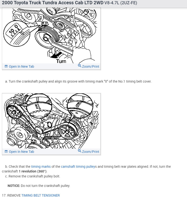

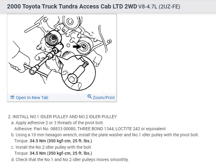

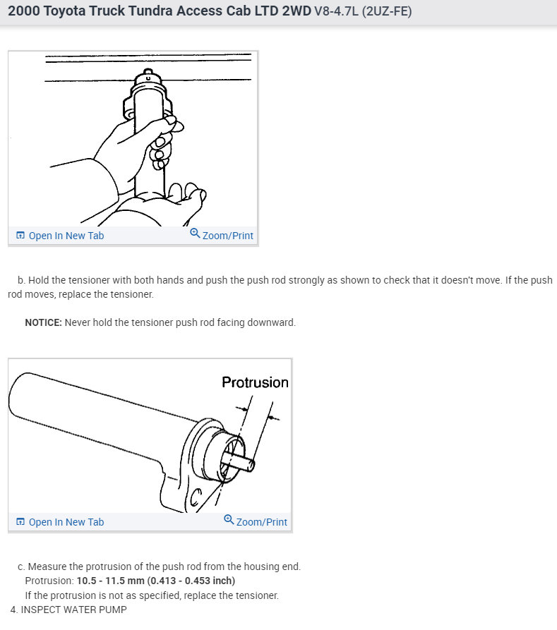

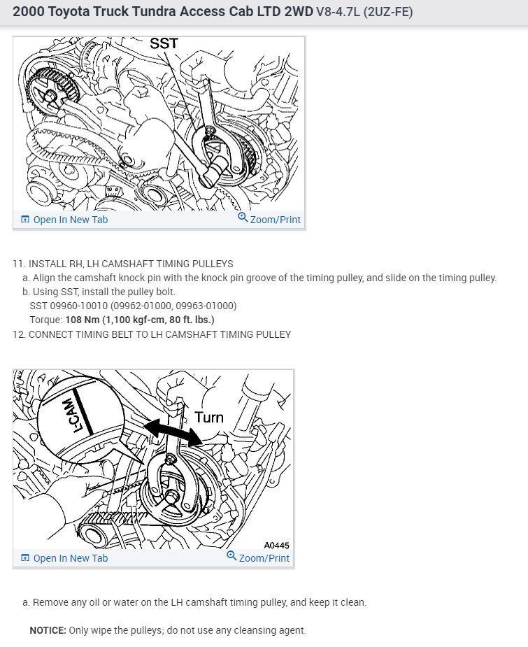

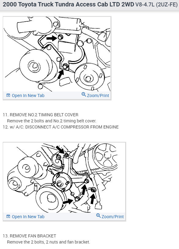

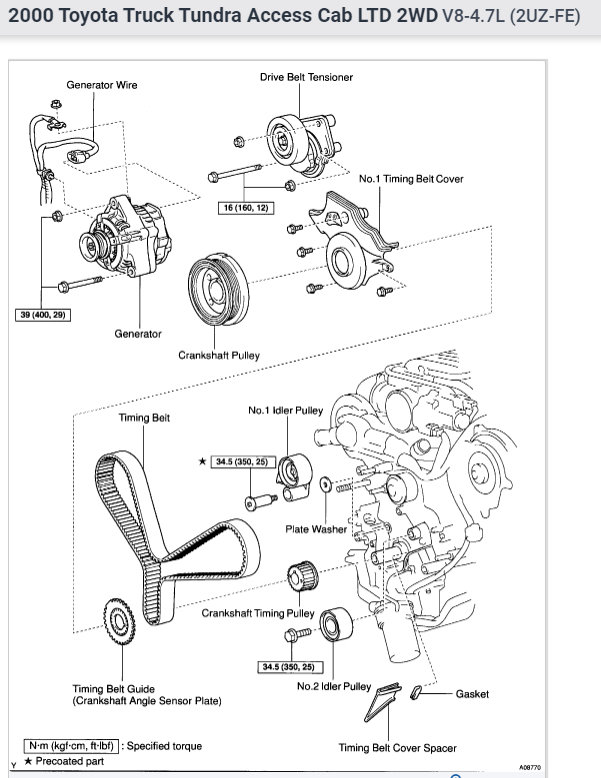

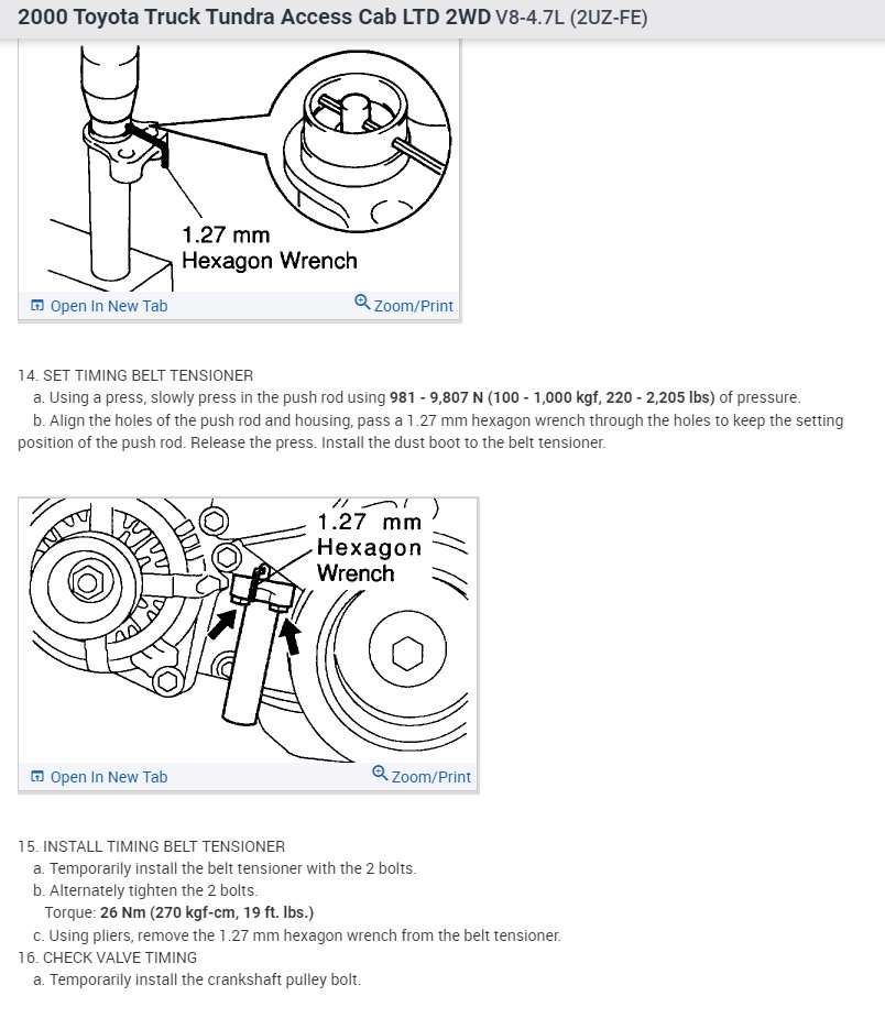

Take a look below, I have attached the complete timing belt replacement procedure. It shows all the steps and sequences and markings that will have to be lined up in order to install.
Keep in mind that the sequences of these steps are important.
https://www.2carpros.com/articles/how-a-timing-belt-works
Let me know of any questions.
