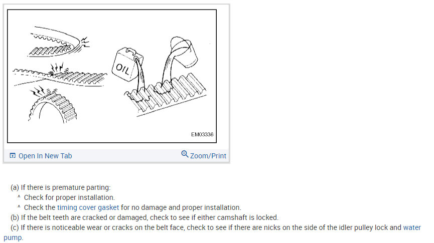

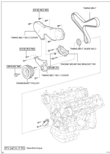

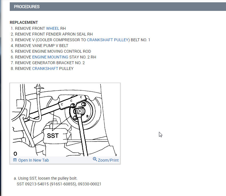

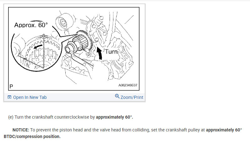

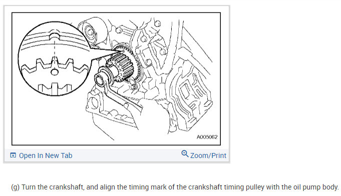

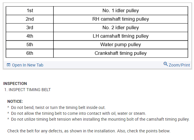

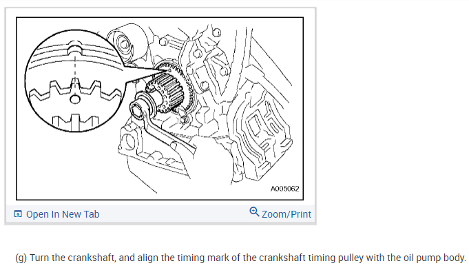

Here is the information you requested. For your information Toyota doesn't suggest replacing the timing belt until 90,000 miles. Here is a tutorial showing the function of a timing belt:
https://www.2carpros.com/articles/how-a-timing-belt-works

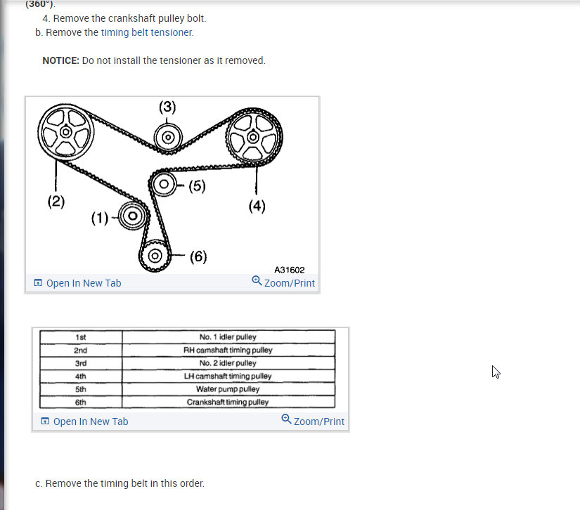

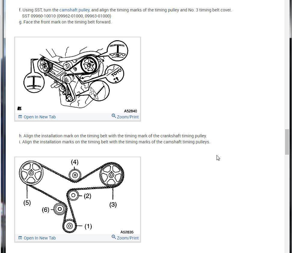

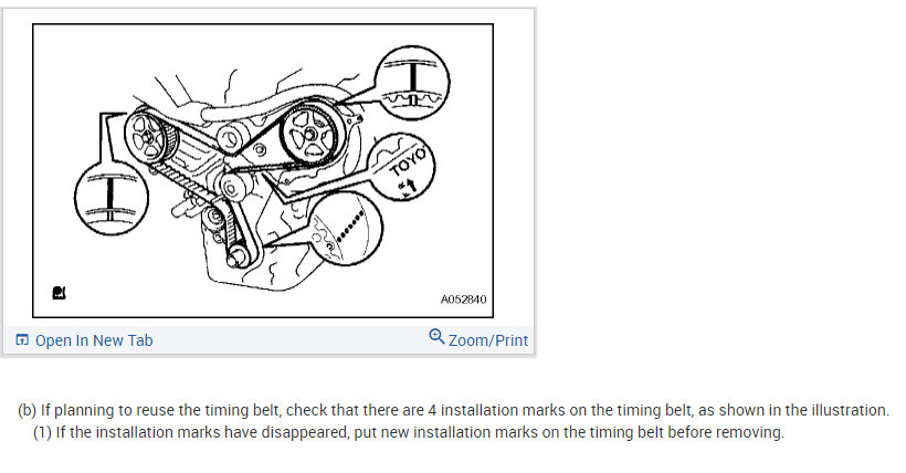

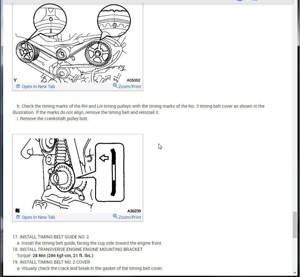

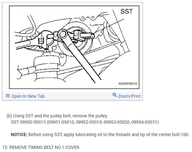

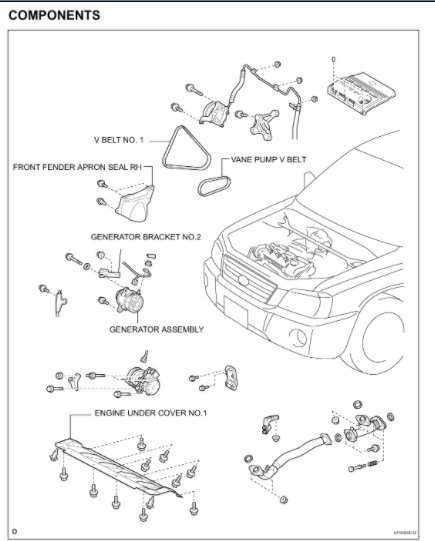

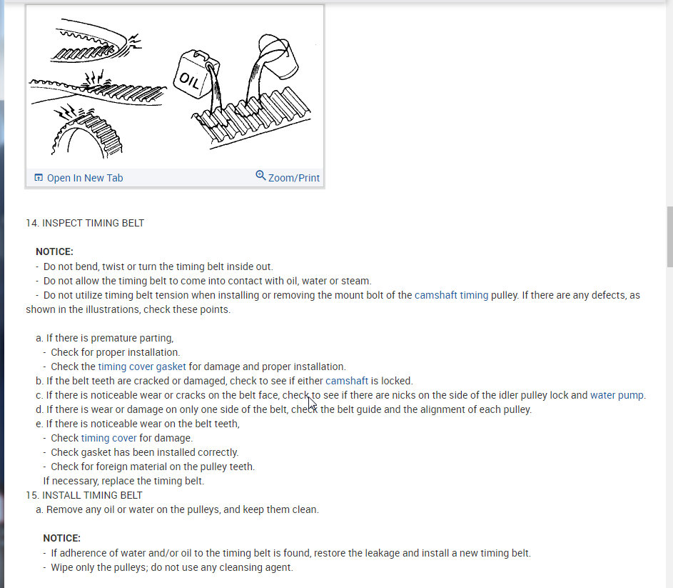

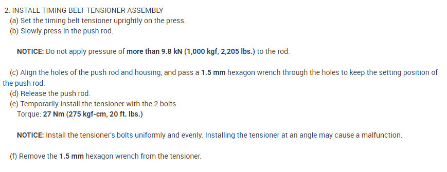

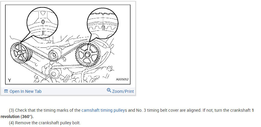

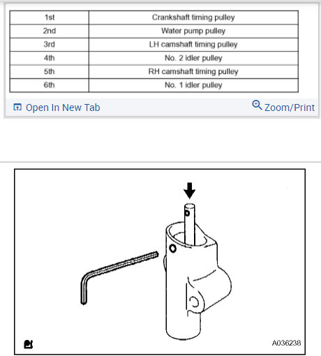

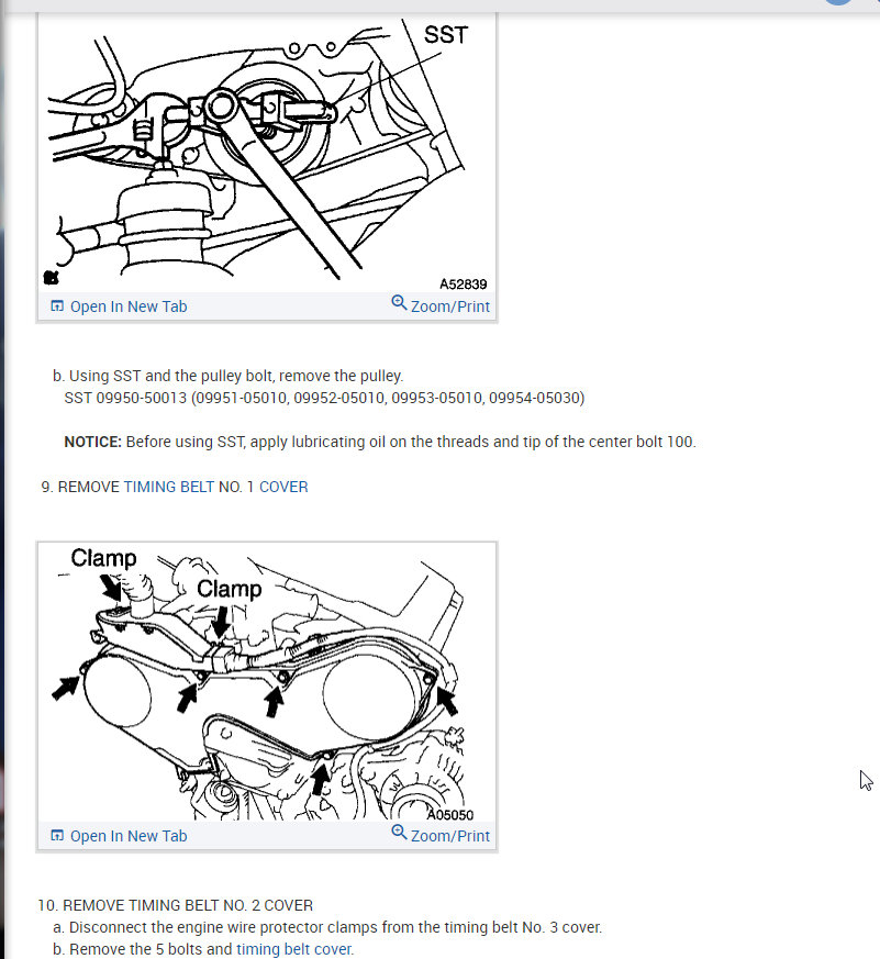

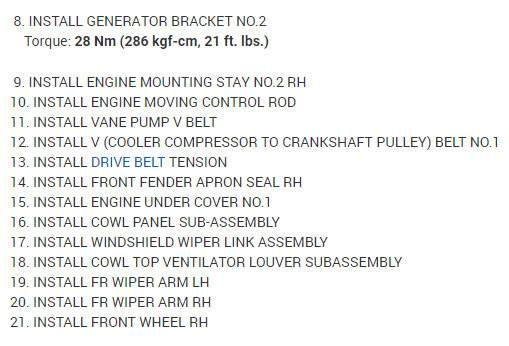

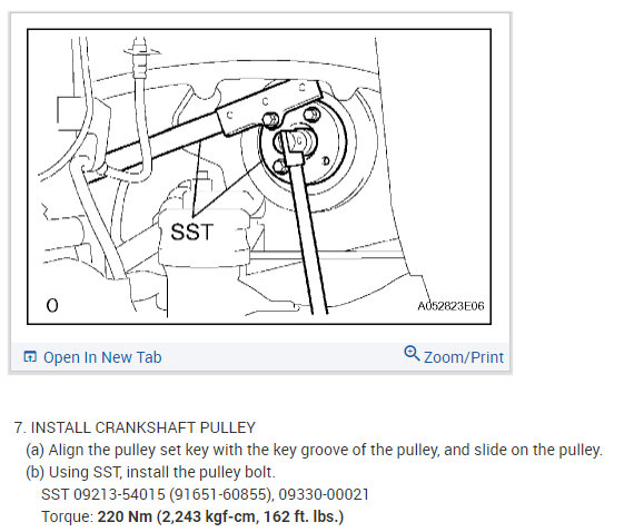

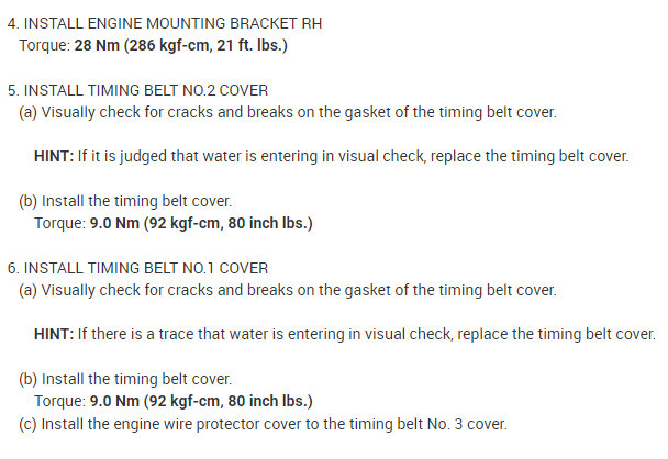

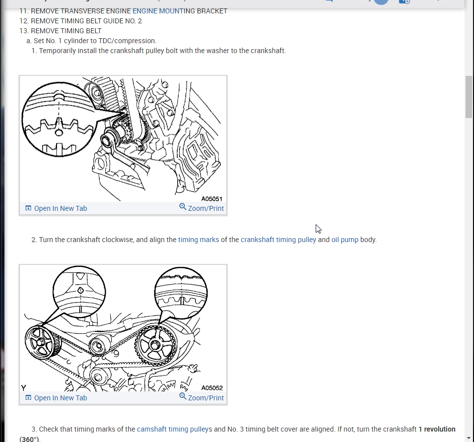

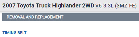

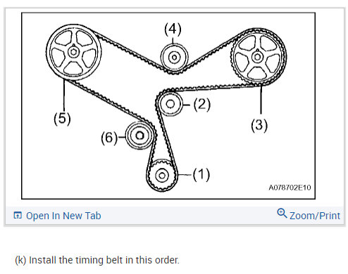

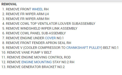

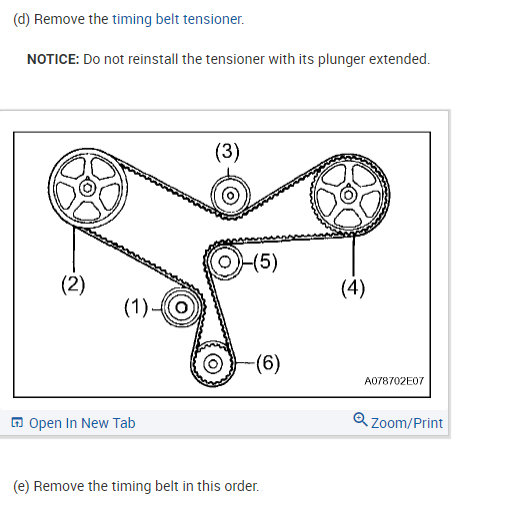

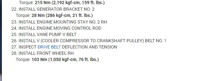

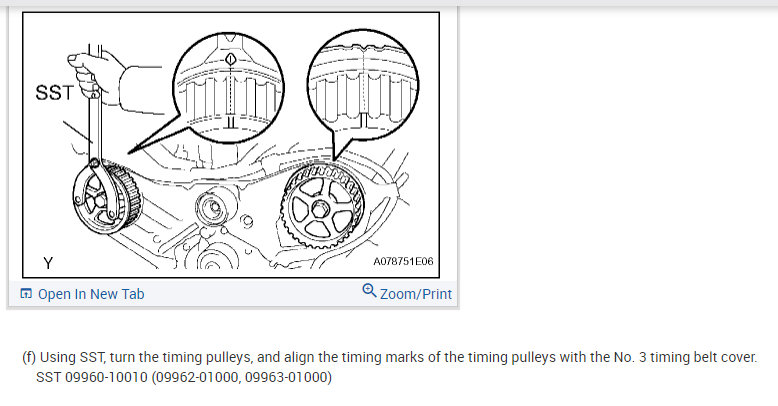

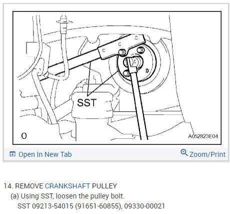

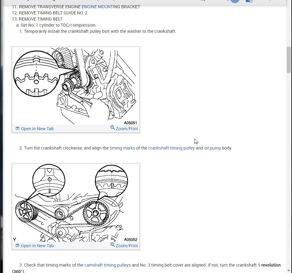

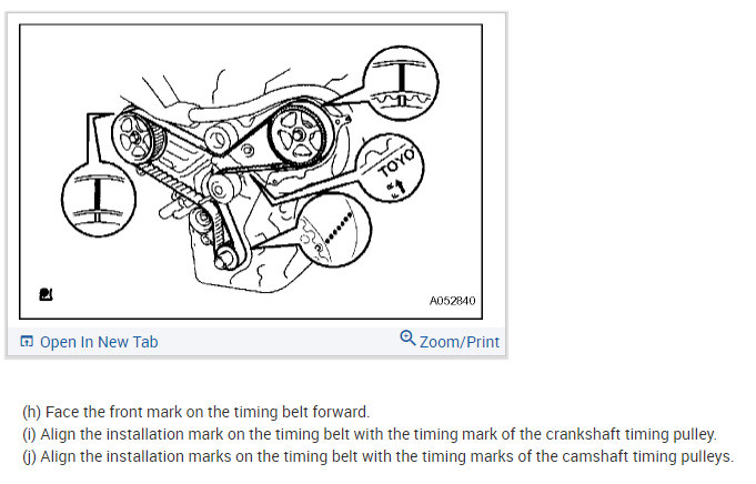

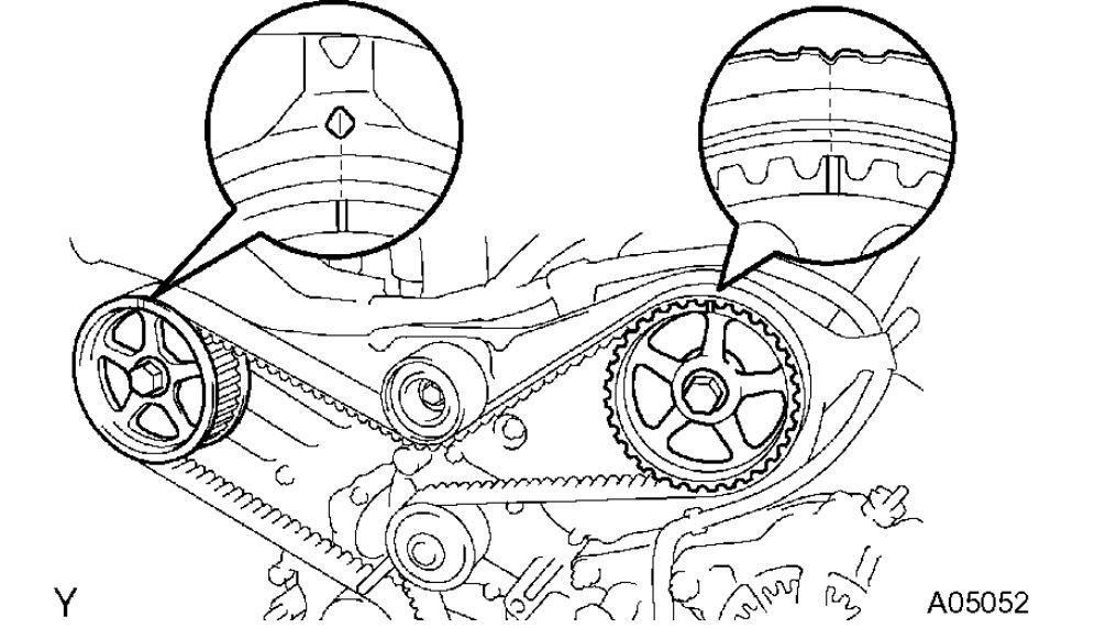

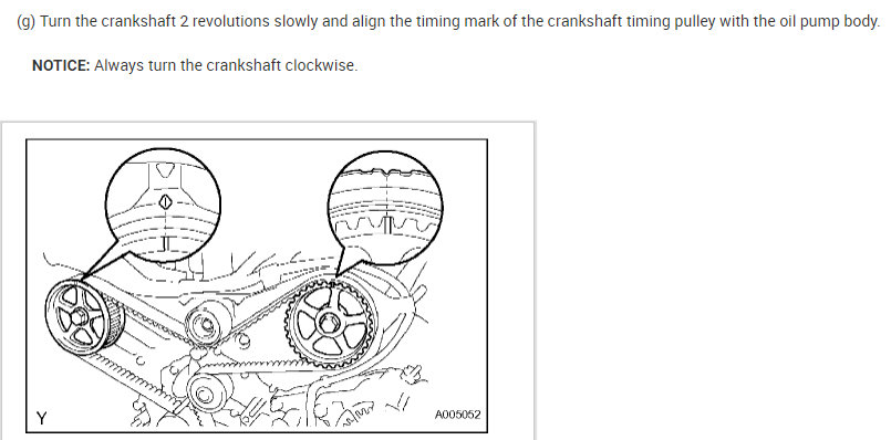

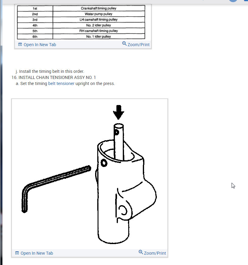

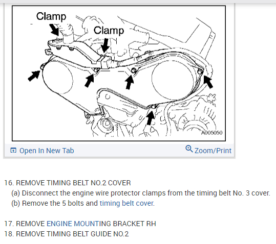

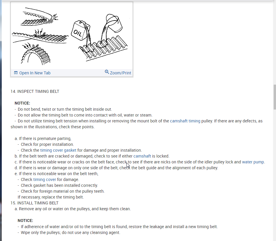

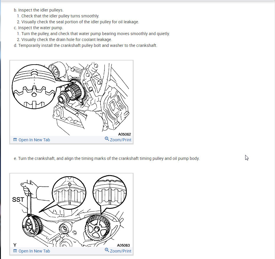

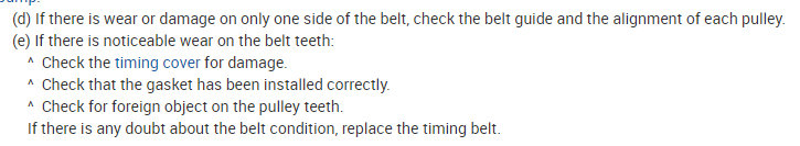

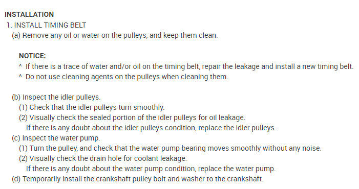

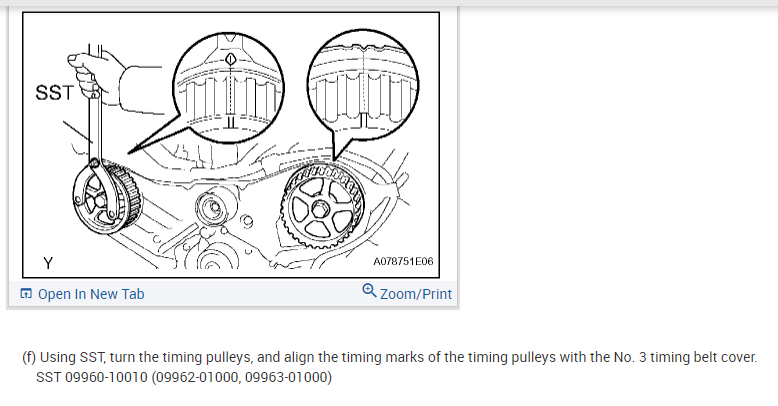

I've attached picture steps below for the procedure to replace the timing belt on your vehicle. Hope this helps and thanks for using 2CarPros.

I changed timing belt/water pump. I did not remove the cam sprockets for this job. Last belt/pump change at 112,000 (by dealer, pre-purchase).
Prior to starting, there was a substantial noise coming from the vicinity of the water pump and accessories, and I could not diagnose the source of the noise. Due to the mileage, I decided to do the belt/pump change and figured I'd come across the source of the noise in the course of the job.
After removing the accessory belts, I started the engine as a check to see if the noise was still present, to check if it was an accessory. The noise was still present.
After removing the pulley's and tensioner and water pump, none of them appear to have failed enough to make the noise reported above, but who knows, at high speed one of them could have been the culprit.
After belt install, I rotated crank by hand 2 times to check for interference. Tried with starter, no start. I did not keep trying.
When I re-inspected crank and cam timing marks again, I discovered that the rear cam had moved counter-clockwise (relative to facing the engine) from when I took the old belt off, so the belt was initially installed out of time. To be more specific, the crank and front cam were in proper alignment, the rear cam was off counter clockwise ~60-80*) I have subsequently learned that that cam was not in a resting "unsprung" position in the aligned TDC state. [Neither of the two video tutorials I consulted mentioned this, but I have since watched others that warned about it]
I disassembled, re-set the tensioner, then re-installed the belt with both cam sprockets in proper alignment with the crankshaft. Again, I turned crank times by hand. Then I tried to start the car, and still no start.

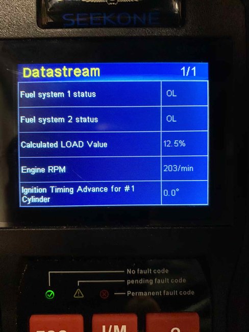

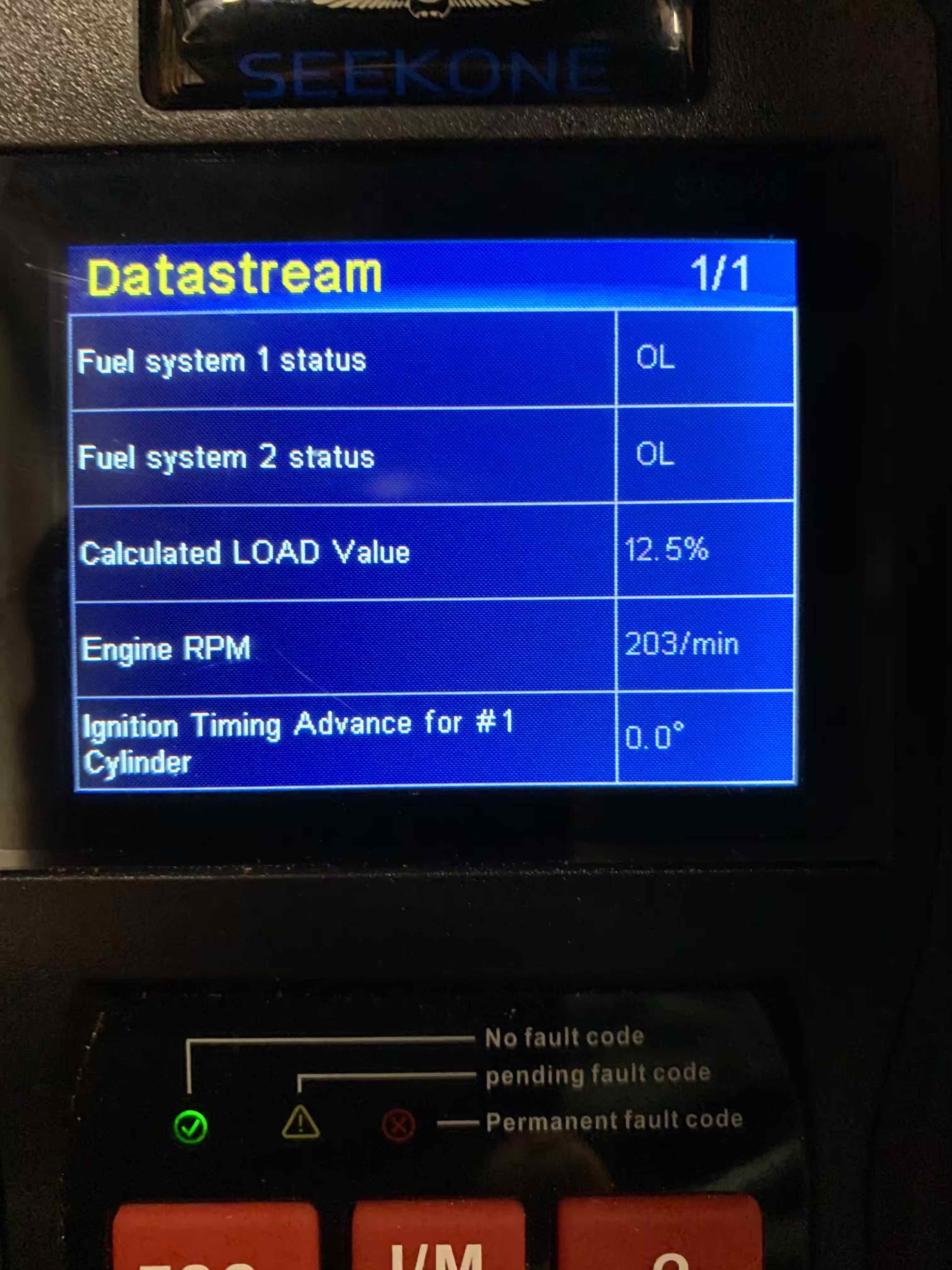

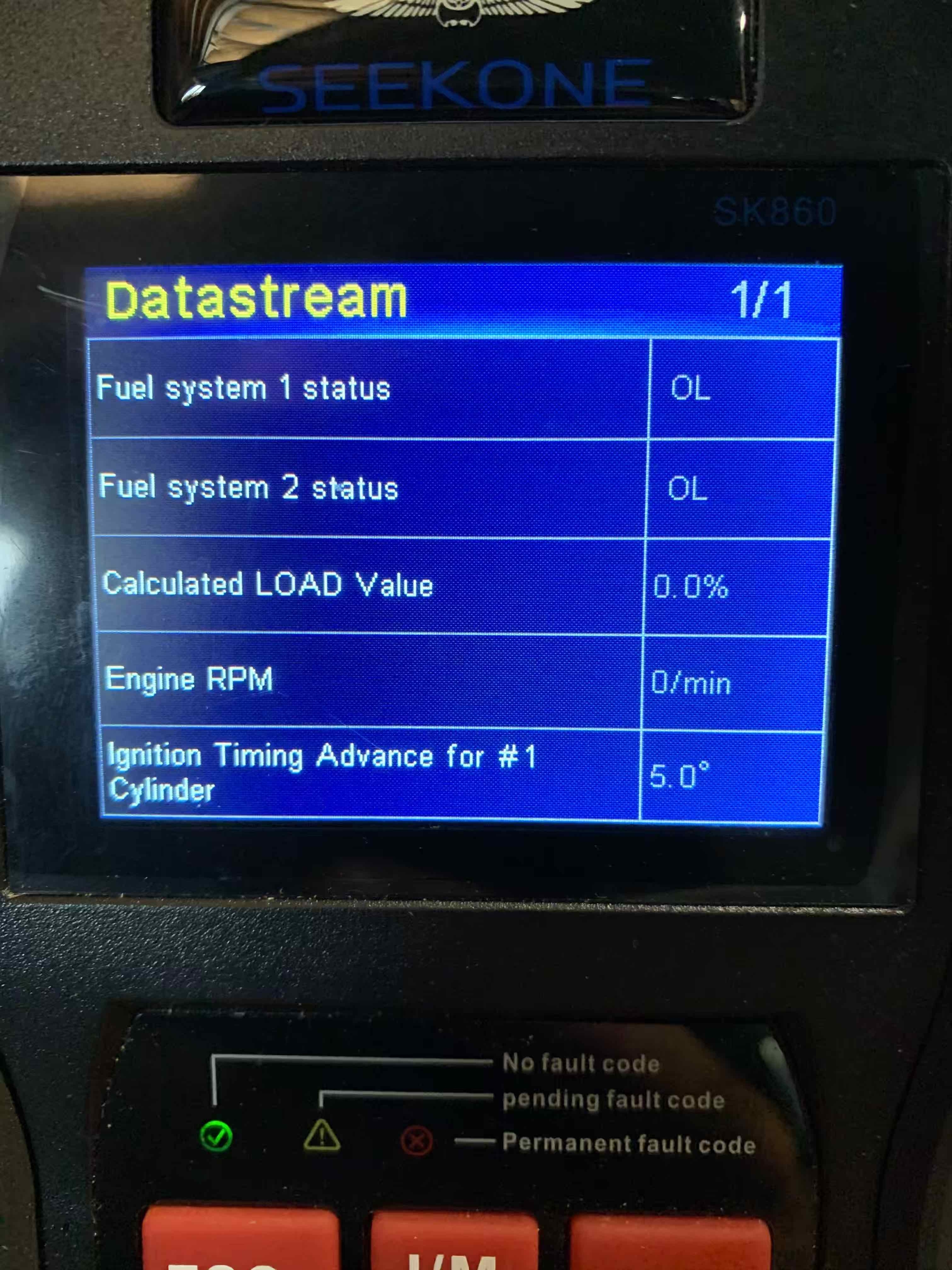

Ah ha. I've never used it to scan live data, but turns out it does, and I can select which parameters.
I don't know what the advance numbers should be, but it looks like the fuel system has OL. I was thinking that was no power, but just read that it means open loop. Inconclusive to me.
What do you think?
Feb 6, 2021 at 9:52 AM (Merged)
The first picture, there was no RPM reading. Was that taken while cranking?

Sorry about that... first picture was with key at ignition, second pic was while cranking the starter.

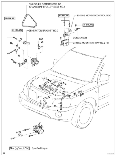

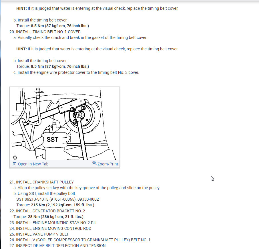

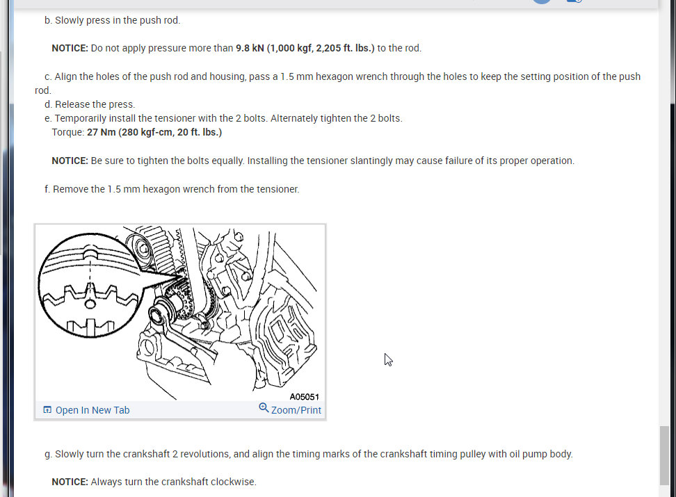

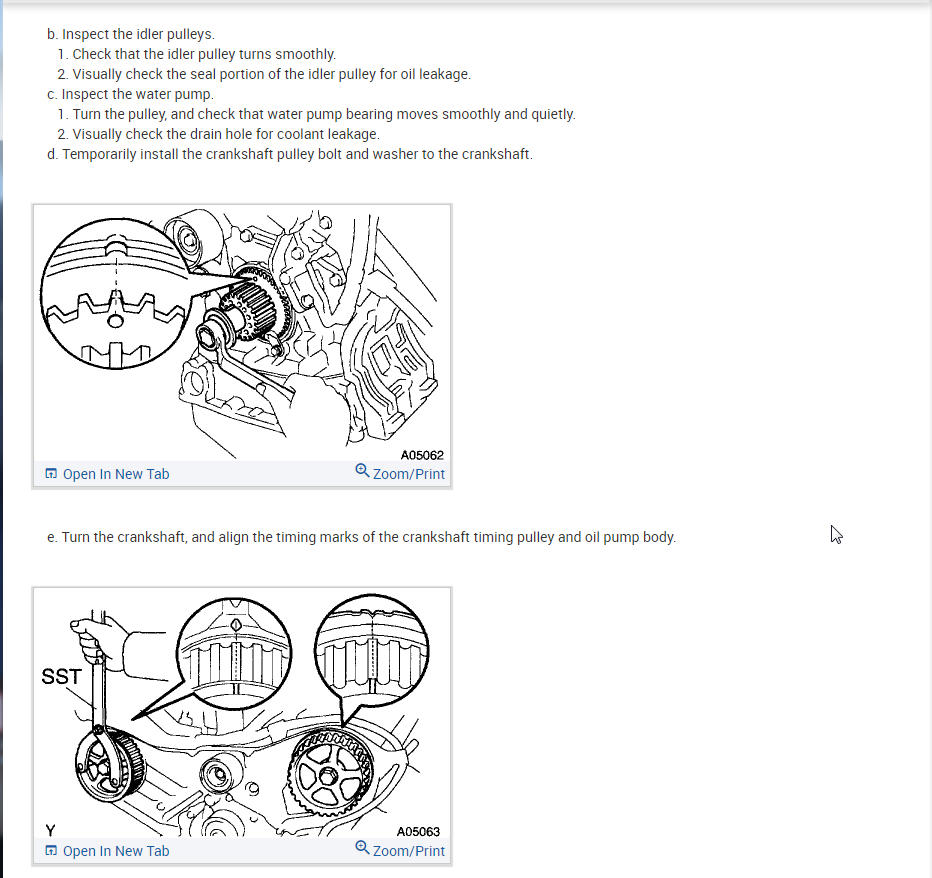

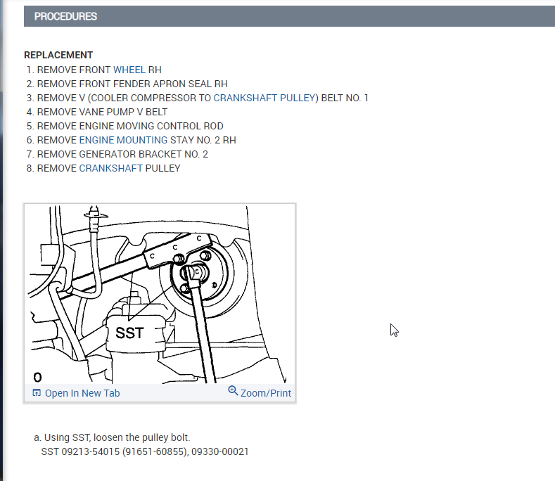

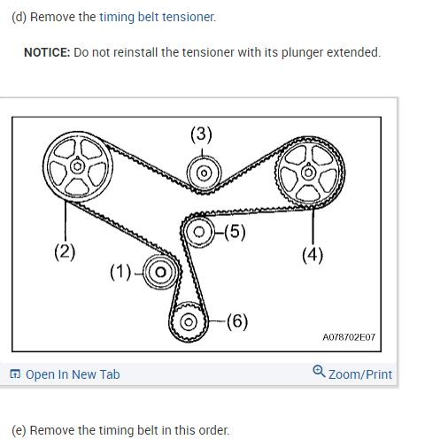

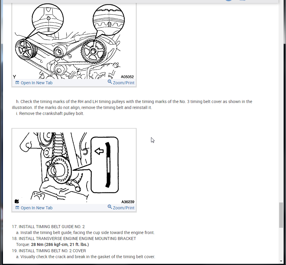

I am attaching the process below on how to replace this. Please let us know if you need more info. Thanks

Okay, the crank sensor is sending a signal to the ECM.
Do you hear the fuel pump run?

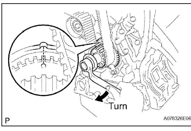

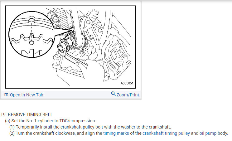

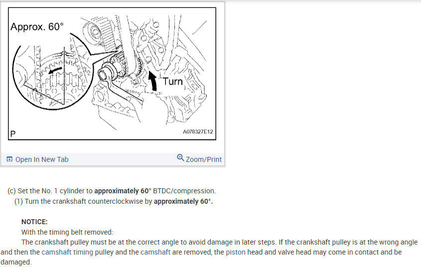

DAVE144
2001 Toyota Highlander, V6 3Liter, I am changing the timing belt & water pump as part of a major service. Following the manuals instructions step by step I removed everything in the way and had access to the belt.

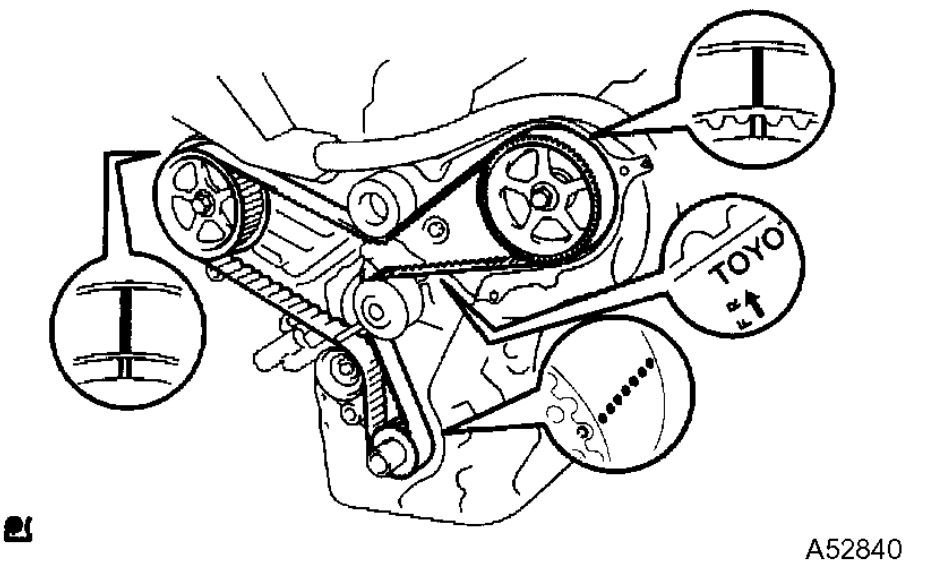

The crank shaft mark was on “O”, both cam shaft marks were lined up with the marks on the their heads.
The instructions then said to rotate the crankshaft counter clockwise 60 degrees, then release the tensioner pulley, and remove the belt in a set sequence.
When I removed the belt from the cam shaft on the front of the motor, it spun about 30 degrees.
First instinct was to put all parts in box, have car taken to garage – let them
fix it !
I have done 5 or 6 timing belts before, but never had anything move when I removed the timing belt before.
Still willing to try and do this myself if I can do so without ruining motor.
If I go ahead and install the new water pump, without disturbing any of the shafts, then move each shaft back to its timing mark, install the new belt, then rotate the motor numerous times – as long as each time the crankshaft mark is on “O”, both cam shafts line up with their marks, then:
1. best case, all is well, car will run as designed.
2. “worst” case, car will not run – BUT neither of the heads will be smashing valves on pistons because the marks mean that at TDC the valve will always be in an ok position relevant to their pistons.
I appreciate any advice to get me successfully out of this situation !
Feb 6, 2021 at 9:53 AM (Merged)
MHPAUTOS
  • 31,937 POSTS
Hi there,
Yes this is scary when it happens, what has happened is that one of the cams have be up against valve spring tension and when the belt tension has been released the cam has kicked back, you can safely re position this cam back to its timing mark, you may need an extra pair of hands to hold the cam still while you set up the belt and tensioner, what i do is i use a small section of the old belt and use this as a cushion to protect the new belt, set the cams up and softly clamp the belt with either heavy bulldog clips or very light pressure with small vice grips, just to hold the cams in place, try this....Mark

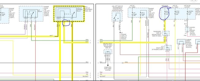

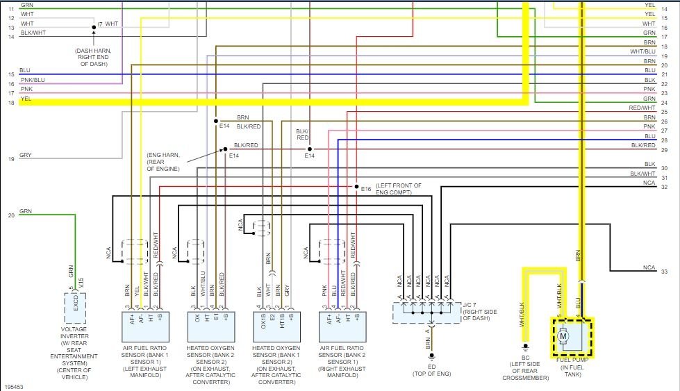

There will be the voltage at the pump for 2 seconds with the key in the on position. Full voltage when you are cranking.
Did you check it that way?
Did you spray starter fluid in the air filter and see if it starts and stalls?

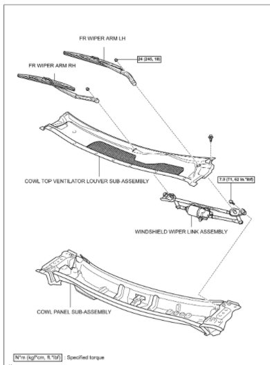

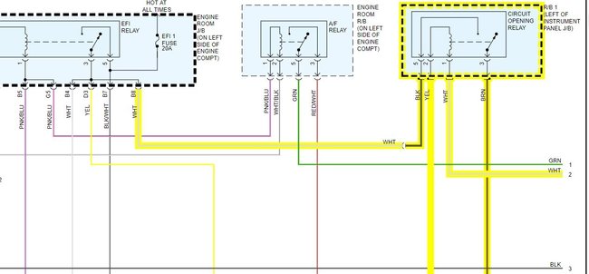

I attached a diagram and the fuel relay for you to view. It is under the dash. We need to do some testing. The brown wire at the pump needs to have voltage.

Great to have the diagrams.

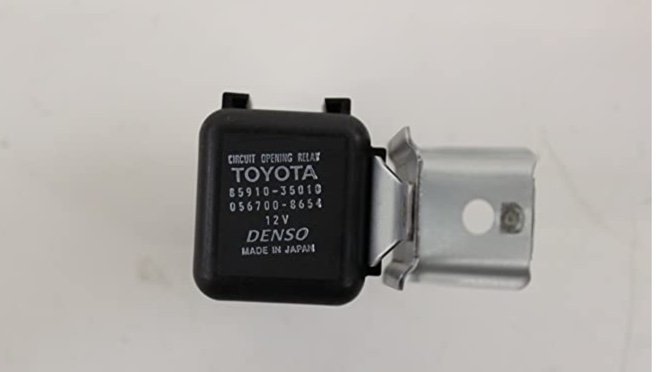

I located the circuit open relay. First tried just replacing with a replacement relay, and this did nothing.Confirmed continuity form bottom relay socket to brown wire at pump there are 12v at two of the relay sockets (one parallel to the brown wire socket, one perpendicular).The other socket gets 9v when key is turned (not going off after delay) and during starter crank.The starter fluid did not have any effect. Maybe it didn't get past he throttle body, it's quite a long way. I did already verify spark at the front plug.
Do you have power on the white wire with the key on?
That is the supply power for the load side or the fuel pump when the relay closes.

No voltage to either brown or white/black, ever.
9V on pink, which is not in the diagram.
I don't understand the blue. Wiring diagram shows brown becoming blue??

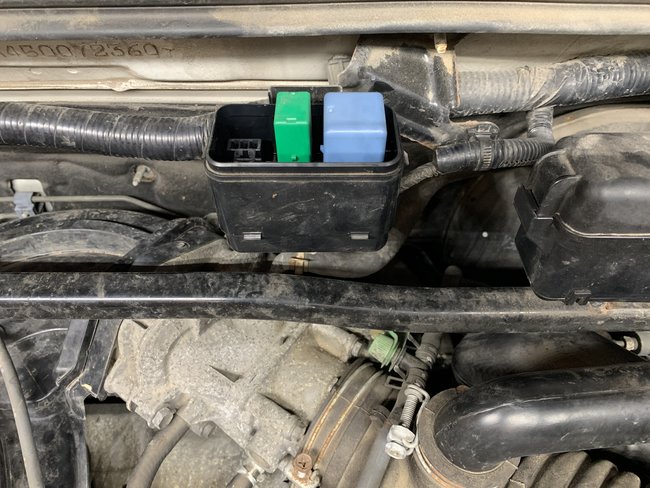

Toyota parts department told me the relay is in the engine bay. I'm going to look now to see if I can find it.

Okay, brown goes to the pump itself.
The black wire, which change from white is the power from the EFI relay.
That is the power for the circuit relay.
No, the relay is where I posted it and it is marked. It is inside the car.

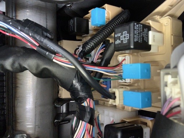

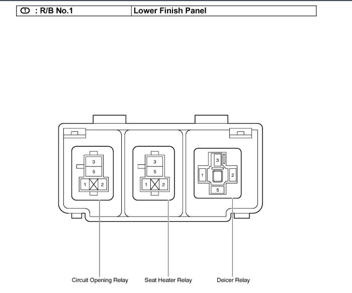

I just noticed that a seat heater relay is identified in the third diagram, but this Highlander has no heated seats.
Do you think the pic I uploaded with 3 relays corresponds to your third diagram?
I’m thinking the open circuit relay is quite a bit bigger than the little blue ones.
The upper part of the picture you posted showed a blue relay. Is there other slots next to it?

That seems to be it, as the positions are the same and the seat heat relay is missing.
I was able to pop it out and bring it down where I could get a probe on it.
I’ve got 12v on black and on white, nothing on brown or yellow with key on or starter engaged.

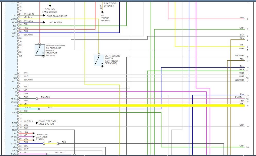

If I’m reading this right, voltage on yellow will cause the relay to connect black to brown.
Can you find out where yellow is coming from?
That goes to the ECM. It grounds a signal to the control side of the relay. When it does, it closes the relay and sends power to the pump.
I attached the picture and there is a fuse that controls power to the relay. Test that fuse for power on both sides.
