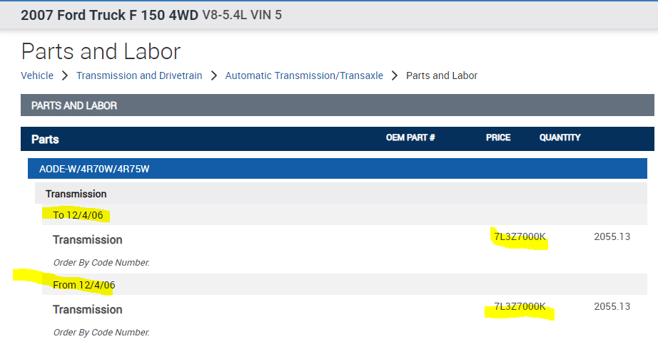

So, I have the 4 speed 4R75E, so what years would I be able to use?
Jan 14, 2024 at 2:50 AM
  • 110,244 POSTS
Is the truck a 2wd or 4wd? I will try to cross-reference a few years. That is the only way I can check. My concern is one year may work, but the manufacturer may have changed the part number.
Jan 14, 2024 at 12:32 PM
GREGGER 83
  • 7 POSTS
4x4.
Jan 14, 2024 at 5:41 PM

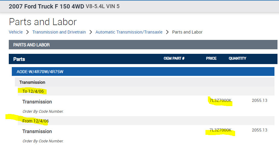

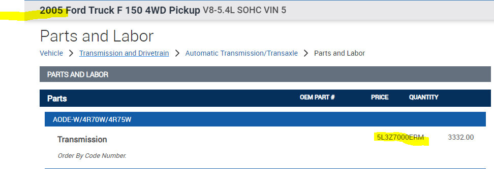

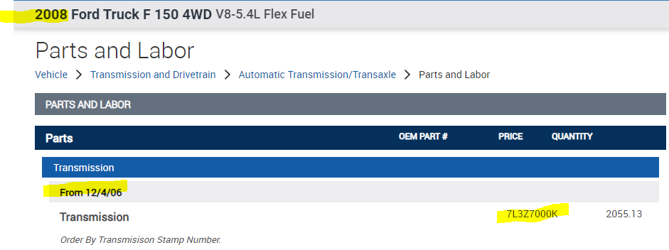

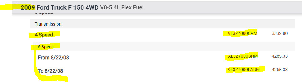

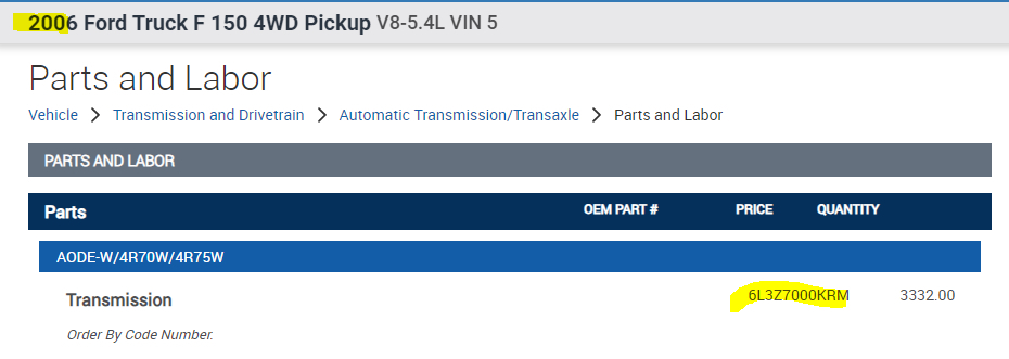

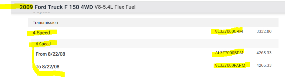

  • 110,244 POSTS
I attached the OEM part numbers from 2006 to 2009. The only year that offers the same part number is 2008.
Based on that information, which is the only likely match. Take a look and you'll see what I mean.
