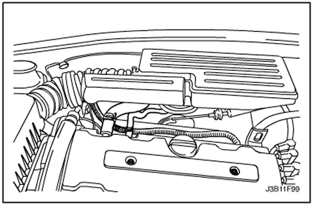

I have put on a new throttle body and now my car will not start. help please

First, confirm that everything was reinstalled correctly. Here are the directions specific to your vehicle for replacement. Read through them to make sure you didn't miss anything. The attached pictures correlate with the directions.

1. Disconnect the negative battery cable.
2. Disconnect the intake air temperature (IAT) sensor connector.
3. Disconnect the breather hose from the valve cover.
Picture 1
4. Remove the air intake tube.

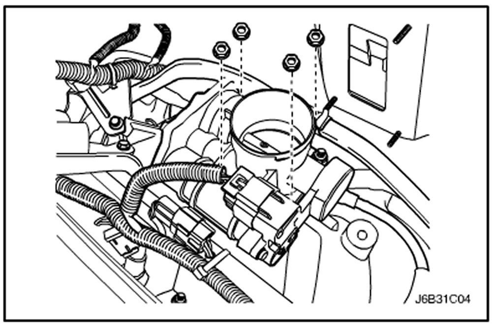

5. Disconnect the vacuum hoses from the throttle body.
6. Disconnect the Electric Throttle Control (ETC) connectors.
7. Disconnect the coolant hoses from the throttle body.
Picture 2
8. Remove the throttle body retaining nuts.
