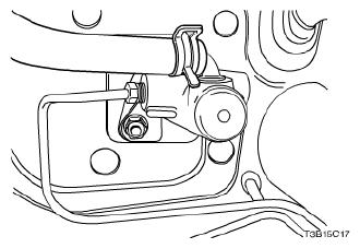

please help my car wont shift while crunk up but will when not running. i think it may be the clutch disc is not releasing fully but i am not sure. any information would be helpful. thankful.

CHECK YOUR CLUTCH MASTER CYLINDER'S FLUID LEVEL
IF IT'S LOW, REFILL/ BLEED, LOOK FOR LEAKS
SOMETIMES A BRAKE MASTER CYLINDER/ CLUTCH MASTER CYLINDER WILL LEAK "INTERNALLY". THIS MEANS THE PISTON/ O-RINGS IS NOT SEALING OFF WHEN YOU PUSH THE PEDAL. FLUID SLIPS BY THE PISTON (AS IT SHOULD NOT!) AND THE CLUTCH PRESSURE PLATE MAY NOT LIFT FULLY OR AT ALL. THERE IS NO FLUID LOSS, AS THERE WAS NO "HOLE" FOR IT TO LEAVE THE BODY

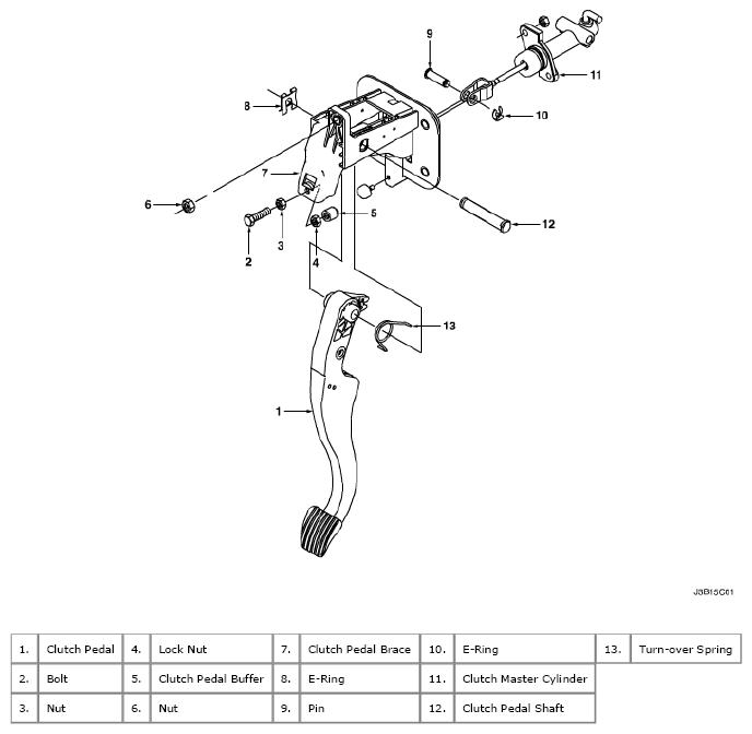

thank you for the info could you tell me the location of the fluid? i dont know anything about Suzukis

FOUND TWO PICS IN "MITCHELL I"
FOLLOW THE HOSE TO THE RESERVOIR
