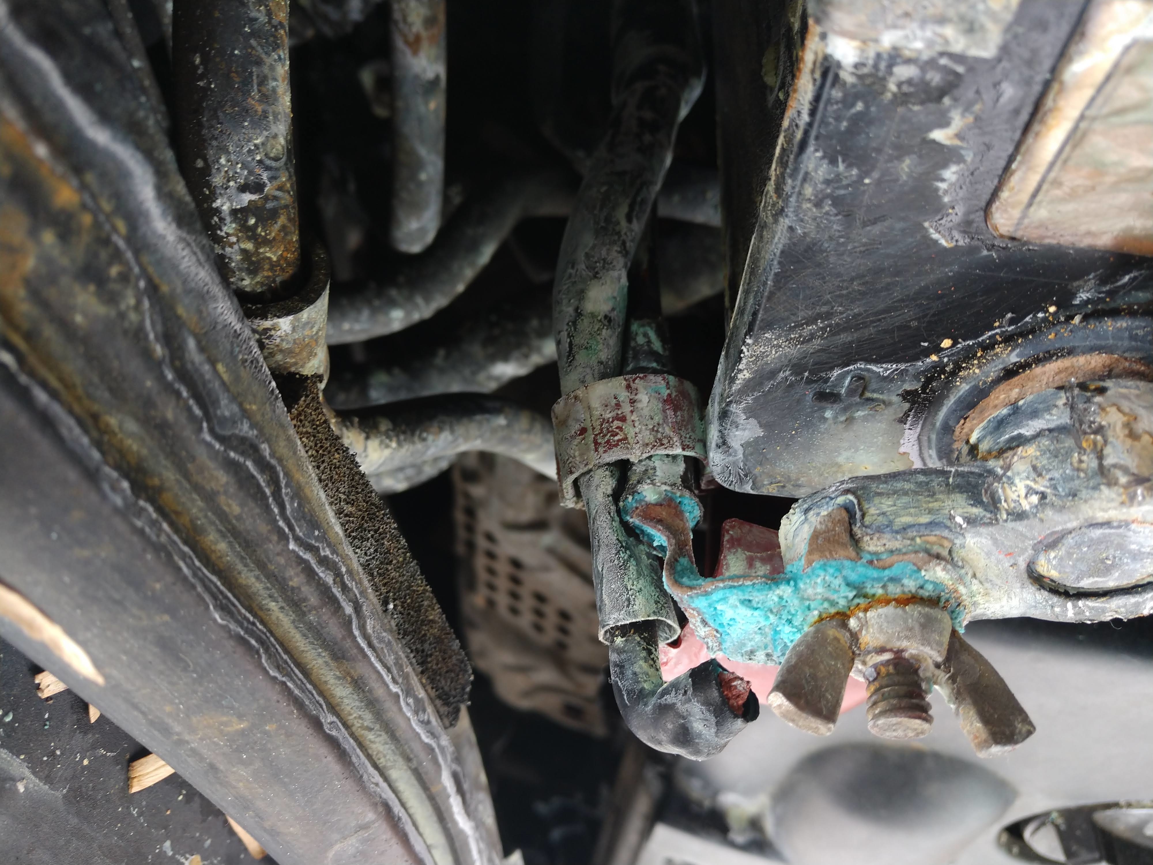

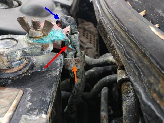

The battery was dead and I went to jump start it and there was a ton of corrosion on the positive terminal. I cleaned it all off, went to jump it and nothing. Would not charge, would not start. After taking a closer look I see a cable just floating in space and not connected to anything. I honestly do not remember if it was ever connected. Does this look like something that is supposed to be connected? Or does it look like excess cable from a previous battery replacement? I received this car in 2015 and it was used and seemed to be like it was an auction buy from the dealer. Any help and suggestions on what I need to do would be greatly appreciated. Attached below is the battery/cable.
Dec 2, 2018 at 6:30 AM
Good evening,
Not stupid at all.
That green stuff is the cause. You need to replace that cable as all that corrosion is preventing any voltage from flowing.
Replace the cable from the battery down with a new cable. You can get them at a parts store. You will need to measure the length of the cable to be sure you have enough cable to run it the same way it is run right there.
Dec 2, 2018 at 7:57 AM
CARADIODOC
  • 34,414 POSTS
It sounds like there are multiple issues, but it all started with nothing more than a defective battery. The clue is your dandy observation of the excessive corrosion. As all batteries age, the lead slowly flakes off the plates. Battery manufacturers know that is going to happen, and how quickly. They provide the longest warranties they think they can get away with which is typically five years.
As more and more of that lead flakes off the plates, the electrical size of the battery becomes smaller and smaller. It will still crank most engines just fine, but not for as long, if necessary, as when it was new. The bigger concern is when that battery recharges once the engine is running. The amount of charging current going through the battery is determined, in part, by the charging voltage, and that is designed in to match the needs of the entire electrical system. The battery will charge at the intended rate, but with much of the lead flaked off the plates, that current gets packed into a smaller area, and that causes the plates to heat up more than normal.

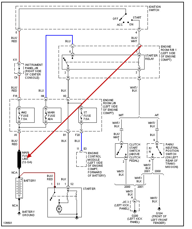

I have a 1994 Toyota celica 1.8L DOHC. I hooked the battery up backwards and tried to start the car. Its now on right but will not start or shift out of park. Also, the brake/tail lights and dash lights will not work. Power locks and windows will not work
Dec 30, 2020 at 9:35 AM (Merged)
SATURNTECH9
  • 30,869 POSTS
Did you check all the fuses?Also please finsh your details on the problem your having.
SAHOLBERT
  • 17 POSTS
Yes. I mentioned in the question that the fuses and relays are all good. Also that the starter and battery are good. I can jump the car by running a hot wire from the starter to the battery and it will run. I believe all of the details are included in the question. Thnak you
SAHOLBERT
  • 17 POSTS
I can not figure out how to edit the question and apparently all of the info i entered did not show up. Let me clarify. I have checked the battery, starter, fuses and relays. I have checked the fusible link running from the battery. The car will do nothing (no sound) when you turn the key. The brake/tail lights and dash lights and pwr windows and locks will not work. Headlights and interiors do work. The car will not shift out of park. Sorry the details did not show up.
SATURNTECH9
  • 30,869 POSTS
How did you make sure the fuses were good?By making sure there was power to both sides of the fuses thats the proper way to check them.Lets start with making sure you have power to both sides of the 60 amp main fuse in the underhood fuse on the left side of the engine comparment.
SAHOLBERT
  • 17 POSTS
I will replace it just to be sure. Thank you.
SATURNTECH9
  • 30,869 POSTS
The reason i say to check for power on both sides of fuse is one to see if the fuse and two to make sure there is power going to the fuse.There is a fuseable link that feeds that fuse so i want to make sure the fuse is getting power.You have a multimeter correct?Let me know what you find.
SAHOLBERT
  • 17 POSTS
Ok.. Upon further inspection, I figured out that my 100amp fusible link was blown. I replaced it and everything is working again, but the car will still not start. After replacing the fuse, the cars security system was acting weird. I dont know if its pertinent but it never has before. I thought the security system was disabled or didnt work. There were lights flashing in the rear similar to hazards and there was a light blinking by the steering wheel. I unhooked it because its the only way that the lights would go off.
SATURNTECH9
  • 30,869 POSTS
Is this a factory or aftermarket security system?Does it crank and no start or no crank no start?
SAHOLBERT
  • 17 POSTS
I believe it is factory, but i am not sure to be honest with you. It must have had problems in the past because the wires under the hood have been unhooked since i bought the car a few months ago. It does nothing at all when I try to start it. No crank, no start. We did have the car running earlier in this process by jumping the starter. I am getting nothing at all when turning the key though.
SATURNTECH9
  • 30,869 POSTS
I dont see a factory security system on that car.Do you have a multimeter to do some testing?
SAHOLBERT
  • 17 POSTS
No, but I can pick up one if necessary. I have been using a test light.
SATURNTECH9
  • 30,869 POSTS
You can use the test light for now with the key in the start position the red and black wire coming off the ignition switch should have power.Also key in the start position you should have power to the black wire to the starter solenoid on the starter.Also do you have a automatic or stick shift car?
SAHOLBERT
  • 17 POSTS
There is no power coming from the ignition switch. I unplugged the connector on back of the switch and tested the contacts on them in the start position. The light would not come on. There is power going to the starter solenoid. Is the ignition switch bad? I have an automatic. Sorry about the delayed reply i have been busy.
SATURNTECH9
  • 30,869 POSTS
With the ignition switch plugged in do you have power to the black wire with a red tracer?Also with the key in the start position do you have power to the black wire with a white tracer?Let me know and we will go from there.
SAHOLBERT
  • 17 POSTS
I have already taken off the ignition switch. After reading various ways to check it, I figured it was bad. I can put it back on if you would like unless there is a way to check with it off.
SATURNTECH9
  • 30,869 POSTS
Its easier to check with it on please let me know what you find.
SAHOLBERT
  • 17 POSTS
Ok. There is power to both of the wires.
SATURNTECH9
  • 30,869 POSTS
Then that means the switch is working.You said you had power to the starter but is it to the smaller black wire hooked to the starter solenoid with the key in the start position?
SAHOLBERT
  • 17 POSTS
Just checked again. The smaller black wire is very hard to get to. I have been probing the wires with my test light. I did get into it and i am not getting power
SATURNTECH9
  • 30,869 POSTS
Ok with the key in the start position see if you have power to both sides of the ST fuse its a 7.5amp in the instrument panel junction box in the left kick panel.Also do you have a manual transmission or automatic?
