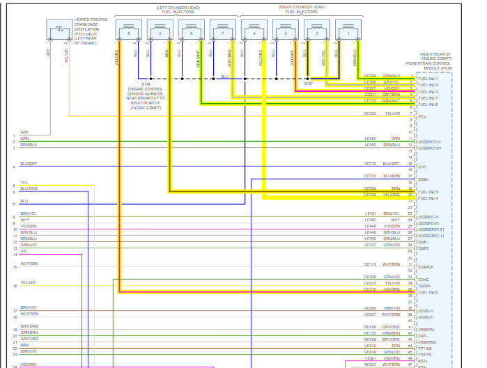

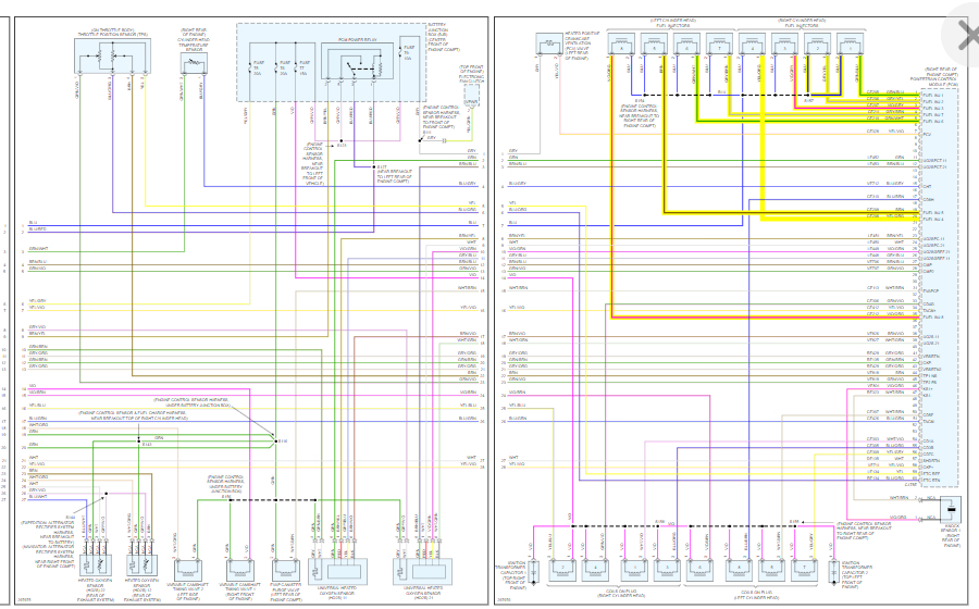

I attached a wiring diagram for you to view. I would disconnect the PCM and check the voltage of the wire from the effected injector at the PCM connector.
If it is 12 volts, then you have a bad PCM. If you have any other reading, it is either the wiring or the injector.

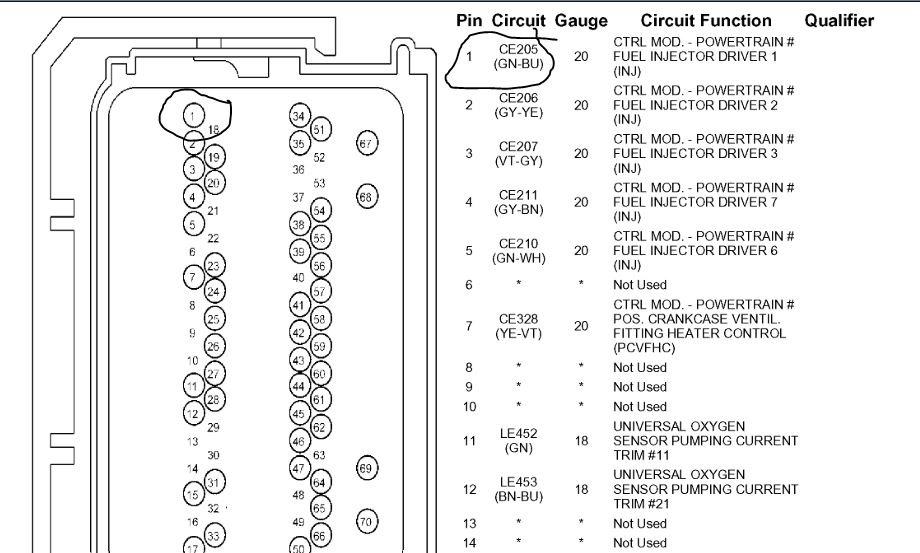

The diagram I sent you has the wire marked for the number 1 injector. It is pin 1 on the PCM connector as marked.
Disconnect the PCM connector and measure the voltage at pin 1. If it is 12 volts, the wiring is good. If it is not then either the injector or the wiring is the issue.

There are 3 PCM connectors there, which one is it? And in which corner is the pin #1? Thank you.
Sep 28, 2019 at 4:35 PM
The connectors should have pin numbers on it.
It is a black connector. I attached a picture of the connector and the wire color for pin 1.
Sep 28, 2019 at 4:43 PM

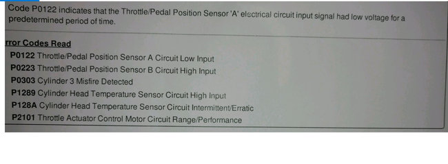

I pull the error codes. File is attached Looks like cylinder 3 is the cause of the problems.
Sep 28, 2019 at 8:26 PM
Okay, so now it is number 3?
As far as number 1, if that is what is causing the excessive fuel, the PCM is bad.
As far as number 3, you need to check the plugs, coil, wiring as you are doing for number 1 and lastly the compression.
Sep 29, 2019 at 4:28 AM

I pull the codes for the first time and it showed the above number 3 problem. I replaced the spark plug and coil assembly on number 3 with new ones. Started an engine, it sounds normal, for a 30 seconds or so it looked like the smoke was clearing up and then it started to smoke up heavy again. Anyway, I cleared the above codes, idle an engine for couple of minutes and tried to get codes again. And none are reported while thick white smoke is pouring.
