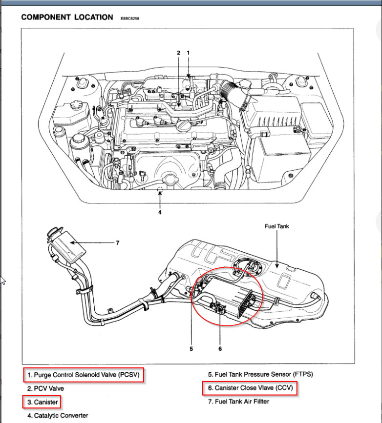

Thank you, I did replace the purge valve. And also fuel pump. Is there any other reason there could be for this problem?
Monday, October 26th, 2020 AT 11:06 AM (Merged)
Yeah. It is the charcoal canister that I mentioned. More than likely that has raw fuel in it. If that is the case then every time the purge valve opens it is allowing too much vapor in.
When you fill the tank now it is forcing even more vapor in the canister and it can't hold anymore so it is pushed into the engine. I would suggest removing the canister (circled) and shaking it and seeing if you hear fuel in it. Then replace that and the CCV on the side of it.

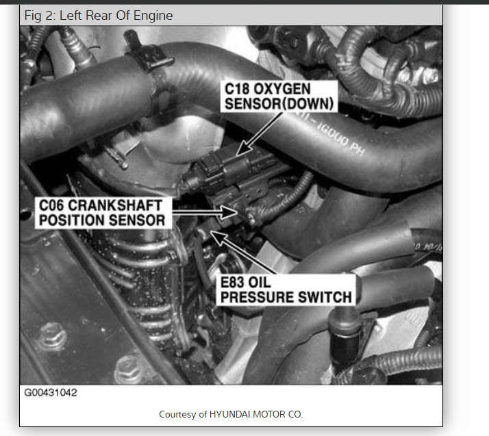

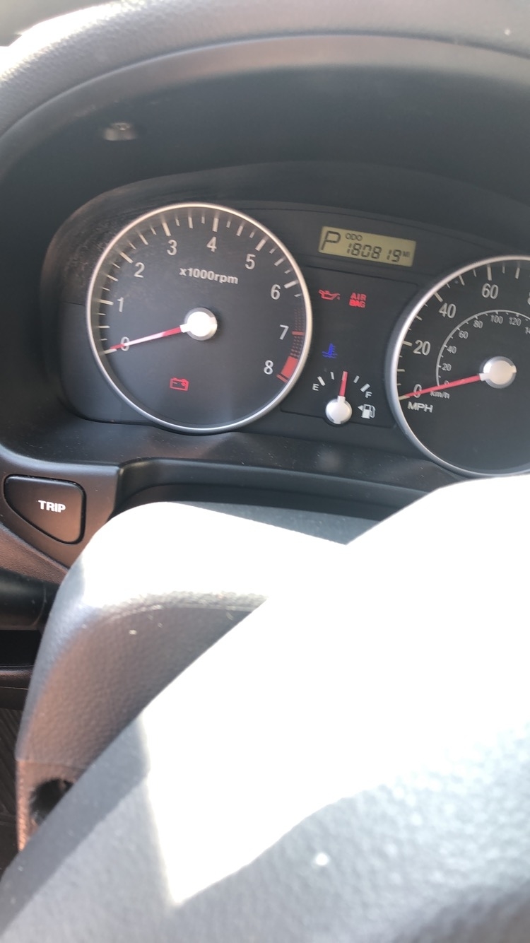

I’ve had my car since March, I bought it from the second owner. Since I bought it it’s given me issues with stalling and flashing check engine, check fuel cap and the oil canister but only when stalling or shutting off. It does it while driving. I’ve done the machine readings many times giving me many causes all I’ve replaced (sensors, fuel filter, ignition switch and 4 coils, belts, spark plugs) I’m not sure what it can be anymore and now when shutting off the oil canister and battery light come on. Any ideas? I’m stumped

Is your Malfunction Indicator Lamp (MIL) or "check engine" light illuminated? If it is can you please pull the Direct Trouble Code(s) for us. You will need a scan tool to do this, and if you are unfamiliar with how to do it, here is a link for you to go to:
Please go through the guide, if needed, and get back to us with what you are able to find out.

The lights are not consistent, when the car stalls the lights come on but once the car is shut off and turned back on it does not show the lights until it stalls again. Which also means we are unable to get a code.

Not all of the warning lights, just the "check engine" light. Is that light illuminated?

No, the oil canister and the battery lights appear on the dash when the car stalls.

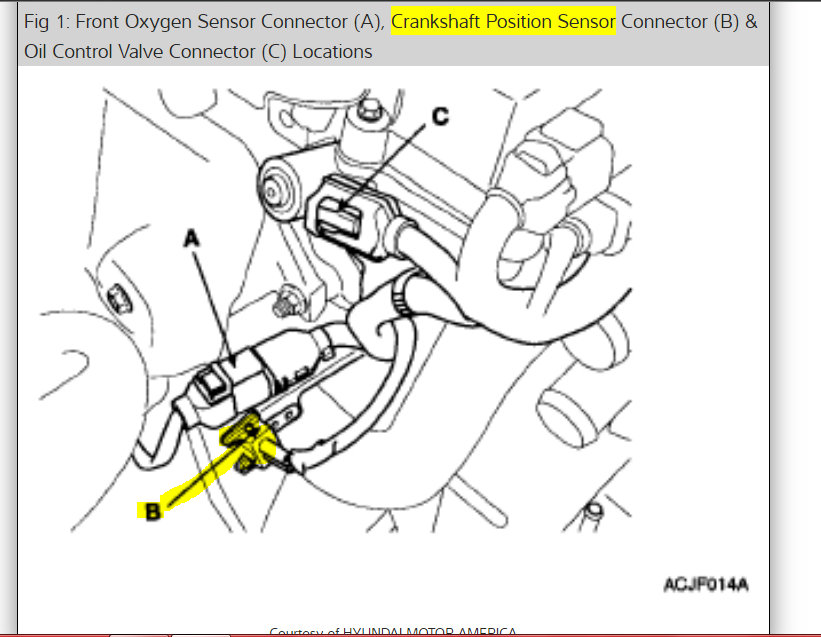

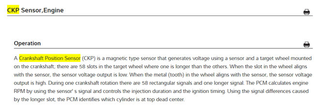

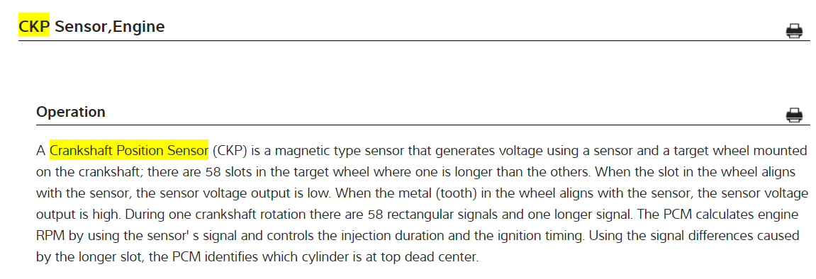

Okay, this could be a problem with your vehicle's Crankshaft Position Sensor (CKP) starting to fail. Your vehicle's Power-train Control Module (PCM) or "computer" uses this signal to determine where the engine is in it's 4 stroke cycle. It the turns on the fuel injectors and makes the spark plug spark accordingly. The sensor when starting to fail, will usually do it when it gets warm. Here are a couple of links below for you to go to:
https://www.2carpros.com/articles/how-a-crank-shaft-angle-sensor-works
In the diagrams down below I have included the description of operation as well as the location of the CKP for your vehicle. Here is a link for you to go to on the removal and installation of the CKP:
Please go through these guides and get back to us with what you are able to find out.
