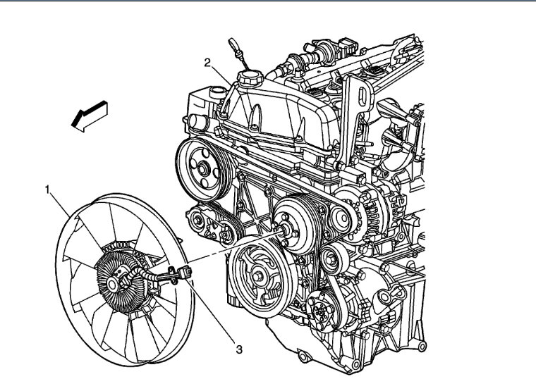

The fan on the motor revs high and makes a pound revving sound sometimes when the vehicle runs for a while, but it seems to only do it when it's hot outside. I get the error code from the check engine light P0 something and it says it could be fan speed sensor.
Sep 18, 2023 at 11:36 AM
  • 110,244 POSTS
The radiator cooling fan on this vehicle does have some electronics. If you have the code you retrieved, let me know what it is so I can research it.
The electro-viscous (EV) fan clutch is controlled by the vehicle PCM based on temperature and need. If the fan recognizes the under-hood temperature is at a specified threshold, the PCM will cause the fan to turn faster. (See fan below)
If you experience the jet-like sound only when it is hot and the vehicle is sitting idle, that really isn't odd. It is expected.
So, I need to know what the code is so I can read through it and make a determination. Also, if the noise slows or stops when the vehicle begins to move, what you are experiencing may be normal.
See pic below.

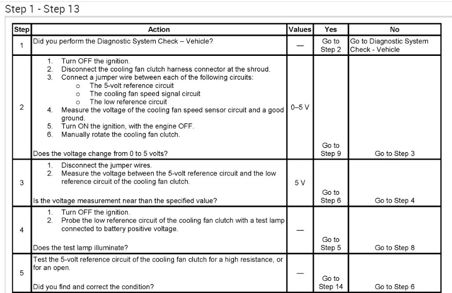

The code is P0526.
Sep 18, 2023 at 2:23 PM
  • 110,244 POSTS

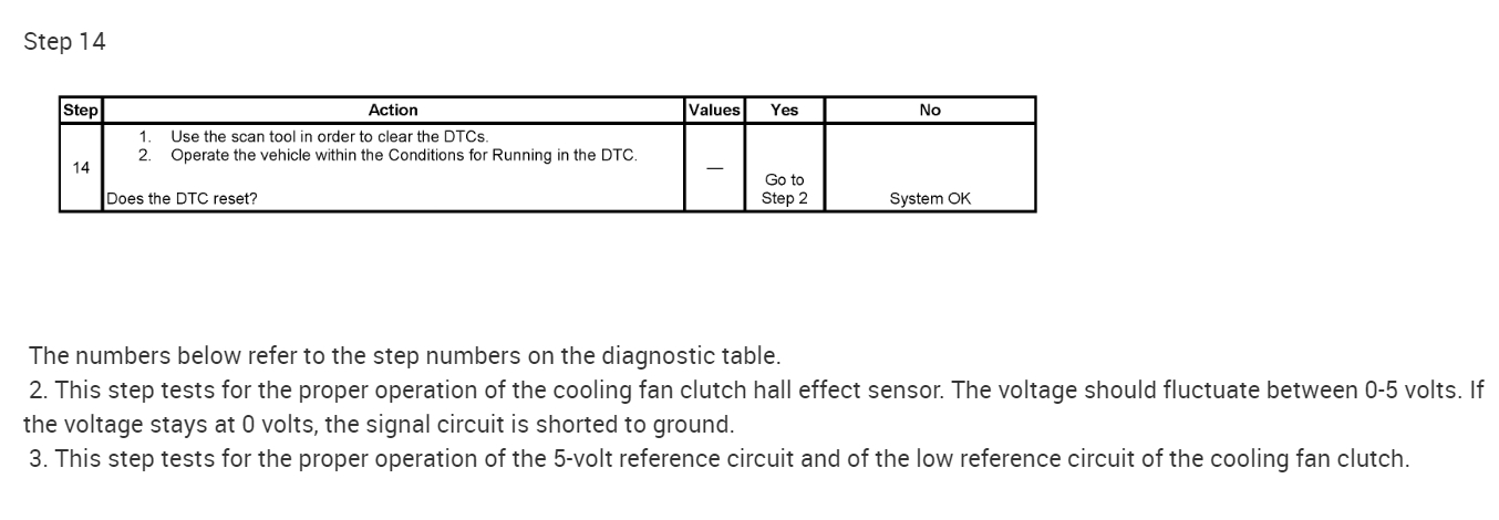

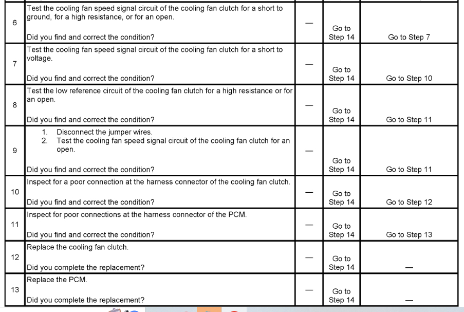

Thanks. The code indicates the powertrain control module loses the fan speed signal for a specific amount of time. It could be the result of the fan clutch, a wiring issue, a connector issue, and so on.
If you look below, I attached the diagnostics for this code. Take a look through them and let me know if you are comfortable performing them
