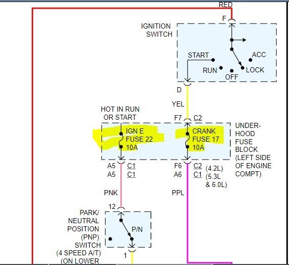

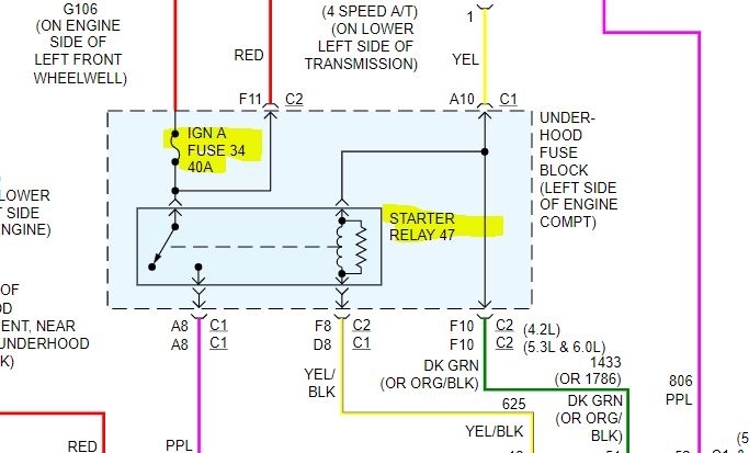

New battery, starter, MAP sensor, ignition switch. lights up dash but will not start.
Oct 28, 2020 at 6:12 AM (Merged)
  • 110,241 POSTS
Does the starter engage and turn the engine? Have you checked fuses as well as the starter relay?
If it does engage and the engine doesn't start, take a look through this link:
If it doesn't crank or engage the starter, take a look through this link that explains how to test a starter. I realize the starter is new, but I need to confirm if power is getting to it.
If the starter does not engage follow the next steps.
I attached two pics below. I need you to confirm the fuses indicated are good and there is power to them. Also, if there is another relay in the box with the same part number, switch it with the starter relay.
Note: I would also like you to confirm that the gear selection light indicates park. Additionally, see if it will start in neutral.
