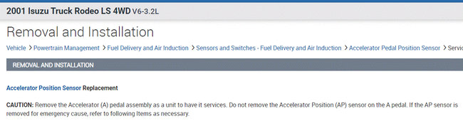

On this vehicle, there is an electronic accelerator pedal position sensor. I suspect it was damaged if you sprayed water in the vehicle (driver's side floor).
If you haven't already, I would scan the computer to see if a code is present related to the APP sensor. Here is a quick video showing how it's done:
https://youtu.be/b2IJGfImVvw
I realize most people don't own one, but oftentimes a parts store will do it free of charge or lend a scan tool to you.

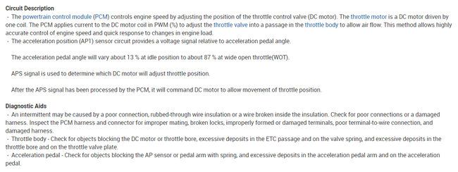

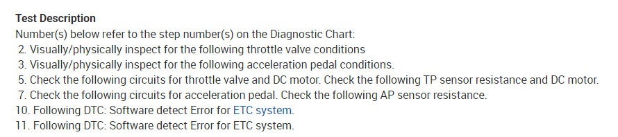

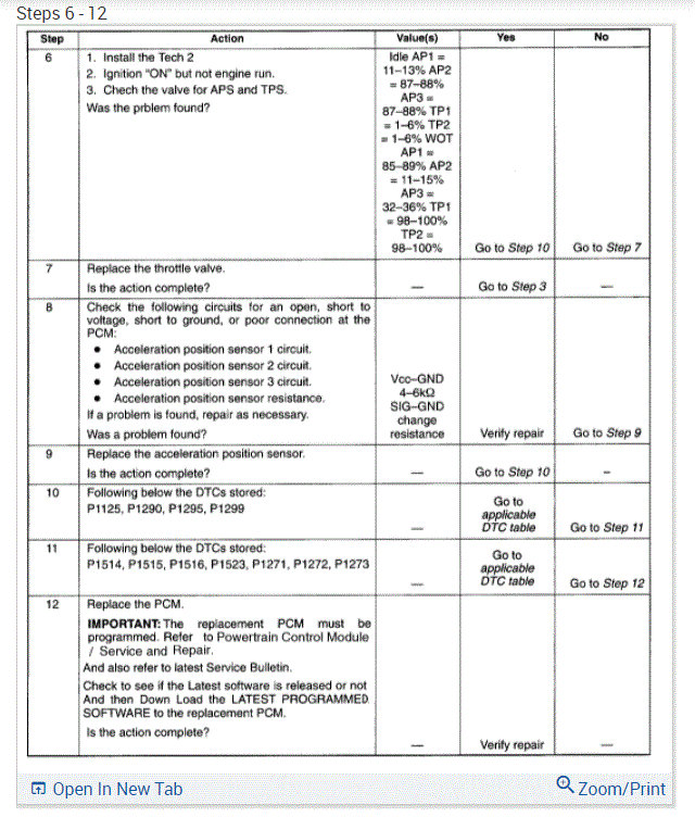

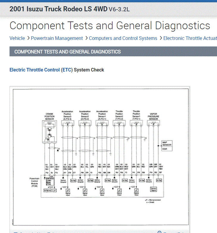

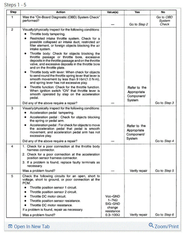

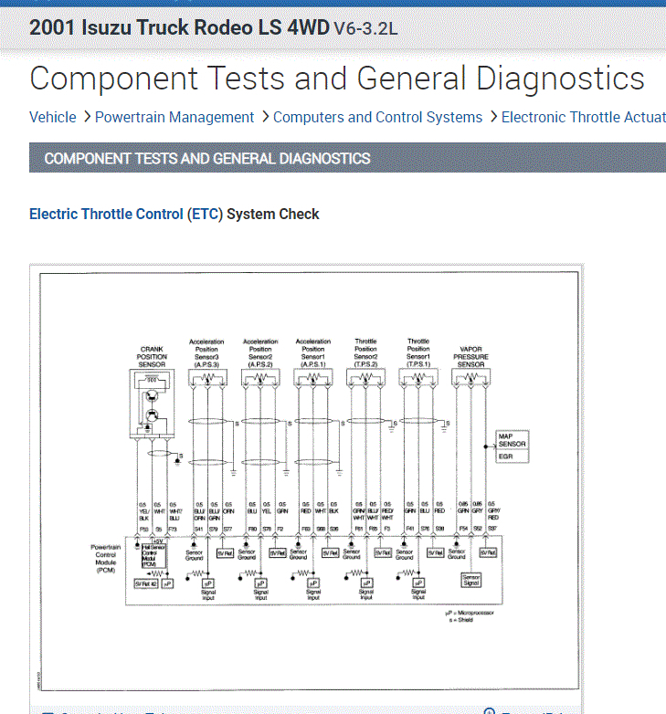

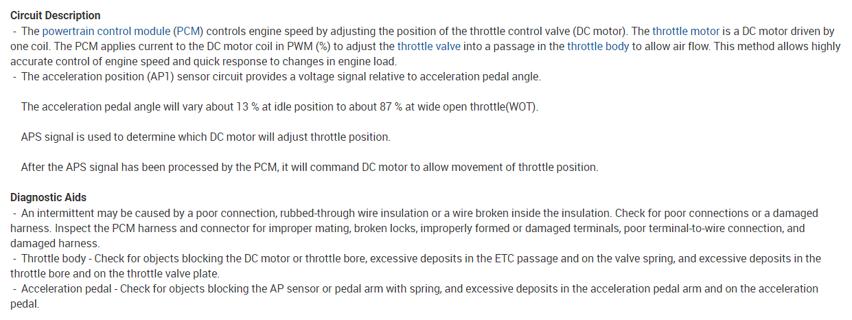

Other than that, we need to test the electronic throttle control system. I attached the flow chart below for testing.

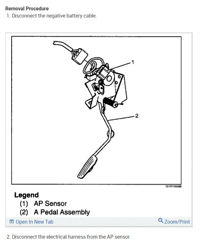

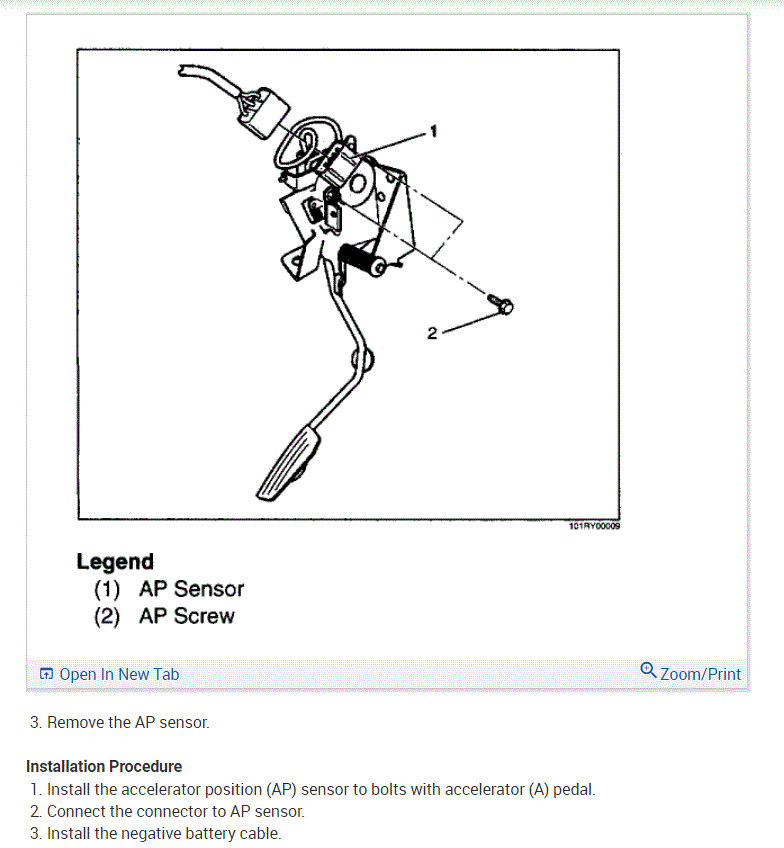

If you determine the APP sensor is the problem, starting with pic 6 below are the directions for removal and replacement.
It makes sense that if it was damaged by water that the engine will remain at an idle simply because it is no longer getting a signal from the sensor.
