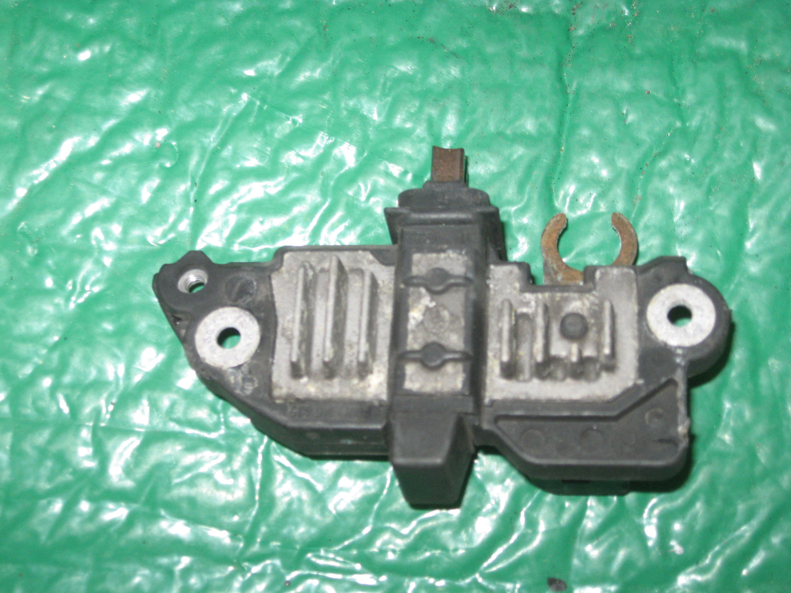

I dropped a wrench while making a repair. It struck the alternator power connection and the frame causing a short circuit. When I started the car, the battery/alternator warning light illuminated. I checked the voltage with the car running and it is either 12 or 12.1 volts, so the system is definitely not charging.
I am trying to determine whether the alternator was damaged by incident or if some other component of the system is causing the problem. I used a voltmeter to perform a diode test and it appears that the diodes were damaged. This is the first time I have worked with a potentially damaged alternator and I am unsure of my testing skills and techniques. I tried to have the alternator tested at two auto parts stores, but the alternator did not fit on their machines correctly and they couldn't run the test.
I purchased a used alternator from a recycler and replaced the voltage regulator on it. It passed the diode test that the original alternator failed. Are there any other tests that I can run on the used alternator before installing it in the car? I will try some other parts stores to see if they can test the alternator, but the machines I've seen appear similar and I am not sure I will be able to find someone to test it.

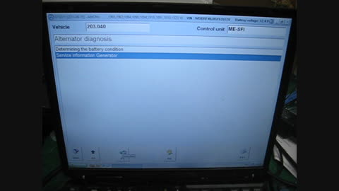

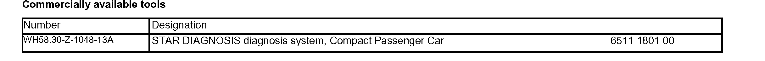

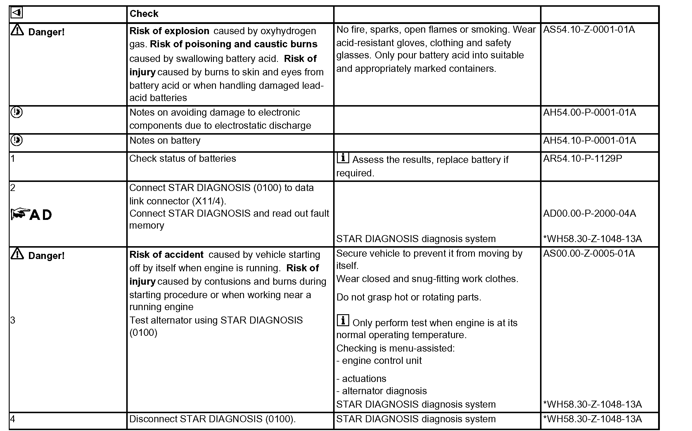

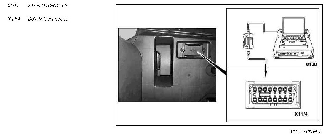

Here is a test for diagnostics. The attached pics indicate directions.
2005 Mercedes Benz C 230 (203.040) L4-1.8L SC (271.948)
AR15.40-P-5000P Test Alternator and Regulator
Vehicle Starting and Charging Charging System Voltage Regulator Testing and Inspection Component Tests and General Diagnostics AR15.40-P-5000P Test Alternator and Regulator
AR15.40-P-5000P TEST ALTERNATOR AND REGULATOR
AR15.40-P-5000P Test alternator and regulator
Component Identification
Pic 1
Steps 1-4
pic 2
Commercially available tools
pic 3

Fortunately, I have access to a Star diagnostic and I will run the test you suggested tomorrow.

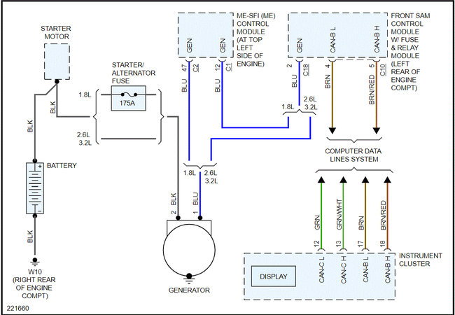

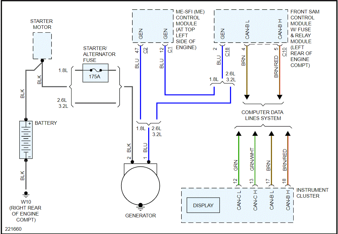

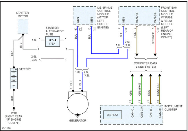

Anything is possible. I attached a picture of the wiring schematic for the charging system. Since the starter is working, I assume the starter/alternator fuse (175 amp) is okay, but check it anyway.

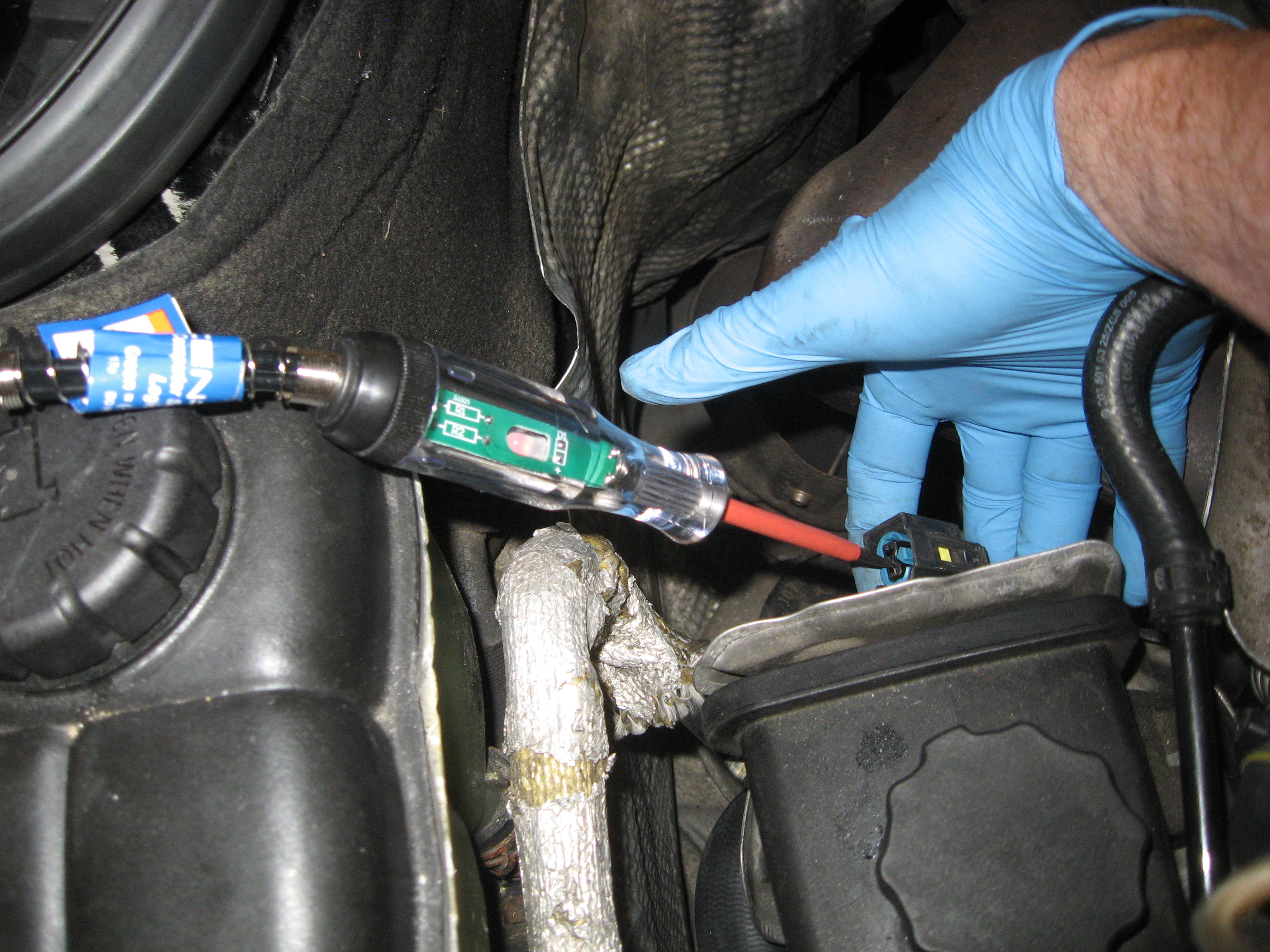

Also, there should be a black wire at the alternator. Check to make sure it is getting power.

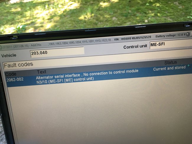

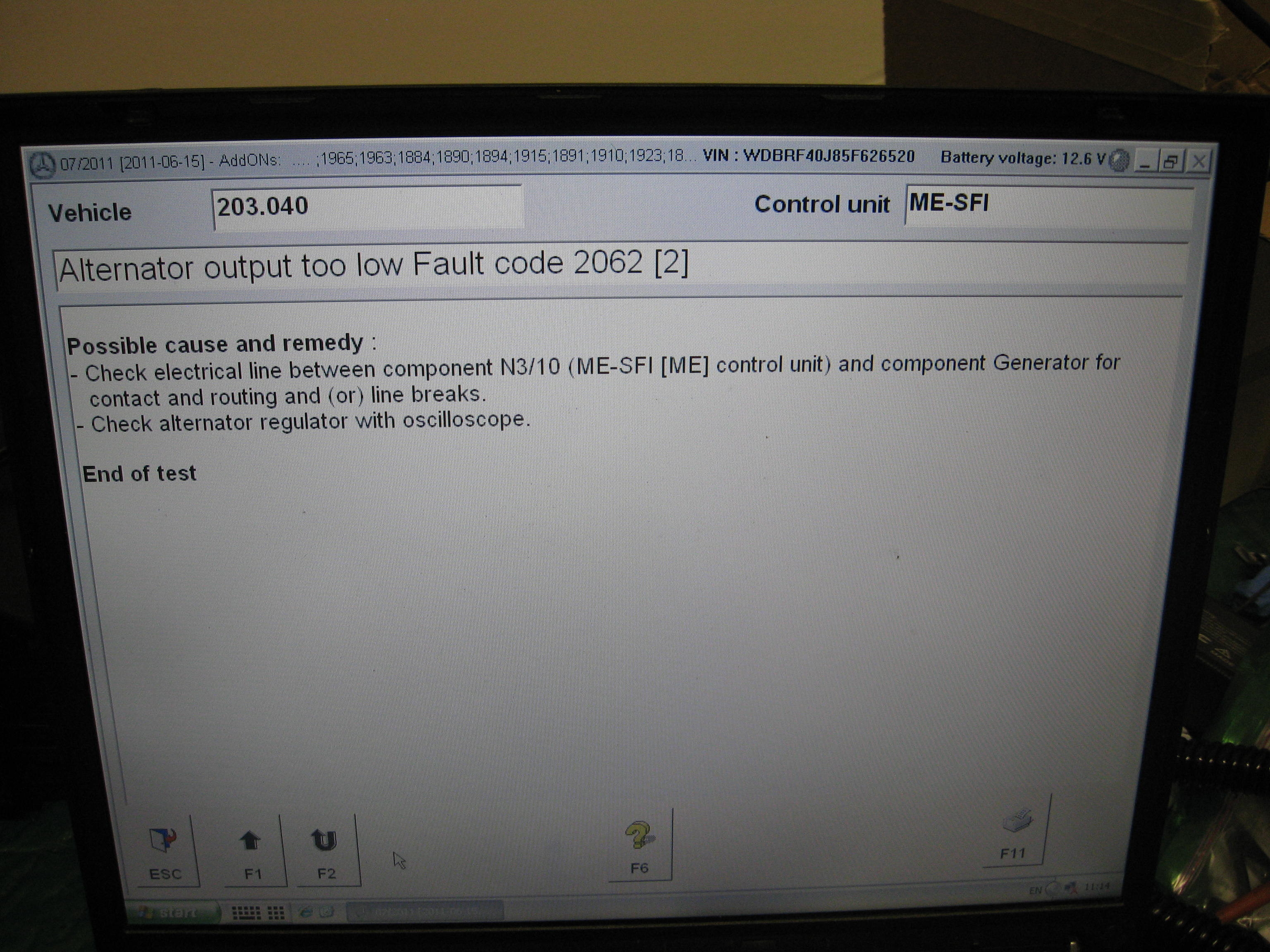

The diagram is helpful. I ran a scan with the STAR tool and the system returned code 2062-002 - Alternator serial interface. No connection to the control module
N3/10 (ME-SFI [ME] control unit)
Based on your diagram, this seems to suggest that there was:
1. Damage to the blue wire that attaches to the control module .
2. (Worse case scenario) a damaged control module.
3. Damaged connector to the alternator.
4. Damaged voltage regulator on the alternator itself since this attaches to the blue wire.
Do you think I am on the right track?
Jun 13, 2020 at 2:33 AM
  • 110,248 POSTS
Yes, it sounds like you are on the right track. With this code, it is usually the regulator unless the wire was damaged between the ME-SFI control module and the alternator. Was there any damage to the wires when you were working on it? Also, since you are getting the code, I don't think it's the control module. I suspect it's the regulator or the blue wire you referred to was disconnected or broken somehow.

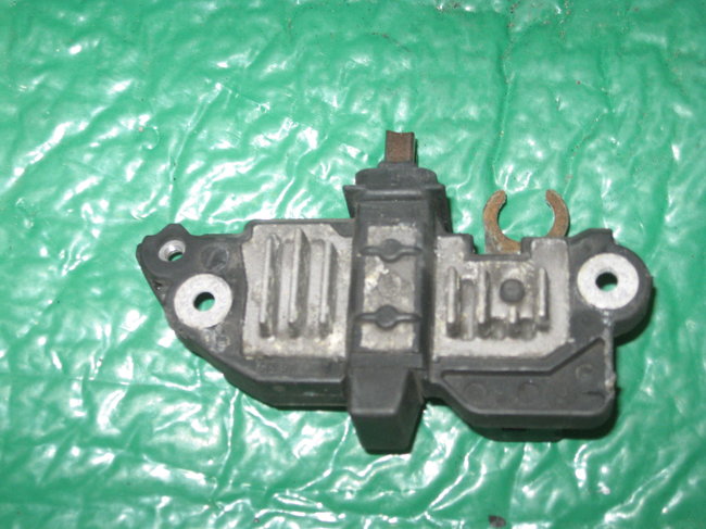

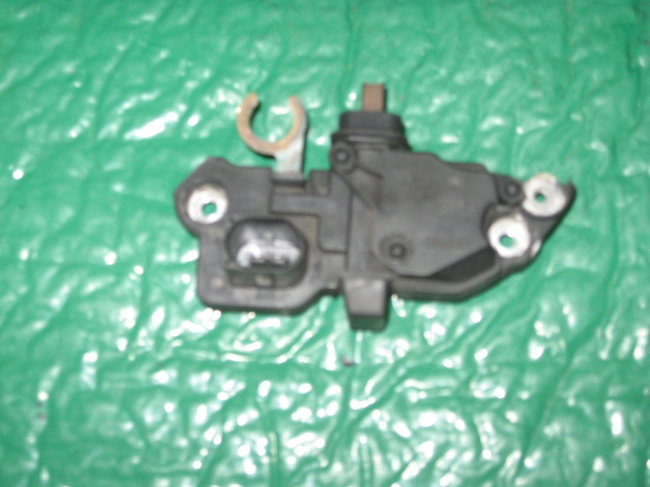

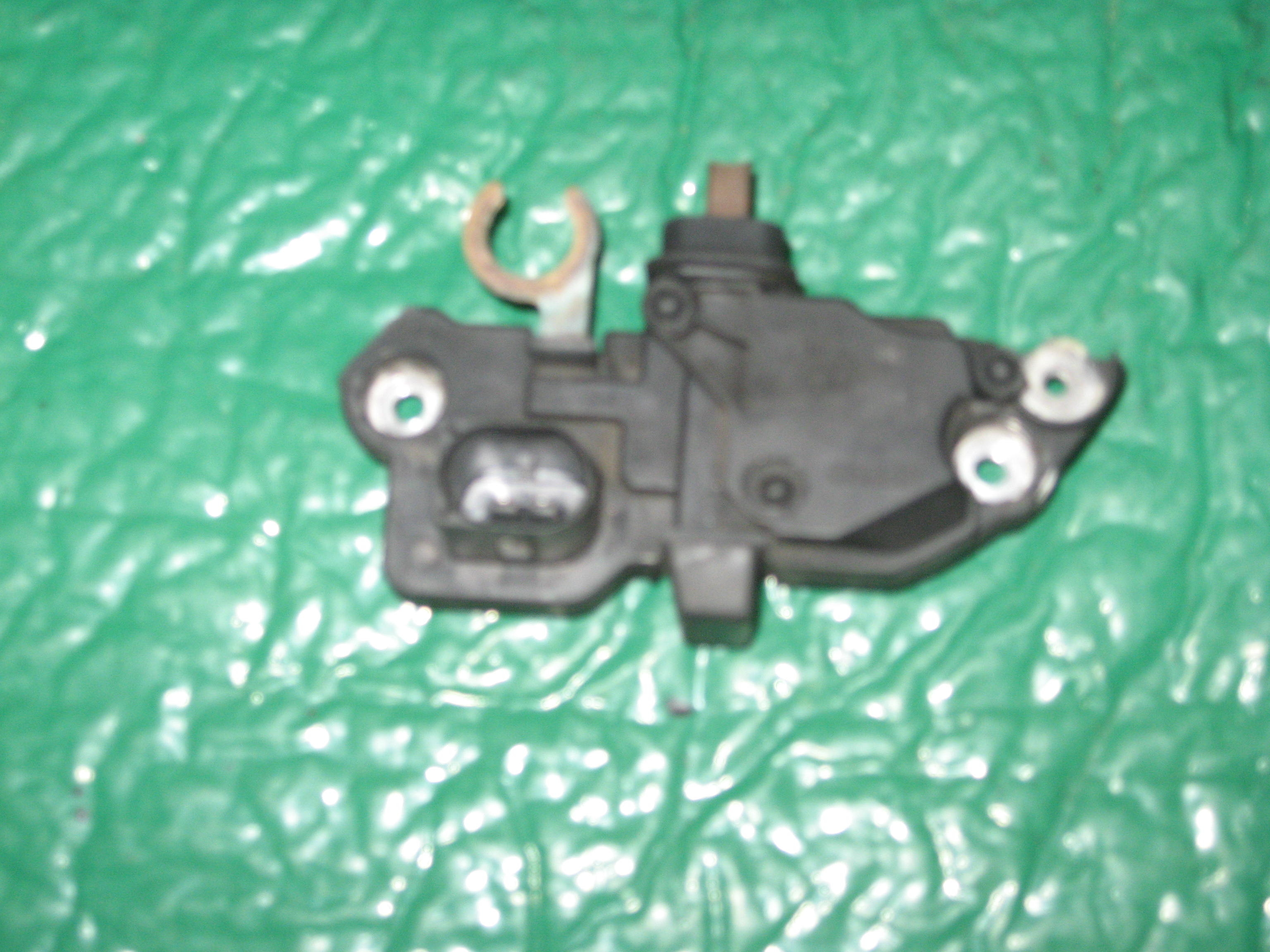

Thanks. It is good to hear that damage to the control module is a less-likely scenario. I couldn't see any damage to the connector or the wires. I'm planning to buy a new voltage regulator and see whether that fixes the problem.
In initially thought it was the voltage regulator. I removed the alternator from the car and had it tested. The test showed it was okay, but I've since found several resources that suggest that the bench test cannot detect issues that are vehicle specific such as communication between the control module and voltage regulator. I don't like to "throw parts at a problem" and a Bosch voltage regulator is $74.00. However, I think I have enough information to justify making the investment and seeing if that works. I'll update the post after I install the new voltage regulator.

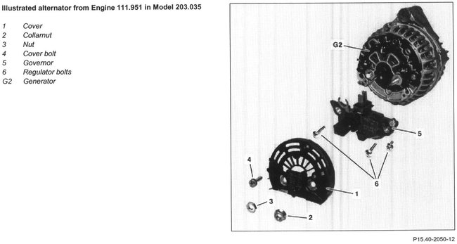

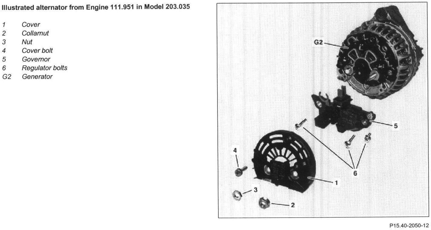

Here are the directions for replacing the regulator. The attached pic correlates with the directions.
____________________________________
AR15.40-P-5760P Remove/Install Regulator of Alternator
Vehicle Starting and Charging Charging System Voltage Regulator Service and Repair Procedures AR15.40-P-5760P Remove/Install Regulator of Alternator
AR15.40-P-5760P REMOVE/INSTALL REGULATOR OF ALTERNATOR
Remove/Install Regulator Of Generator
pic 1

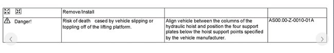

DANGER:
1.Lethal injuries are possible if vehicle slips off of lifting platform
- Align vehicle between the columns of the lifting platform and position the four support plates at the lifting platform support points specified by the vehicle manufacturer.
2.Risk of explosion from explosive gas. Risk of poisoning and caustic burns from swallowing battery electrolyte. Risk of injury through burns to skin and eyes from battery acid or when handling damaged lead-acid batteries
- No fire, sparks, naked flames or smoking.
- Wear acid-resistant gloves, clothing and goggles. Pour battery electrolyte only into suitable and appropriately marked containers.
1 Disconnect ground cable of battery
2 Remove generator (G2)
3 Unscrew collared nut (2)
4 Unscrew nut (3)
5 Unscrew cover bolt (4)
6 Remove cover (1)
7 Unscrew bolts (6) of regulator (6)
8 Remove regulator (5) towards the side
NOTE: Installation: Do not damage carbon brushes
9 Install in the reverse order

I replaced the voltage regulator. Unfortunately that didn’t resolve the issue.
I took a second look at the connector and the blue wire and I could not see any damage. I cannot see more than a few inches of the blue wire and I cannot rule out that is damaged in a spot I cannot see. Another potential problem is that some other component in the alternator is damaged and the test equipment at the auto parts store is not detecting it.
I would be willing to replace the entire alternator if I am able to rule out all other potential sources for the problem.

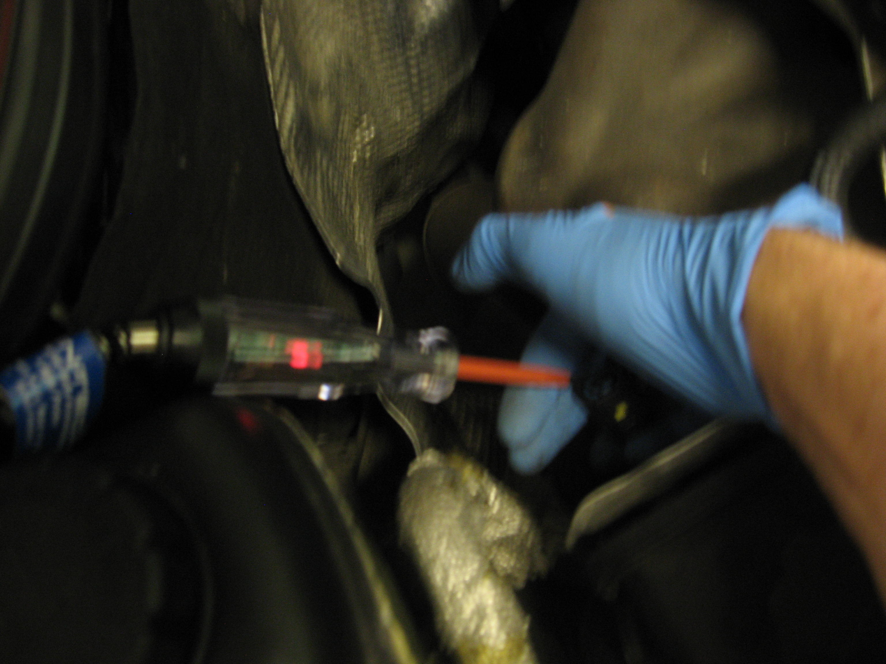

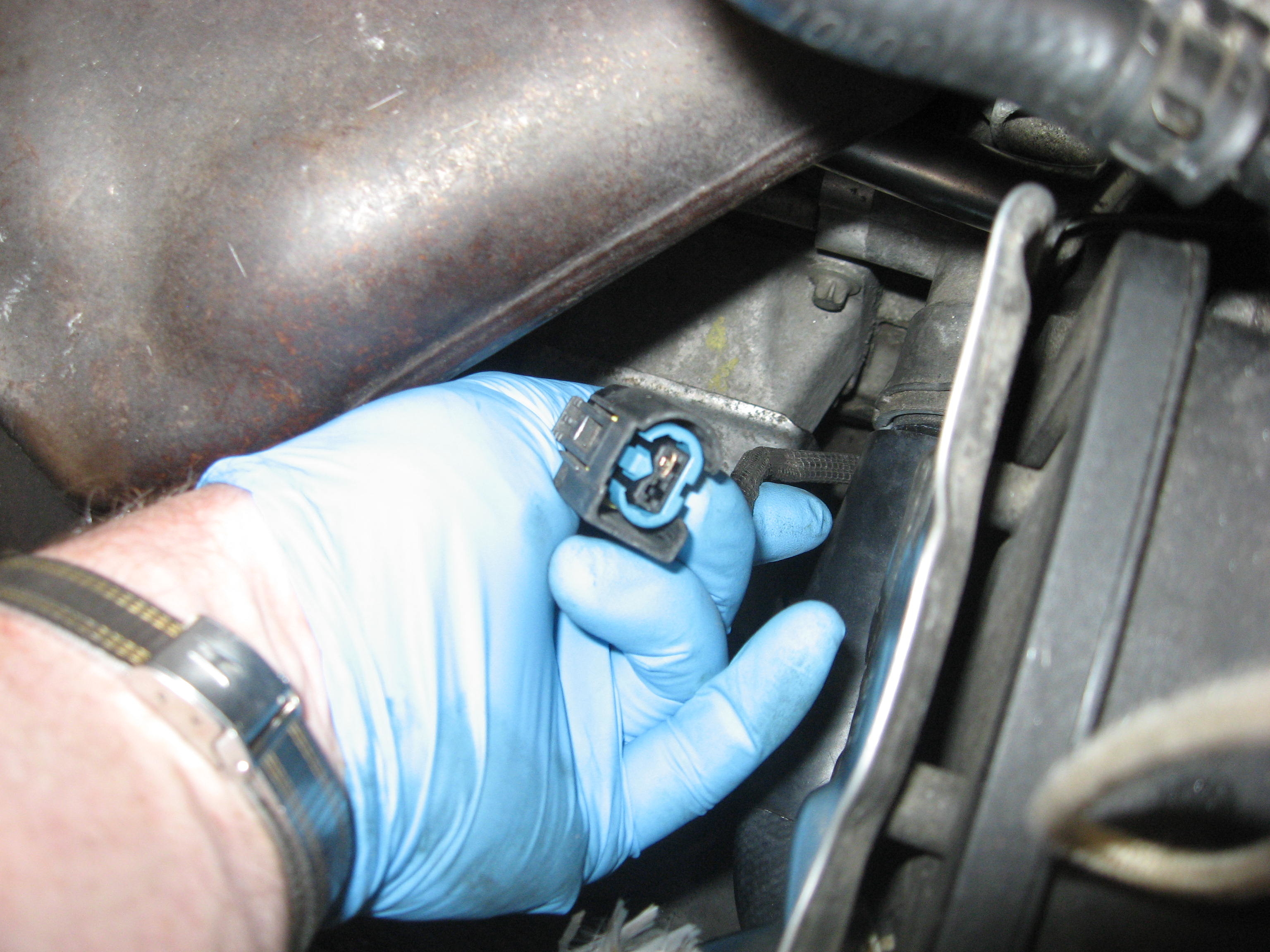

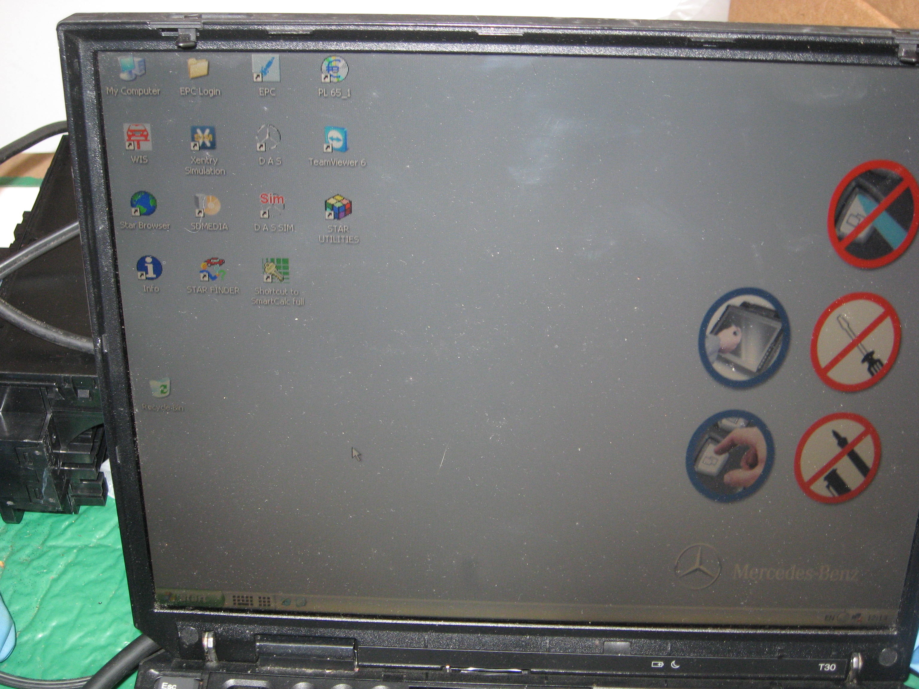

Thanks again for your reply. I checked the voltage at the alternator and it was negligible - approximately 0.4 volts. I connected the STAR system and it read the same fault code I posted previously - 2062-002 - Alternator serial interface. No connection to the control module. When I ran the STAR system, there were menu choices for alternator testing, but they would not run on my system. (I bought the system used and I don't know much about its origins. It may be a Chinese clone.) I've posted a video showing what happens when I attempt to use the alternator diagnosis menu. If you pause it at about the half-way point you should see a message that says, "DAS and WIS are active at the same time. It is possible to switch over between the systems with the key combinations ALT + TAB." I'm not sure whether doing that will allow the test to run, but I will give it a try later.

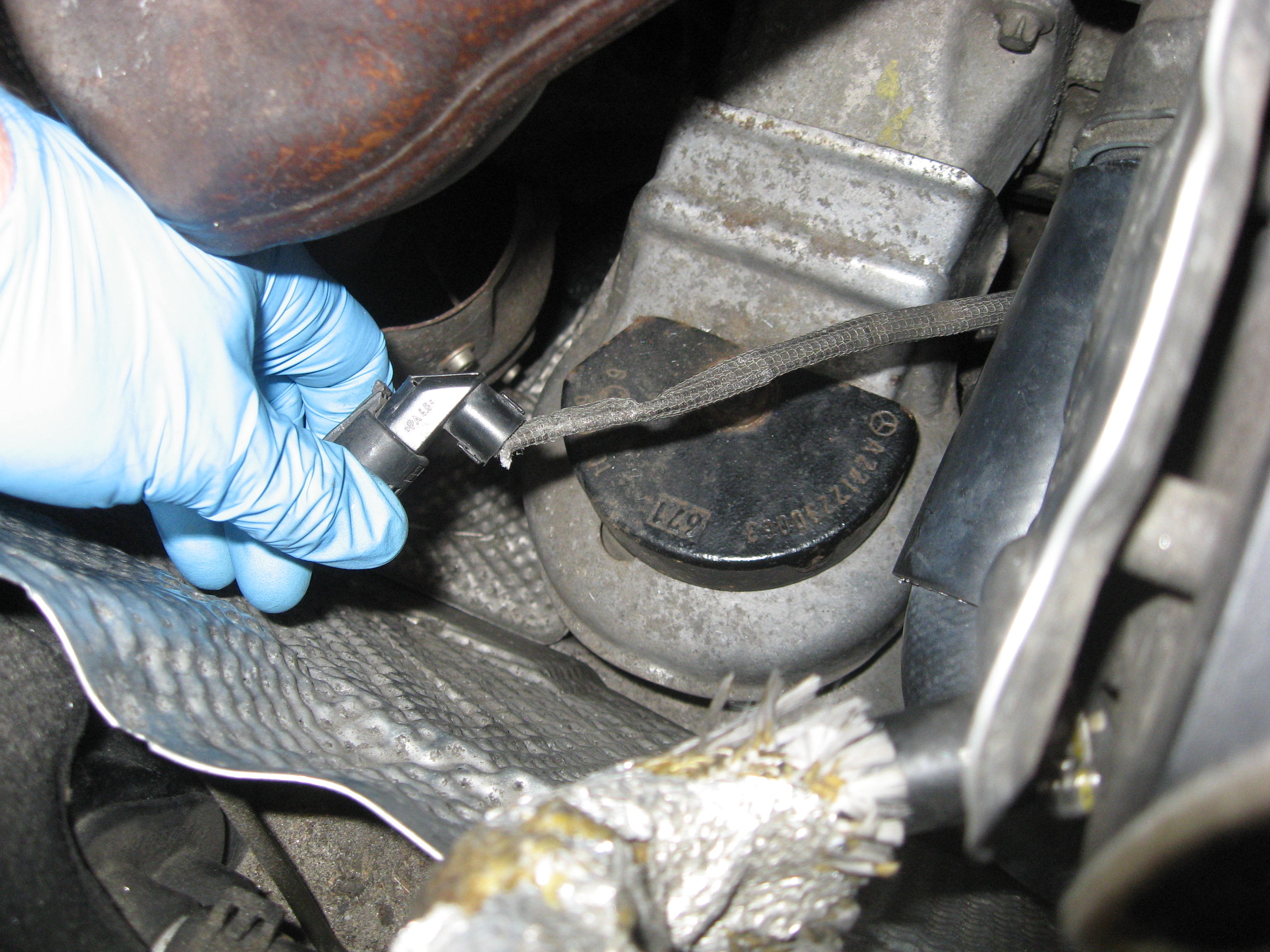

I've also posted photos showing the data connector and the battery connector to the alternator and the voltage regulator that I removed. I cannot see any visible damage.
I think the problems could be:
1. Damage to another part of the alternator.
2. Damage to the communication system between the ECU and the alternator which is preventing the alternator from receiving a signal to turn on.

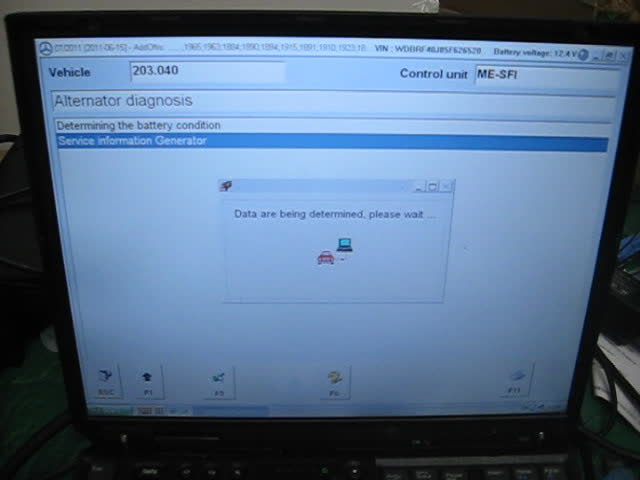

I was thinking of buying this: https://www.harborfreight.com/Computer-Safe-Automotive-Logic-Probe-63597.html and using it to probe the connection from the ECU to the alternator. My thought process is that it will show whether there is a signal coming from the ECU.
If the alternator is indeed damaged, it appears that buying a rebuilt alternator is the best option. Before I do that I would like to rule out the other possible causes.
Jun 20, 2020 at 1:49 AM
  • 110,248 POSTS
I watched the video. That jumps around really fast. After the 4th or 5th try, I got it paused so I could read it. LOL
Try what it is saying. The system seems to be glitching for some reason. As far as the start of this issue, I wouldn't think there is a break down in communication. I have a feeling it's the alternator itself, but testing will tell for sure.
Jun 20, 2020 at 2:14 PM

Unfortunately hitting alt and tab didn't do anything. I did find another menu (see photo) that suggested (1) checking the communication line between the alternator and the control unit for a break or short and (2) checking the regulator (assuming it means voltage regulator) with an oscilloscope. Because I replaced the voltage regulator (and I don't have an oscilloscope) I will try to figure out how to check the communication line.
Jun 21, 2020 at 1:30 AM

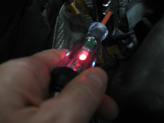

I used a test light to determine whether there was connectivity between in the data wire from the ECU to the alternator. It may be hard to see in the photos, but the LED in the test light is glowing red indicating it has power. I don't know whether it is sending the correct data to the alternator when the system is on, but I guess there are no breaks in the wire. I also cannot see any damage to the part of the wire that is visible or to the connector.
On a different but related topic, I'm wondering whether something wasn't installed on my STAR system. It does not have an icon for the WIS.
Jun 21, 2020 at 2:35 AM
  • 110,248 POSTS
It looks like the communication is open so that wire isn't the cause. The last thing is the alternator. I suspect there must have been internal damaged done (somehow) to the alternator. Nothing else makes sense. Also, in your original post, you indicated you tried to have it tested at two different parts stores but it wouldn't fit their machine. Is that correct? Is there any reliable shops in the area that would test it for you? For example, a place that deals specifically with auto electrics?

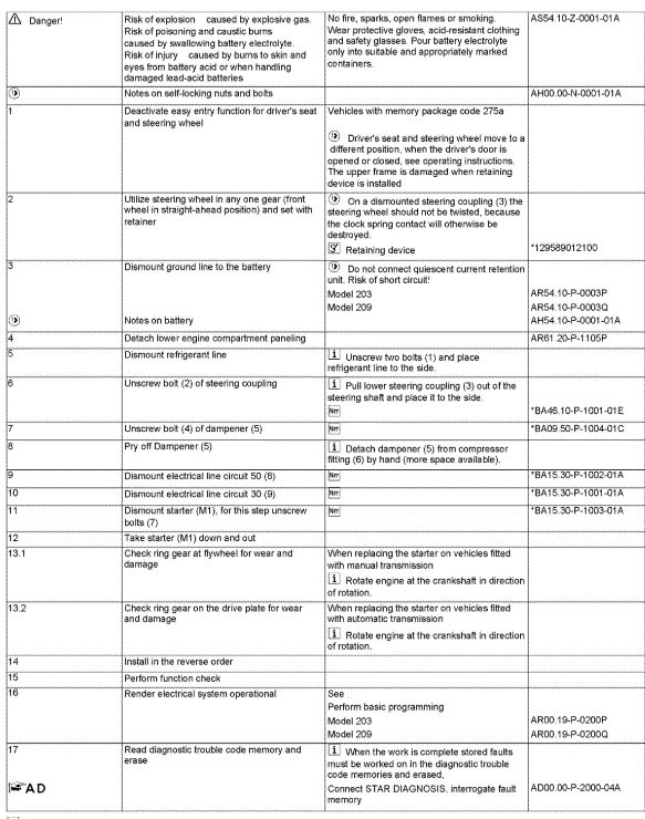

I received a tip on one of the Mercedes forums. There is a fusible link in the starter-alternator wiring loom. I used my test light to check the alternator terminal with the alternator disconnected. There was no power.
I am going to have the alternator tested again tomorrow. If the test shows it is good, I will be turning my focus to the fusible link. Unfortunately it is not in a readily accessible location. I will be studying starter removal procedures on the M271 engine for clues on removing the starter cable.
Jun 22, 2020 at 1:35 PM
  • 110,248 POSTS

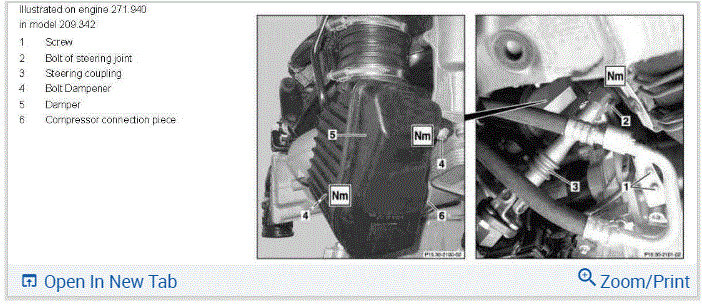

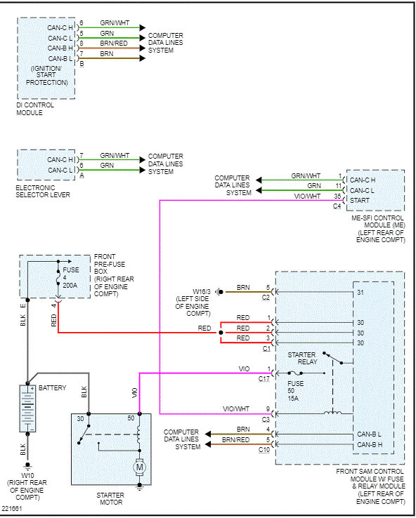

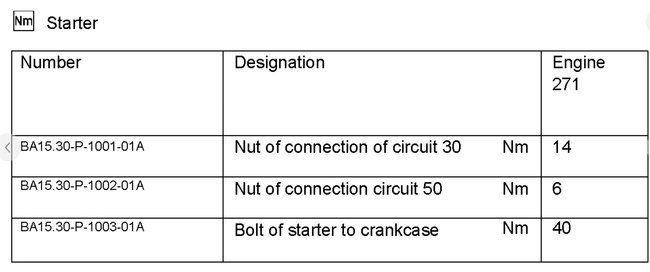

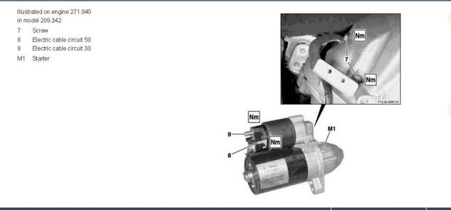

Here are the directions for starter removal and install. Actually, the attached pics include the directions.
___________________
AR15.30-P-7100Q Remove Starter, Install
Vehicle Starting and Charging Starting System Starter Motor Service and Repair Removal and Replacement AR15.30-P-7100Q Remove Starter, Install
AR15.30-P-7100Q REMOVE STARTER, INSTALL
Remove starter, install
See attached pics
___________________
pic 10 is the charging system schematic. Pic 11 is the starting system schematic.

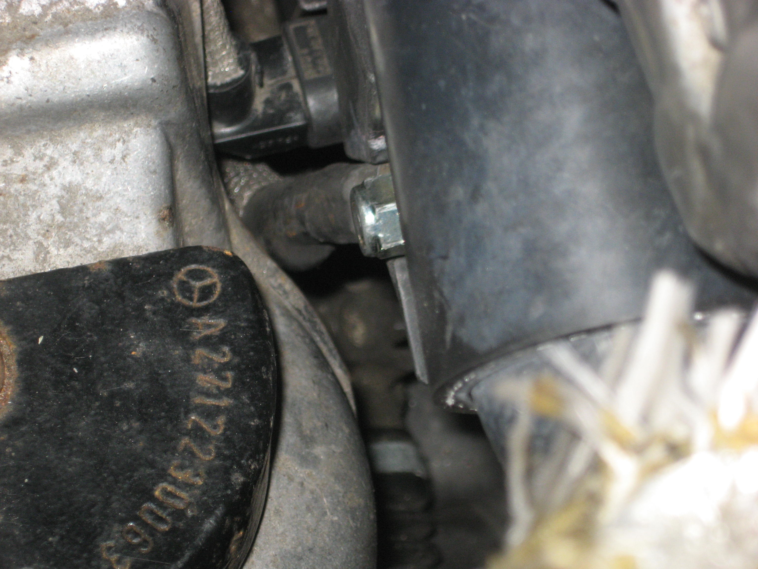

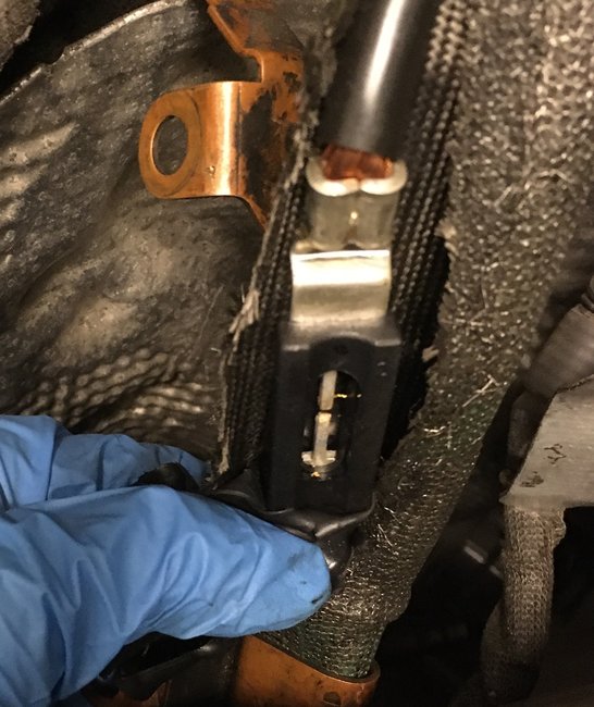

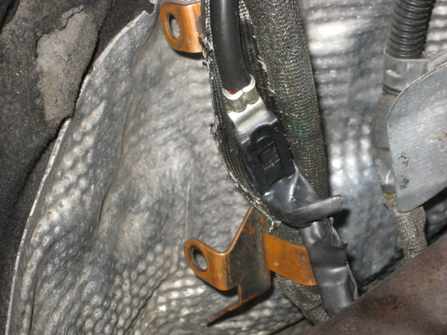

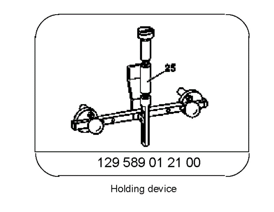

Thanks for the instructions. I would not have been able to remove the battery/starter/alternator cable without them.
Once I had the bolt off, I was able to pull it over the bell housing.  I had to open up the protective casing to access the 175-amp fusible link.  Then, I verified that the link had blown with my test light.  The battery side of the link had power. The other side did not.
Unfortunately, it does not appear that a replacement link can be swapped in.  I searched on the term "175-amp fusible link" and couldn't find anything that looked like the one in the car.  The fusible links that my search identified had different configurations.  It looks like the one Mercedes used was crimped on using a machine that could generate a significant amount of force.
I want the repair I make to be reliable. Although I can find 175 amp fusible links, they look different than the one in the car. (See photos.)
 If I use a fusible link like the one I can buy in an auto parts store, I need to find a way to install that won't allow it to come loose over time.  A better option may be to replace the entire cable with one from a recycling yard.  I have access to a C230 that I used to harvest replacement parts.  Unfortunately, it is sitting on flat tires in the owner's back yard.  To remove the bolt on the starter, I must get under the car and I cannot think of a safe way to do that.
I found one on an auction site for a coupe, but the listing doesn't confirm that the cable will fit a sedan.  I may take a chance and buy it anyway.
I will appreciate any suggestions.

I looked more closely at the fusible link assembly.  There was a small cover that I could remove. I have attached a photo of the fusible link. The photo verifies that the link is blown
Does anyone have any ideas about (1) how to replace the link and (2) where can I find the replacement 175-amp link?

The only thing I have is what is related to the code that you found originally. Here is what is listed:
Test 1: Alternator Output Too Low Fault Code 2062 [2]
Vehicle ALL Diagnostic Trouble Codes ( DTC ) Testing and Inspection Manufacturer Code Charts Powertrain Management Code Tests 2062 [2] Alternator Serial Interface: No Connection to Control Module N3/10 (ME-SFI Control Module) Test 1: Alternator Output Too Low Fault Code 2062 [2]
TEST 1: ALTERNATOR OUTPUT TOO LOW FAULT CODE 2062 [2]
Alternator output too low Fault code 2062 [2]
Possible cause and remedy
- Check electrical line between component N3/10 (ME-SFI control module) and component Generator for contact and routing and (or) line breaks.
- Check alternator regulator with oscilloscope.

The alternator starts charging and holds a steady voltage reading of 14 volts even after it returns to idle. I have 3 problems:
1. The alternator warning illuminates
2. The fault code for no communication with the control unit remains
3. The voltage should be 13.4 to 13.6 and I am concerned about over charging the system and damaging another component if I run the car for a long time at 15 volts.
I was able to return the new alternator I bought for a refund because the original alternator with the replacement voltage regulator exhibited the same performance.
I confirmed that the wiring between the alternator and the ECU and between ECU and the front SAM is undamaged.
I am wondering whether the front SAM could have been damaged by the short I induced with my wrench. I know that the wiring between the ECU and the alternator and the ECU and the SAM is OK, but the circuit board in the SAM may not have fared as well. I could install a SAM I removed (because of a defective turn signal) in the car. If this fixes the alternator communication problem I understand that I would have to buy another SAM to repair the turn signal issue. I am also wondering whether a damaged SAM might explain the problem I am having with DAS/Xentry. The system has been returning error messages and won’t allow me to run tests consistently.
I may also be starting to grasp at straws. I would appreciate any feedback you can offer.

I made some progress as you can see in this video:
https://www.youtube.com/watch?v=n23pGP5JSzA
When I rev the engine the alternator starts charging and produces 14 volts even after returning to idle. I have three problems:
1. The alternator warning light continues to illuminate
2. The error code for no communication with the alternator continues to set
3. I confirmed with other C230 owners that 13.4 -13.6 volts is the normal reading and I am concerned that too much voltage may damage a component
I confirmed that there is no damage to the wiring between the alternator and the ECU and between the ECU and the front SAM with a multi-meter.
I am wondering whether the front SAM could have been damaged by the short I induced with my wrench. I know that the wiring between the ECU and the alternator and the ECU and the SAM is OK, but the circuit board in the SAM may not have fared as well. I could install a SAM I removed (because of a defective turn signal) in the car. If this fixes the alternator communication problem I understand that I would have to buy another SAM to repair the turn signal issue. I am also wondering whether a damaged SAM might explain the problem I am having with DAS/Xentry. The DAS/Xentry system has been returning error codes and balks at performing some tests.

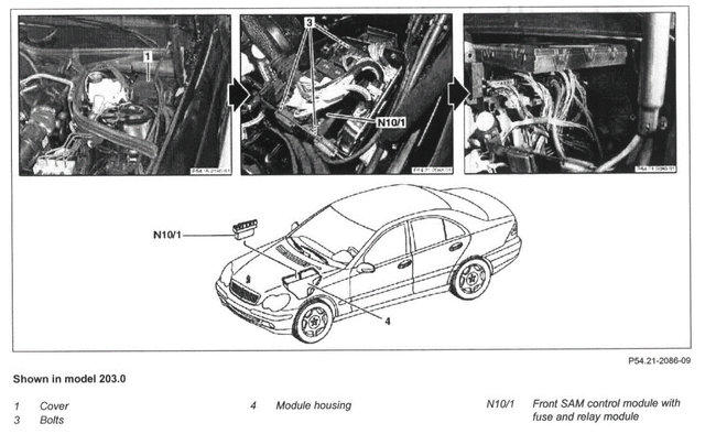

It is possible for damage to it. Also, the voltages you mentioned and normal. I've seen them over 14 with no issues. Actually, with the engine running and things off, 14 is what I consider to be a target voltage.
Switch the two sam modules and let me know what happens.
I don't know if you need it, but here are the directions for removal and replacement of the front SAM module.
AR54.21-P-1260P Remove/Install SAM With Fuse and Relay Box, Left Front
Vehicle Powertrain Management Relays and Modules - Powertrain Management Relays and Modules - Computers and Control Systems Body Control Module Service and Repair Removal and Replacement AR54.21-P-1260P Remove/Install SAM With Fuse and Relay Box, Left Front
AR54.21-P-1260P REMOVE/INSTALL SAM WITH FUSE AND RELAY BOX, LEFT FRONT
Shown In Model 203.0
Pic 1
DANGER:
- Risk of injury in the form of trapping or crushing, or even severing of limbs, if caught in windshield wiper mechanism
- Always remove ignition key when working on windshield wiper mechanism.
1 Set wiper arms to vertical position
DANGER:
- Risk of explosion from explosive gas. Risk of poisoning and caustic burns from swallowing battery electrolyte. Risk of injury through burns to skin and eyes from battery acid or when handling damaged lead-acid batteries
- Wear protective gloves, acid-resistant clothing and safety glasses. Pour battery electrolyte only into suitable and appropriately marked containers
2 Disconnect ground cable of battery
CAUTION: Do not connect quiescent current retention unit due to risk of short-circuit.
3 Unlock and remove cover (1) on module housing (4)
NOTE: Installation: Check gasket for damage
4.1Remove injection system control module
4.2Remove front SAM control module with fuse and relay module (N10/1) from guide.
5 Unscrew bolts (3)
6 Release and remove connectors
NOTE:
- At top on front SAM control module with fuse and relay module (N10/1)
- Removal: Disconnect cables from control module and fuse and relay box
- Installation: Connect cables on control module and fuse and relay box
7 Expose wiring harness.
8 Remove front SAM control module with fuse and relay module (N10/1) upwards.
NOTE: Pull out only until connectors are accessible from below.
9 Release and remove connectors
NOTE:
10 Remove front SAM control module with fuse and relay module (N10/1).
NOTE: When replacing, the fuse and relay assignment must be inspected.
11 Install in the reverse order
12 Perform basic programming
13 Read diagnostic trouble code memory and erase
14 Check for proper function
_______________________________________
Let me know what you find.

finally decided to take the car to the dealer. To make a long story short they decided that the LIN Bus wire between the alternator and the ECU is shorting to ground. They told me that their solution was to replace the engine wiring harness and estimated the cost at $2,400.00. I declined the repair.
You may recall that I tested the wire between the alternator and the ECU and the wire between the ECU and the front SAM and they seemed to have good continuity.
At this stage I can think of three options:
1. I am wondering whether it is possible to run a jumper wire from the ECU to the alternator connector to see whether that solves the problem.
2. If that isn't possible, I expect that I can find someone to replace the wiring harness for less than the $2,400.00 quoted by the dealer.
3. I could just drive the car and see if that works. I'll need to get accustomed to seeing the warning light every time I turn the car on.
I don't want to do anything that further damages the car, but I think I've reached a point where I need to perform a rigorous cost-benefit analysis before I invest any additional money.
