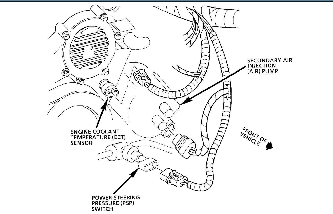

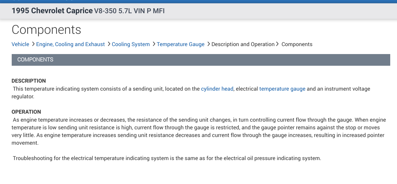

I was told that there are two temperature sensors, but only found one. the one in the front of the engine was replaced so where’s other one located?

The Engine Coolant Temperature sensor [ECT] for the Power-train Control Module [PCM] or "computer" is located on the left front of the engine. The temperature switch for the temperature gauge is located in the cylinder head of your vehicle's engine. In the diagrams down below I have included a diagram and description of where each of these components is located. I hope that this helps.
