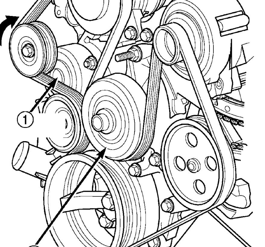

Now remove the drive belt from the water pump pulley (2) by using the tensioner to release it.

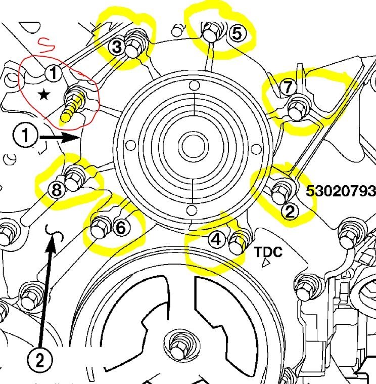

Remove seven water pump mounting bolts and one stud bolt and the pump will come off with a bit of force.
Now use a scraper to gently remove all traces of the old gasket.
To install the replacement you reverse the process and use the pattern shown to tighten the bolts down to 43 foot pounds. The red circle is where the stud goes. Both engines use the same pump and this is one area I tend to go with aftermarket because the OE pumps use a plastic impeller, Gates makes a replacement 43263M with a metal impeller that seems to hold up better.
