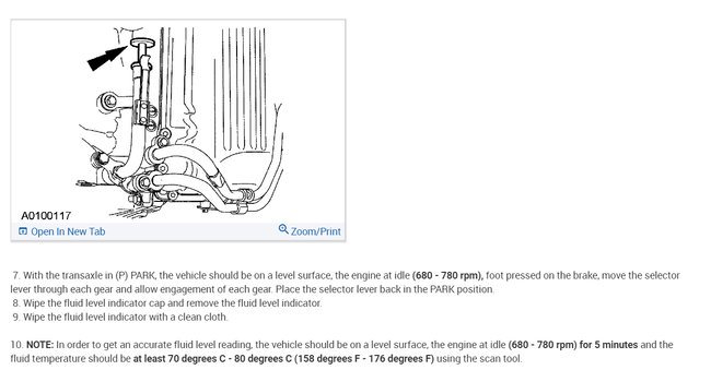

I would start by checking the transmission fluid level.
This guide will help and I have included how to check the level in the diagrams below for your car:
https://www.2carpros.com/articles/how-to-check-and-add-transmission-fluid
If the fluid level is okay, it sounds like you have a transmission fluid temperature sender that is not working correctly or the transmission is slipping, how does it feel when you drive it?
Here is how you check the fluid level in your car below. Let me know what you find.

The diagram you have shown is nothing like where my transmission dipstick looks like. The Ford manual does not recommend owners fiddle with the fluid changes and adding fluid. That never scared me! Its under the battery box after removal of all the air intake components. I have checked the fluid level and it is nearly at the bottom of the "hash" marks. I'm guessing it is down 3/4's of a quart if the full hash mark section represents 1 quart. I am having difficulty obtaining the Motorcraft CVT fluid. Everyone is out it seems. I know Ford's CVT transmission is a chain type and not a belt so it could be fluid sensitive and will definitely need the Motorcraft brand. However, the transmission is quiet and functions through all the gear shifts as it should. Additionally, my laser temp sensor shows the oil pan temp to be at about 125 degrees while the vehicle temp gauge is just about pegged at hot. Understand my wife never continues to drive when the gauge climbs to hot. She pulls over every time and will continue till we figure out what's up. In most all my research on the web I cannot find if and where the coolant temperature sensor is. All I find is a Cylinder Temperature Sensor located behind and under the intake manifold. I'm not sure if I can tackle that job if it requires me removing the intake and other goodies that might be required. If it is removing a cover and unplug and unscrew, that I can do.

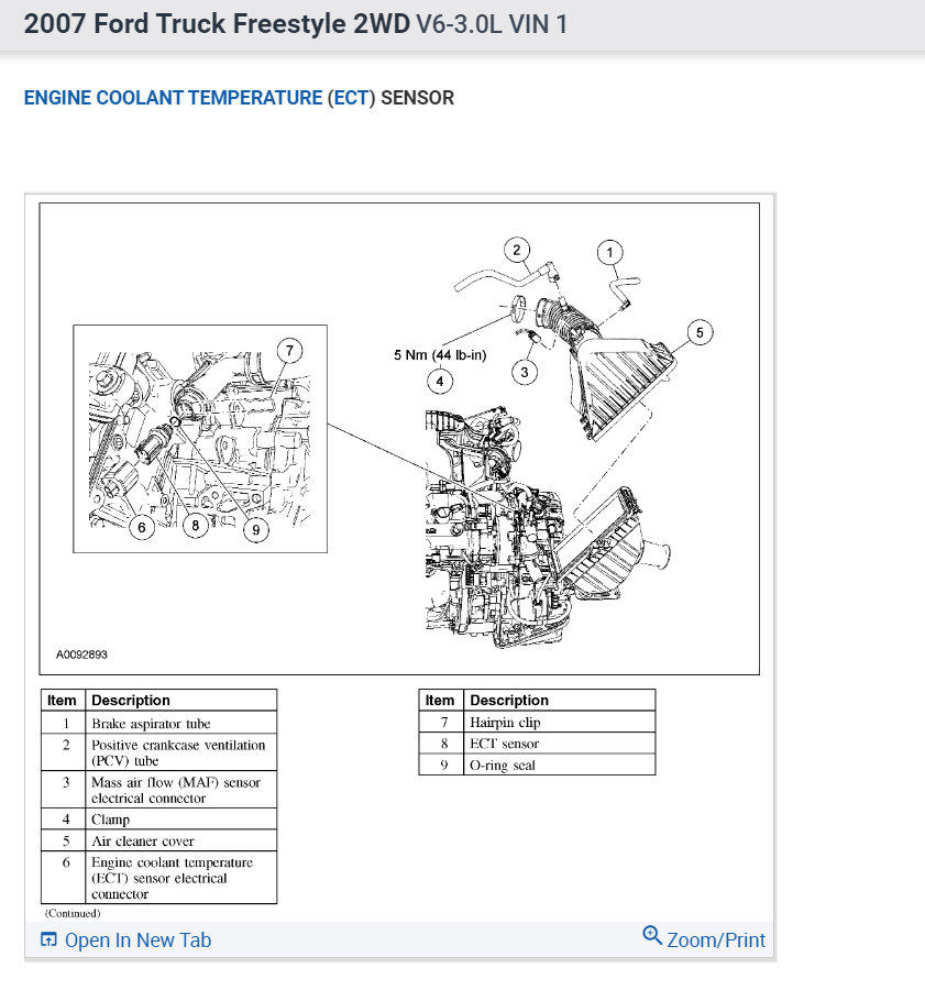

Okay, so it sounds like the engine is not overheating but the gauge or the data is incorrect,

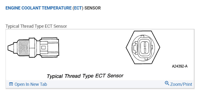

The ECT sensor is a thermistor device in which resistance changes with temperature. The electrical resistance of a thermistor decreases as the temperature increases, and the resistance increases as the temperature decreases. The varying resistance changes the voltage drop across the sensor terminals and provides electrical signals to the PCM corresponding to temperature.
Thermistor-type sensors are considered passive sensors. A passive sensor is connected to a voltage divider network so that varying the resistance of the passive sensor causes a variation in total current flow. Voltage that is dropped across a fixed resistor in a series with the sensor resistor determines the voltage signal at the PCM. This voltage signal is equal to the reference voltage minus the voltage drop across the fixed resistor.
The ECT measures the temperature of the engine coolant. The PCM uses the ECT input for fuel control and for cooling fan control. There are 3 types of ECT sensors, threaded, push-in, and twist-lock. The ECT sensor is located in an engine coolant passage.

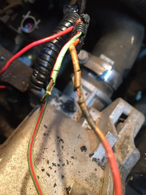

Okay, it's been a while since my last communication because I have been waiting for Transmission Fluid in the Mail. It arrived and I topped off the fluid. Additionally, I purchased a new Engine Coolant Temperature Sensor and installed it. However, the wires that connect to the sensor were in bad shape. (See the photo) I replaced the wires, plugs and all. Soldered to be sure of a good connection. Hoping this will solve my issue. I let the car warm up and test drove it. Once again at 35 to 40 the temperature rose to the hot line, and I pulled over and turned off the engine. I waited exactly 3 minutes and started the engine. The temperature gauge read normal put it in drive and in about a 3/4 of a mile the temperature again rose to the hot line. I waited 2 minutes this time and again the Temp was normal. I made it to my carport with the gauge at the hot line. I used my Infrared temperature gun on various engine parts Block, Heater Hoses, Water Pump, Intake Manifold Bolts and more and the hottest reading I got was 204 degrees. Most were 170 or below. So, what do you think is my next step? Would the Cylinder Temperature Sensor have anything to do with this issue?

looking at the picture and it looks like the red wire on the right is burnt in spots, check to see if any wire is grounding out. With no signs of the temp overheating. To me is a wire touching or the sending unit is going bad. Use your infrared and check the sending unit. Just had another thought, what about the serpintine belt could that be a little loose?

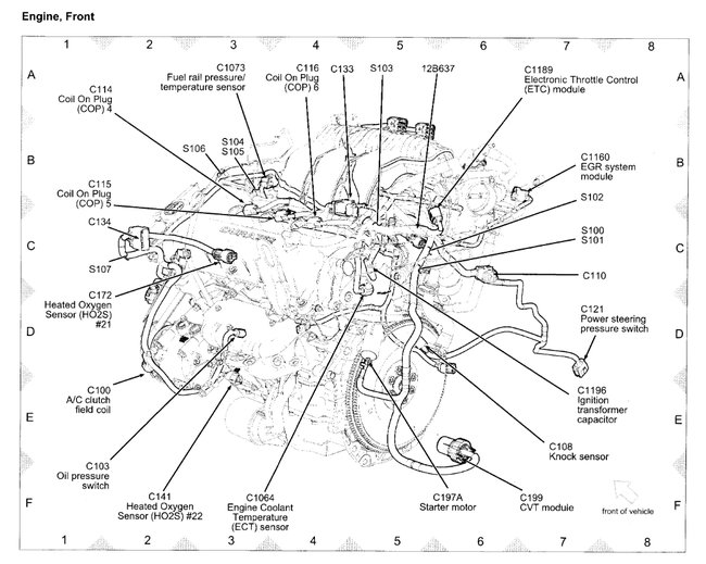

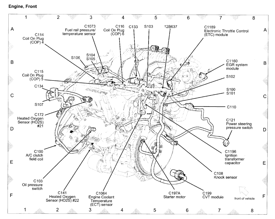

I was thinking it could be the CVT control module back feeding into the PCM, to check for sure let's unplug the module to see if it changes the gauge.
Sep 19, 2022 at 4:58 PM
SHEDDRAT
  • 15 POSTS
Hello Ken, I have a couple of questions before I tackle your recommended test. Is it correct that I will need to remove the tire and the inner wheel well to access the CVT sensor plug? Will the transmission function if the CVT is unplugged?
Sep 21, 2022 at 7:10 AM
  • CAR REPAIR CONTRIBUTOR
  • 54,193 POSTS
I am not sure about removing the inner fender liner, but it is what the instructions say, the transmission will not operate when it is unplugged, I just wanted to see if the temperature gauge acted normal when it is unplugged to confirm the issue.
