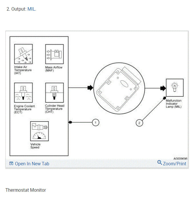

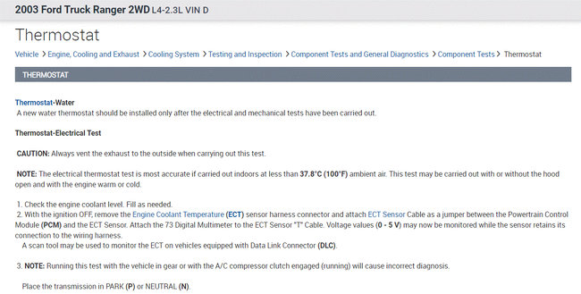

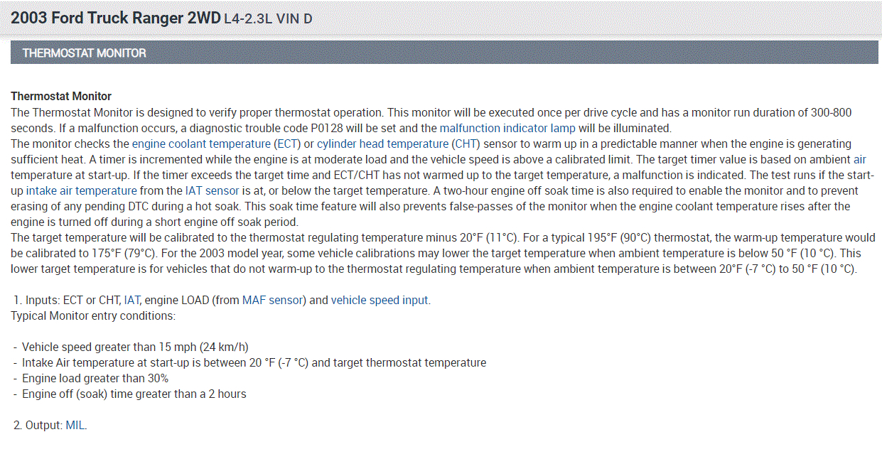

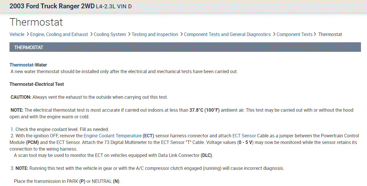

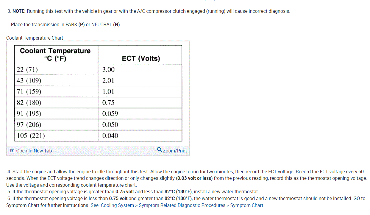

Do me a favor. Take a look at the two pics below and let me know if you have already done this.

It could be the thermostat monitor. Do me a favor. I attached the diagnostics for testing the system. Take a look through them and let me know if you are comfortable performing the tests.
