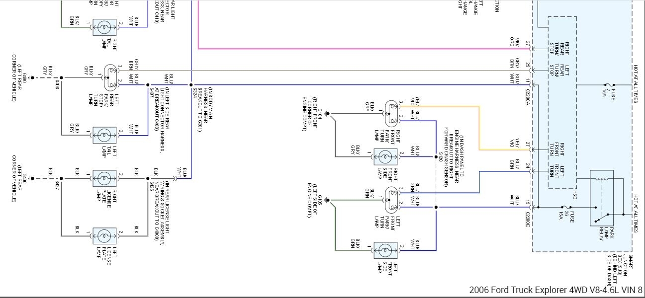

Taillights stopped working I changed the bulbs and check the fuses
2006 FORD EXPLORER
150,000 MILES • V8 • AUTOMATIC
KAT PLAYAS
However, my brake lights work. I changed the bulbs and check the fuses still no taillights.

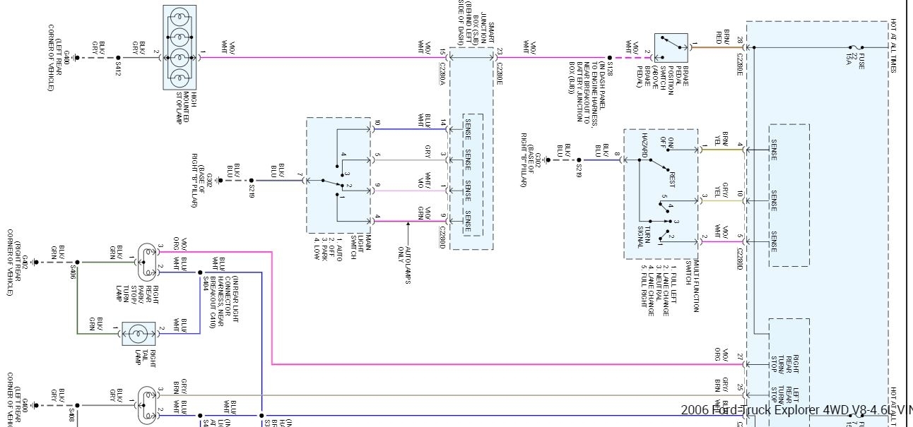

Hello Kat,
It sounds to me like you could have a bad ground connection. I have uploaded the wiring diagram for that circuit it shows the grounds and there locations. Rotate them in your image program I had to put them sideways to get it to fit at a good readable size. Do you have a test light? If you don't see an obvious broken ground wire we will have to do some tests to isolate which component isn't working properly.
Let me know,
Tom

KAT PLAYAS
Yes I did, thank you it was a bad ground.
