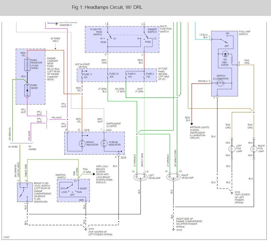

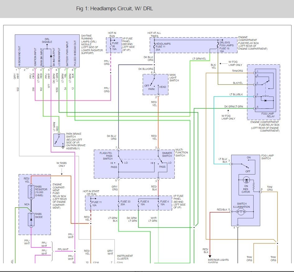

Running lights and dash not working
1995 FORD EXPLORER
200,000 MILES
JERIDILEY

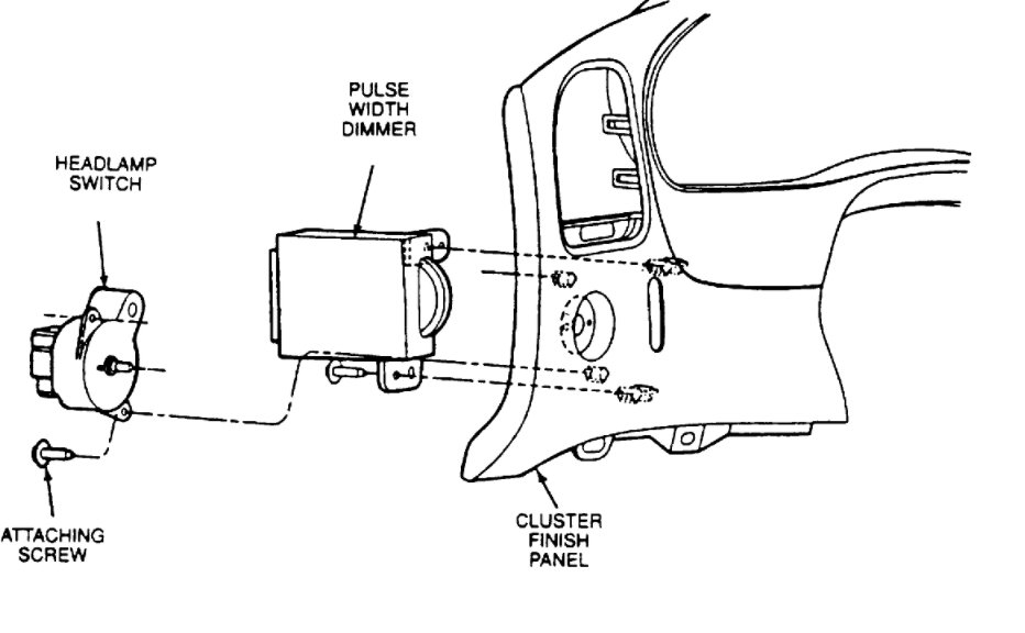

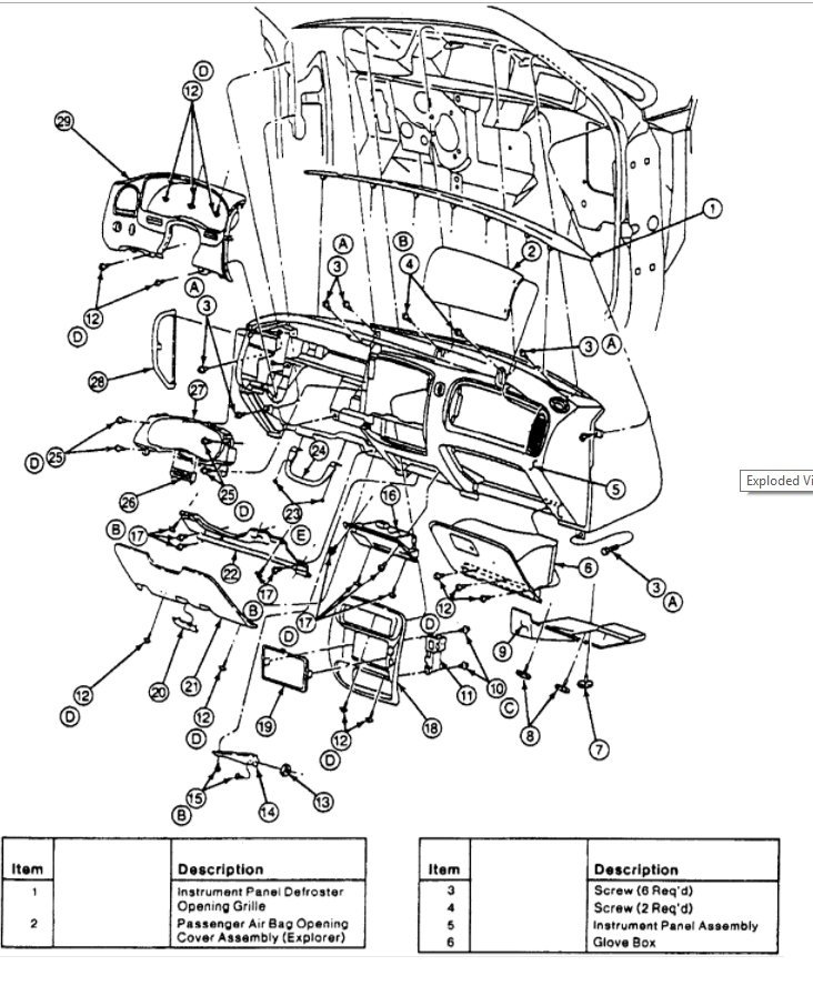

Replace or test? How to replace headlight switch? Running lights and dash not working. Headlight switch install.
Jun 11, 2017 at 12:02 AM
  • 55,433 POSTS
Here are some head light wiring diagrams (below) and a guide to help you test the circuit. Also there is some pictures of how to remove the switch
