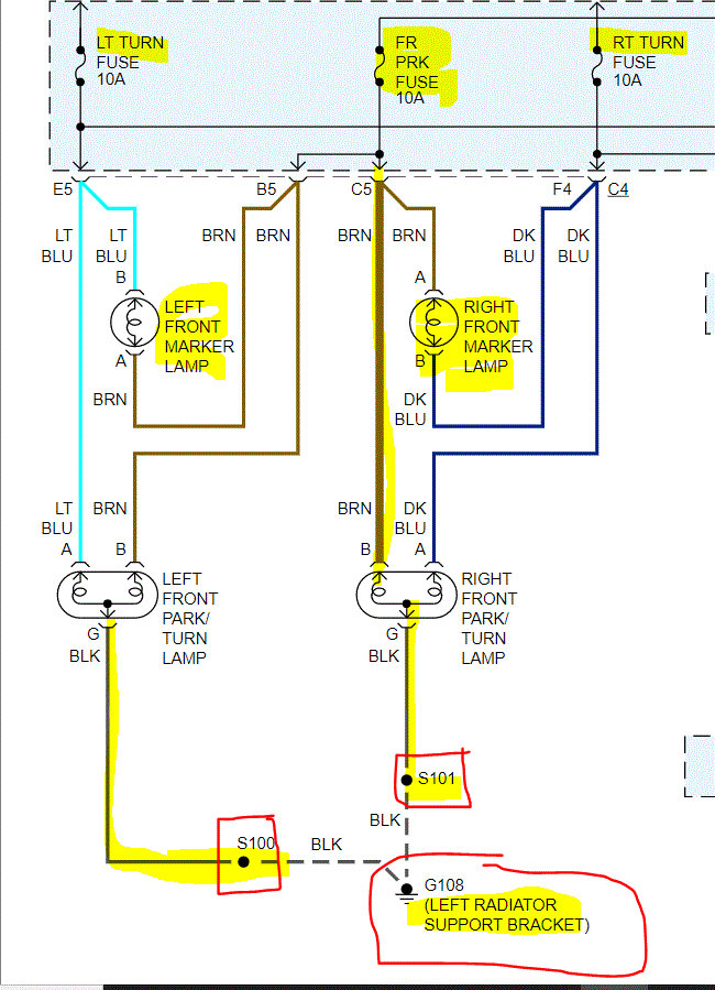

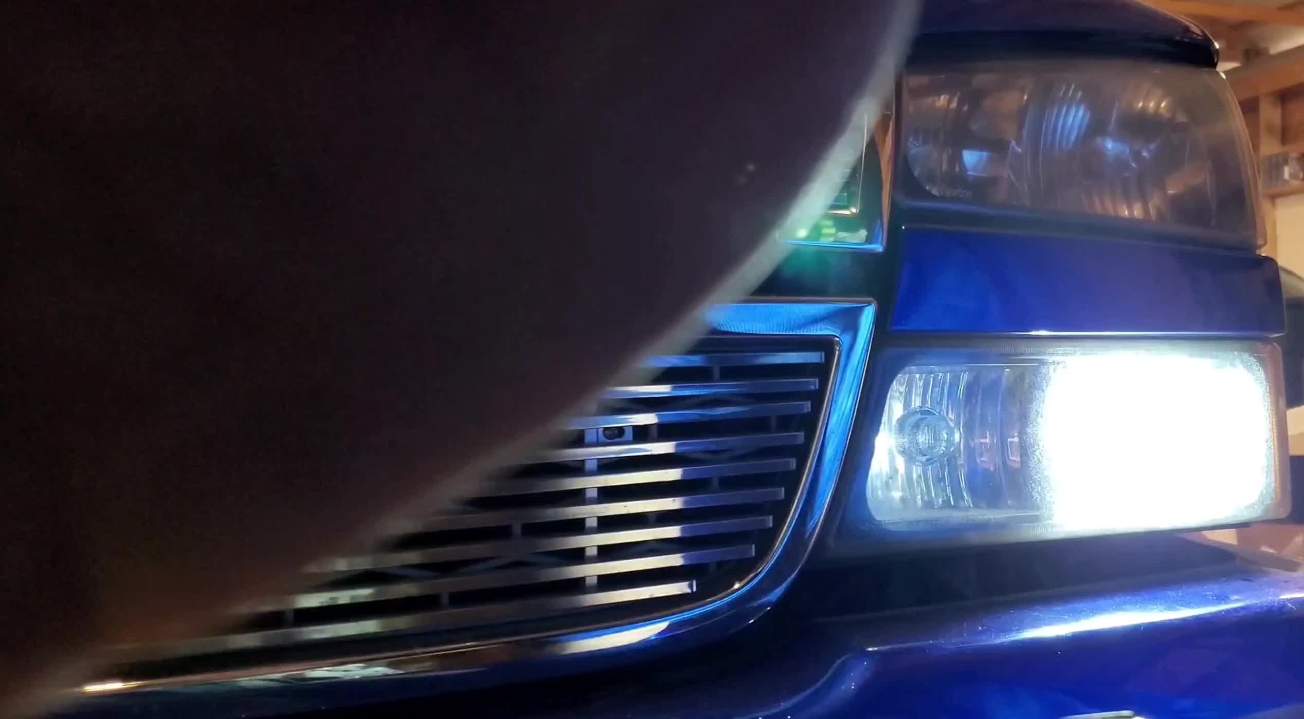

The truck is from down south so rust is a minimum. I have been using a lead wire with clips on each end to test grounds, so I have tried different places with the same results. If both power wires are hooked up like stock (parking and turn signal) the light is very dim or off. If I use only one or the other power wires and ground the other side of the socket it works with whatever power wire is attached (parking light or turn signal). The main parking light next to it works as it should. I have switchback LED in that one (parking lights up white, then amber when turn signal is on).
Is there a separate wire for the parking light and signal? I am not sure why connecting both power wires would cause a draw on power or dim the lights. And, if you disconnect one supply, the other works normally. Stupid question. If you have one of the power supplies disconnected and the opposite side working properly, if you turn the flasher on for the working side, do you get turn signal power to the unplugged side wire? If you connect your test light, do the lights dim?
At this point, the best I can suggest is to start tracing the two power wires and see where they end. Hopefully, Ken will have a few suggestions. Wow, I have never had so much trouble with lights. LOL They are usually easy. LOL

There is a separate wire for both. This is a normal 194 socket. I have read that it is called something like a floating ground. This is a typical GM parking light setup. If I disconnect one side or the other I have to hook the unused wire to ground. So therefore I have to make a positive and ground for it to work correctly, but again the positive side can only be either parking or signal.

Have you been able to make any progress? Ken should be in touch soon. As far as the ground, yes, there are two grounds for four different lights. Current goes one way or the other to complete a circuit.

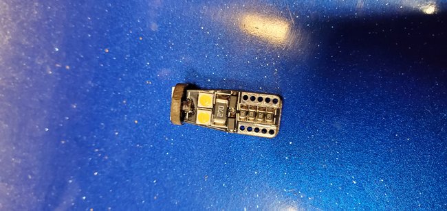

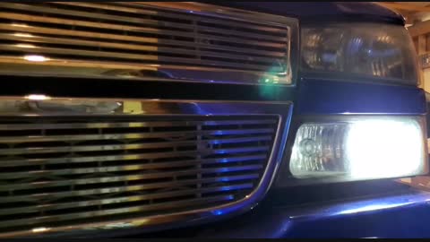

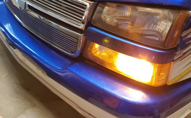

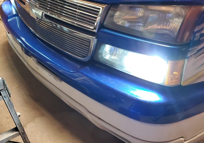

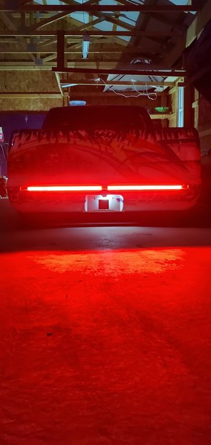

Not sure how this is different than what I have. Please remember this is a custom truck and it has a newer front end on it. It's been converted to a cat eye Silverado HD (2005 ish}. I included a couple pic's of what I have so you can try to get an idea of what I'm doing. Yellow is turn signal, white is parking light. Picture of rear is taillights. Led bulb is the current corner bulbs I'm using. For some reason I can't get the videos to upload as a video.
Jun 6, 2021 at 2:09 PM
Does that bulb have a built-in resister? It looks like it may. If not, the only other thing I can think of is to switch them with ones like I sent you. There is a place online that may help with this. It's called HIDnation. Have you ever checked their site?
Jun 7, 2021 at 12:56 PM
It does not have a built-in resistor. I have seen their website before and I also checked it when you sent me the link. It doesn't appear that the bulb they show is anything special, if anything maybe a little dated (I have ran similar before). I may just call it quits and either leave them out and see if it passes inspection, maybe try something else, or just go back to factory.
