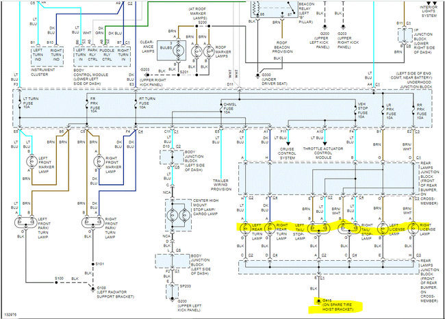

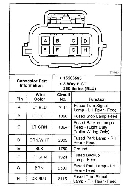

I am working on a custom truck that has had the taillights shaved. When they did this they removed the tail light wiring harness and junction box. I'm trying to wire in custom lights (led strip) and the problem I'm having is all the wiring shows me to wire everything to the left side. If I do this I'm getting brake lights or left turn signal but not both. If I run a jumper wire to make both work it is back feeding to the dash turning on the turn signal indicator light and an odd buzz.
May 21, 2021 at 7:52 PM
  • 110,190 POSTS
If it is back feeding, you likely have a ground issue. Power will find the easiest way to ground.

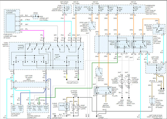

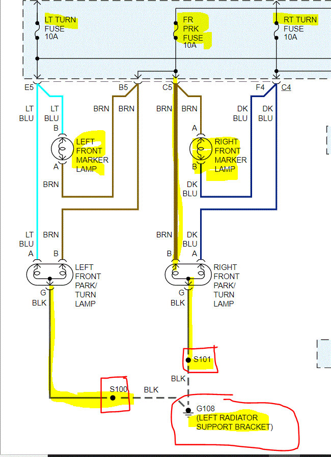

If you look below, I attached the exterior lighting schematic. I highlighted the right side lights and ground. Make sure the ground is good.
Here is a link you may find helpful when testing:

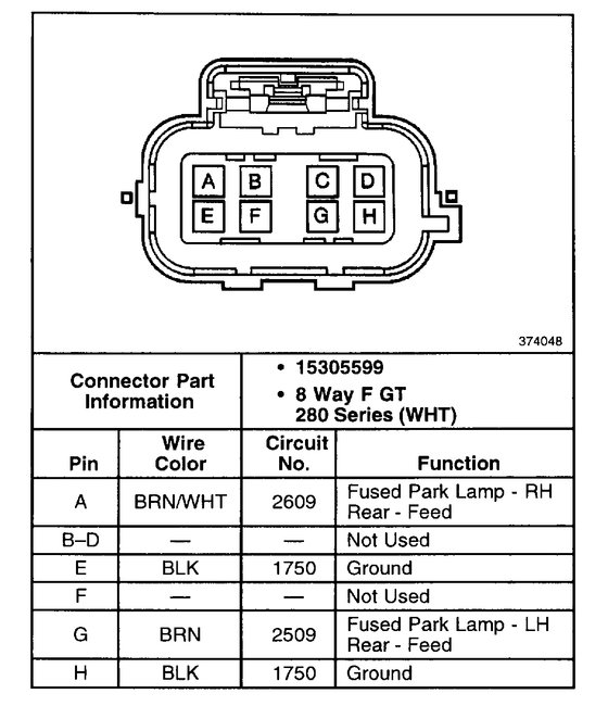

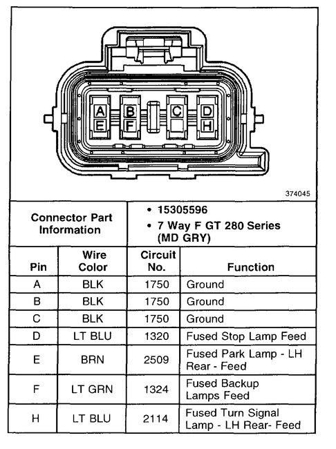

See pics below. Note: I had to cut the pic in half to make them readable. I did overlap them so you can follow from one to the next.

Have you checked all grounds? For it to back feed to the signal indicators in the vehicle, power is looking for a ground.

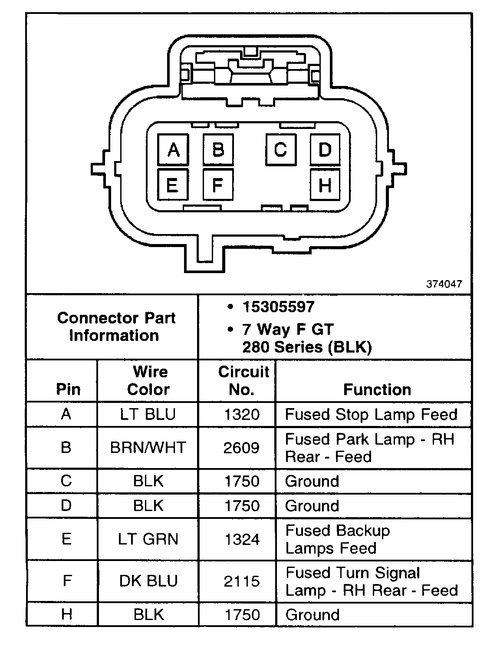

Do you happen to have a wiring diagram for the plug that would plug into the junction box from the front of the truck?
May 23, 2021 at 7:28 PM
  • 110,190 POSTS

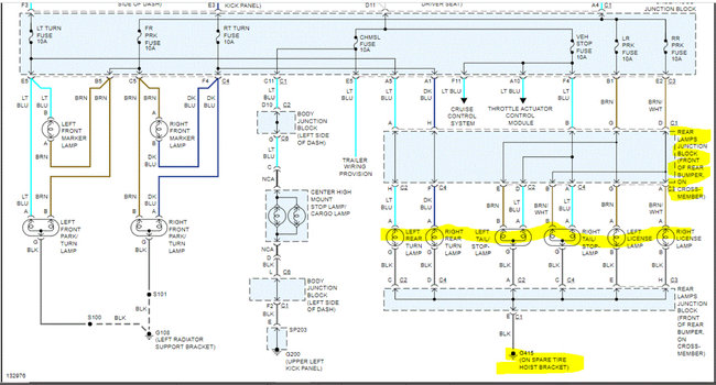

The junction is seen in pic 1 below. I attached all the rear lighting connections and legends for your review.
Let me know if this helps. Also, (and this is an afterthought), I wonder if the vehicle came with factory trailer wiring. Something could be happening there allowing power to back feed.
It's just a thought.

Thank you, those pin outs may help. I have only used a test light so far to verify wiring. Without having the rear harness in not certain if it had factory trailer wiring. This truck did have an older LED bar on it before but it no longer works correctly. So no idea if it was ever installed correctly.

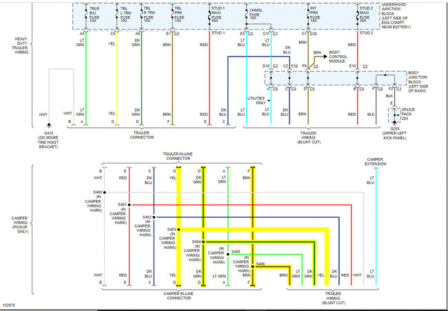

As far as finding the trailer wiring, I suspect (but can't be 100% sure) that is where the problem is coming from. Ugh!!! I wish I could see exactly what has been done. LOL
Do me a favor. Have a helper go through all the lights with you. At the trailer wiring harness, check which wires are getting power based on what is being requested.

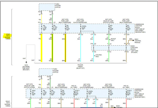

I attached the wiring schematics for the trailer wiring harness. Check to see if things match up. Also, note that the signals and parking lights should be powered from two different sources. One other thing. Do the hazards flash when you have the parking lights on?
Focus on the yellow, dark green, and brown wires in the harness.

Okay, you will have two wires showing power, but it still grounds through the front park/signal lamp.
Take a look below. I highlighted the things to identify them. Ground goes from those marker lights to the front park/signal lights and then to ground on the left rad support bracket.
I have a very strong feeling either one or two things are happening. Either the ground at the rad support is weak and fails under the extra load, or the splices are bad.
Just for the heck of it, run a good ground for both front signal/park lights. That will indirectly create a new ground for the side markers. If the same problem happens, then it has to be the splices.
Also, if you want to try this. Remove one of the 194 and see if the system does the same thing. Do it on both sides. If it is a splice problem, it should only happen when one of the bulbs is plugged in. In other words, if the left side is the problem, the right side and all lights should work normally when the left bulb is out. That will reduce the load on that splice.
Let me know. I know this may sound crazy, but wiring in and of itself can drive anyone crazy. Hang in there. You are doing a great job.

Okay, so I went out and checked the ground and it is working good. I went as far as cutting the marker light out and wired it to a different ground that I ran and if I hook up one wire or the other (turn or parking) and ground the other side of the socket I get the bulb to work. But it's only one or the other not both.
