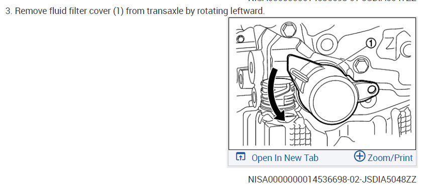

This car has the CVT transmission which they have had problems with. Can I ask if you hear any strange sounds coming from it? Also, do you have the check engine light on? If so, let's run the codes to see if any are stored.

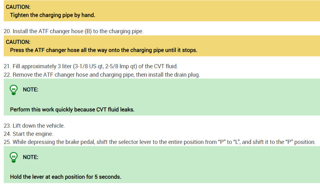

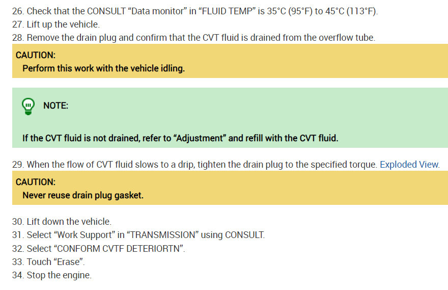

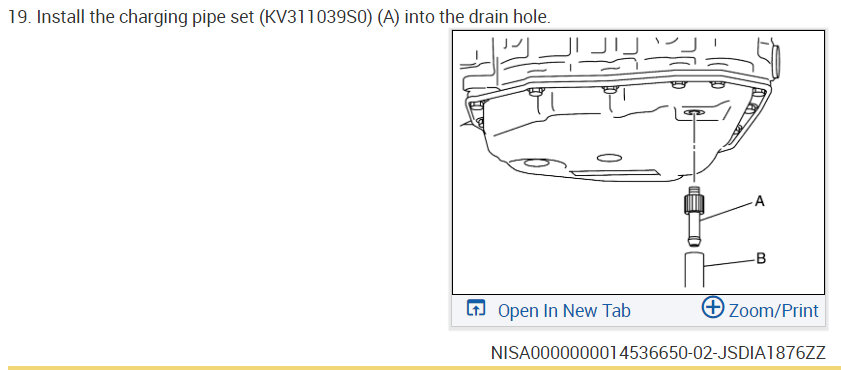

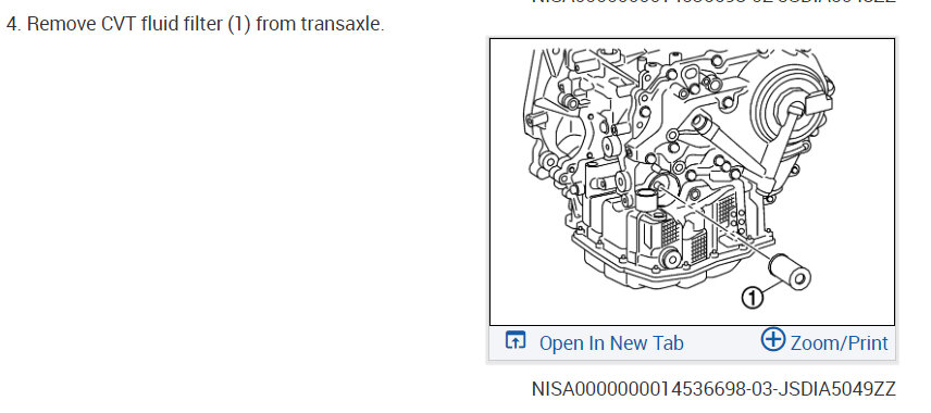

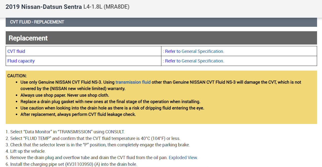

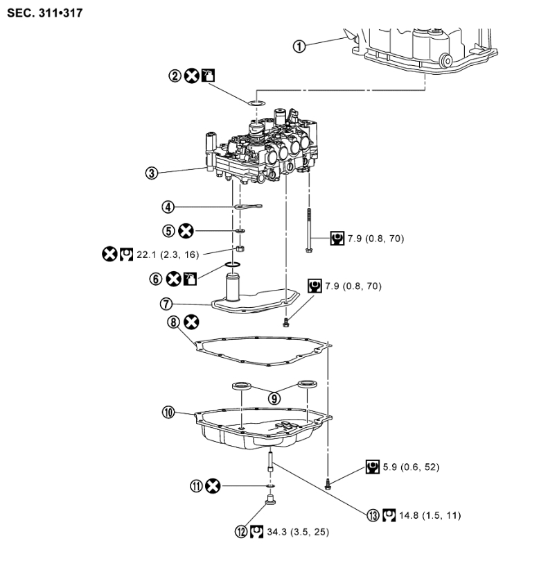

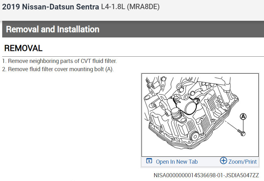

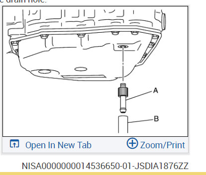

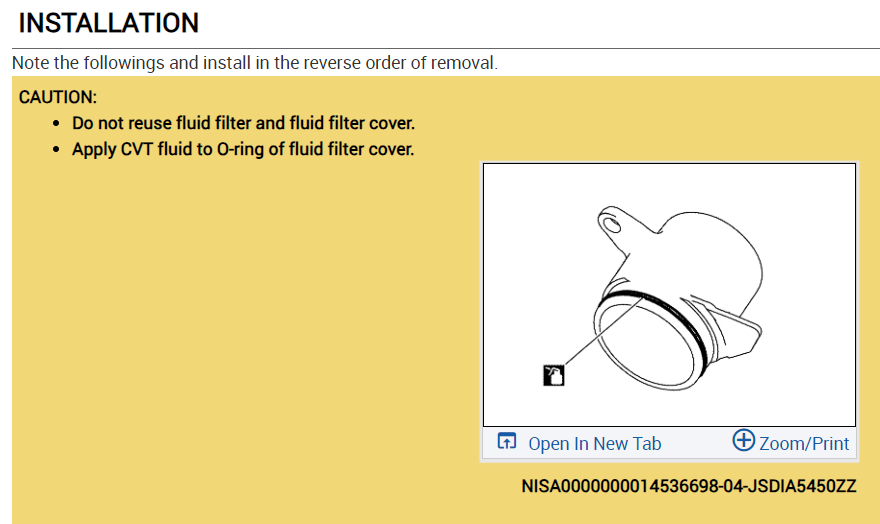

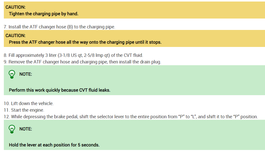

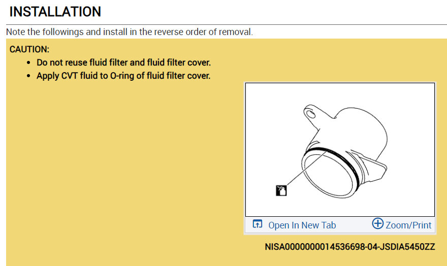

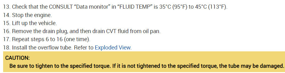

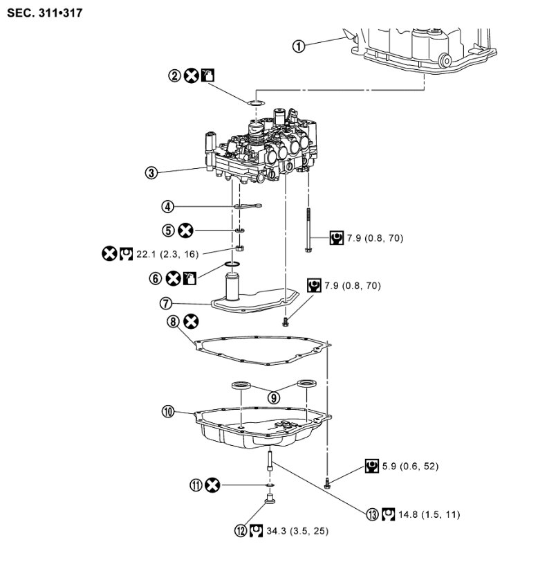

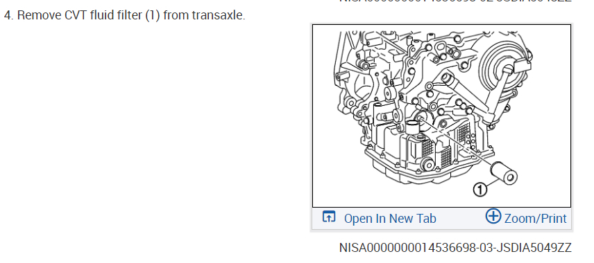

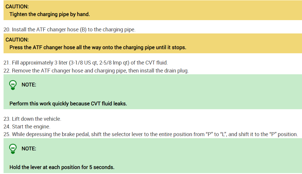

I don't see the brake light having a sensor for the bulb out warning but it does report to the BCM. I don't think that would affect the transmission, but you never know. I would service the transmission and filter while checking the condition of the old fluid (burnt). Here is how the job is done so you can see what needs to be done.
