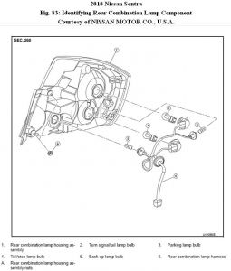

how do you chnage the brake light on the nissan sentra? do you go from the inside of the trunk or pop out the light?

Hi sarahrose22, You need to remove the rear combination lamp to replace the bulbs. REAR COMBINATION LAMP Component
https://images.2carpros.com/forum/automotive_pictures/192750_RearCombinationLamp10SentraFig83_1.jpg
Bulb Replacement REMOVAL 1. Remove the rear combination lamp. Refer to "REMOVAL AND INSTALLATION". 2. Turn the bulb socket counterclockwise and unlock it. 3. Remove the bulb. INSTALLATION Installation is in the reverse order of removal. Removal and Installation REMOVAL 1. Remove the luggage compartment side finisher. 2. Detach the harness clips and remove rear combination lamp housing assembly nuts. 3. Pull the rear combination lamp toward the rear of the vehicle. 4. Disconnect rear combination lamp connector, and remove rear combination lamp. INSTALLATION Installation is in the reverse order of removal.
