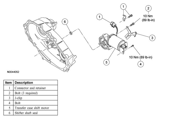

When I shift into four wheel low I hear a small clunking sound. I had it checked at a Ford dealer and they tried a used transfer case but it had the same problem. They told me they had several other rangers with the same problem and could not find an answer. I told them I shifted into four wheel low by stopping and putting it in neutral or park and was told they did the same thing with the same problem.The problem continues.

I do not specifically know about your truck, but with most 4x4's, shifting into four low is going to make some noise. Mine makes a little whirring sound, then a clunk. They will also jerk just a little bit. It is pretty normal. But unless you are pulling a car out of a mud pit, there is really no reason to use four low. four high should do whatever it is you are doing.

Four wheel low uses a different part of the actuator. I would start by replacing it because this part goes out sometimes. Below is a guide to help you see what to do. Also, if you could please take a quick video of the noise using your phone so we can hear and upload it to the site that would be great.

Replacing the actuator fixed my 99 ranger, would sometimes to in 4 wheel or not. Hardest part was repinning the actuator plug, my actuator wires are split to two different plugs. But is quite doable.
