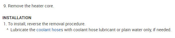

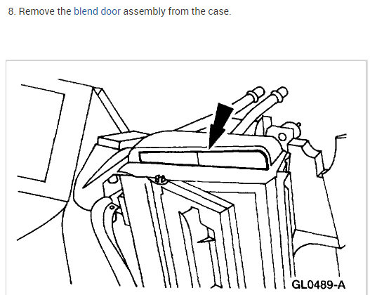

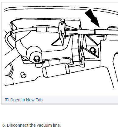

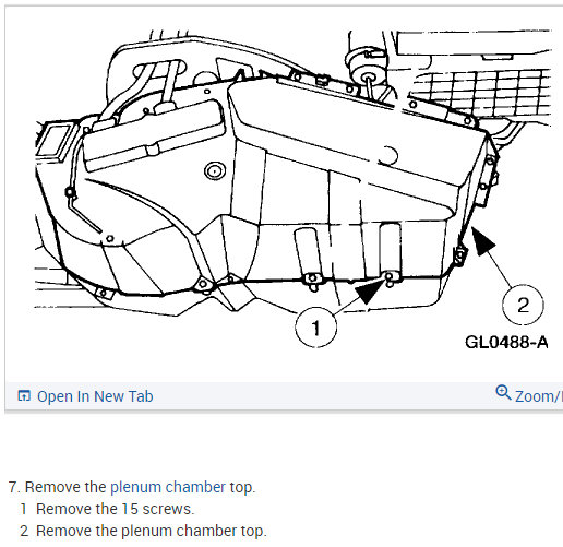

I smell a some what sweet smell coming from my vents when I turn on the heat. It could possibly be antifreeze not sure. but it do give me a headache and irritate my throat. I do get heat and air no problem.
Apr 4, 2017 at 6:32 AM
DANNY L
  • 5,648 POSTS
Hello, I'm Danny.

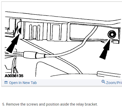

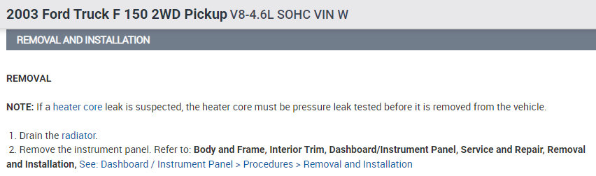

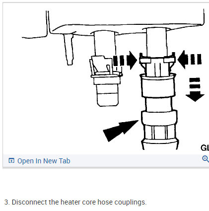

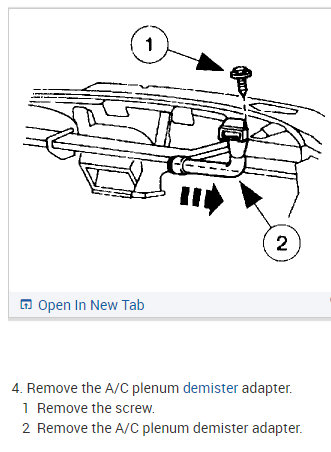

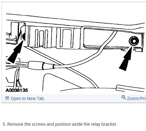

Here is the information you requested. Yes, The smell could be your heater core leaking. This is a tutorial showing how to replace a heater core.
https://www.2carpros.com/articles/replace-heater-core
Below I've attached the picture replacement steps of the heater core for your truck. Hope this helps and thanks for using 2CarPros.
