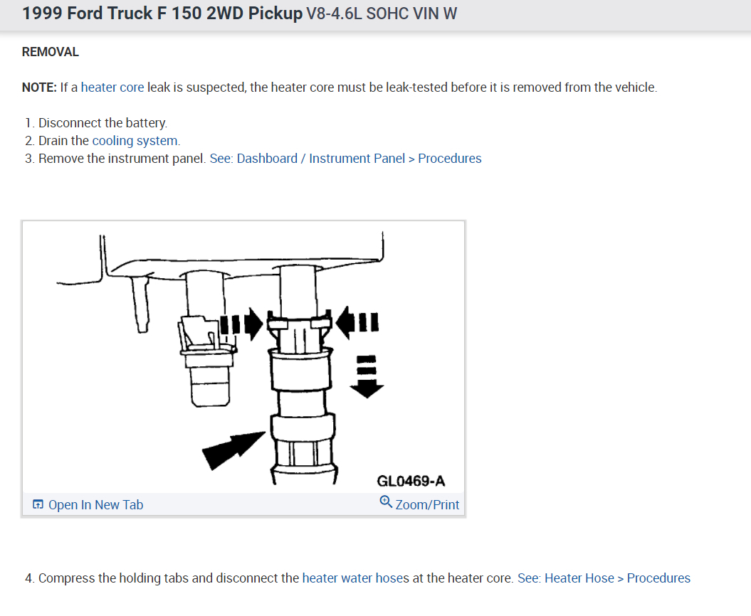

I am trying to access the heater core

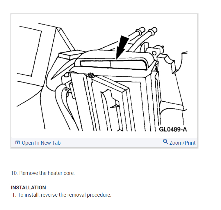

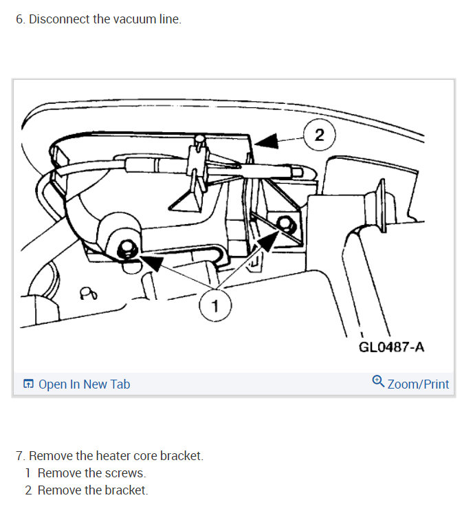

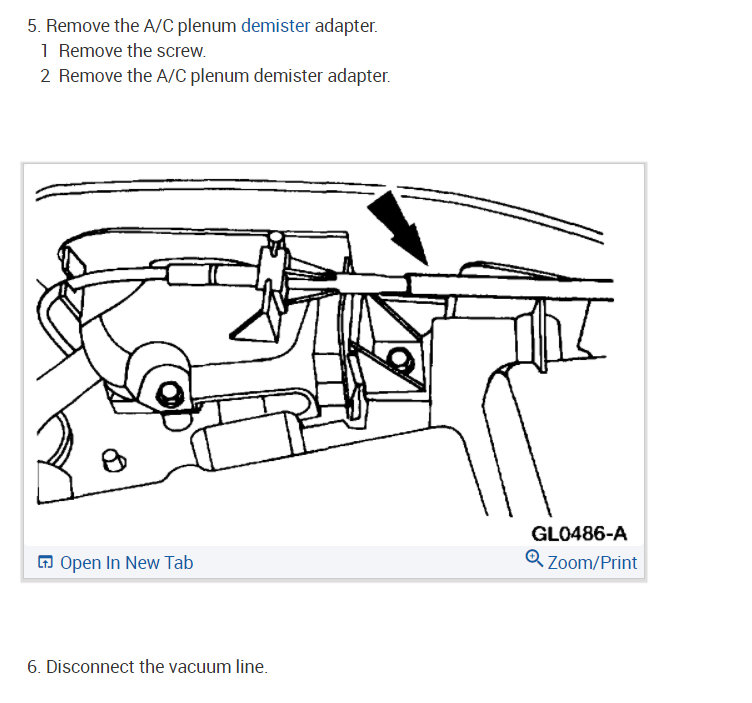

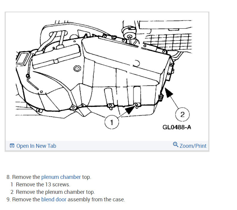

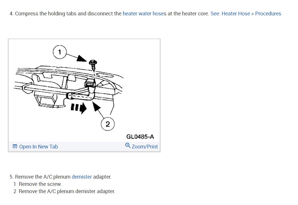

I have the same problem as another member I read about on your site. I am trying to access the heater core and am finding it very tough to remove the dash in order to do this. I have been unsuccessful in finding any drawings that would indicate key bolts or screws. Where might I be able to obtain this information?
Saturday, January 26th, 2008 AT 1:57 PM
2CARPRO JACK
  • 11,533 POSTS
Here is what you need to replace the core. Check out the diagrams (Below). Please let us know what happens.
