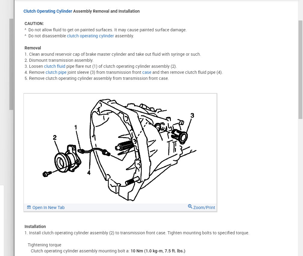

replaced clutch master cylinder and 6 weeks later problem re occurred - lost clutch pedal
Jan 31, 2010 at 1:52 PM
More than likely this is just a failed replacement part, or the issue was misdiagnosed. Unfortunately, this happens pretty frequently.
https://www.2carpros.com/articles/clutch-doesnt-work-sometimes-or-not-at-all
https://www.2carpros.com/articles/throw-out-bearing-replacement
More than likely this is a slave cylinder issue and not necessarily the master cylinder.

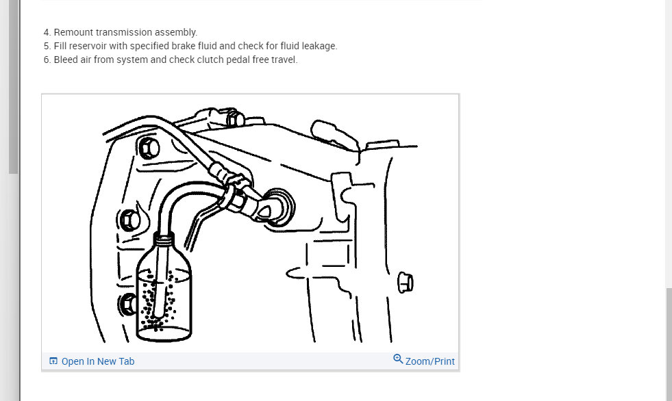

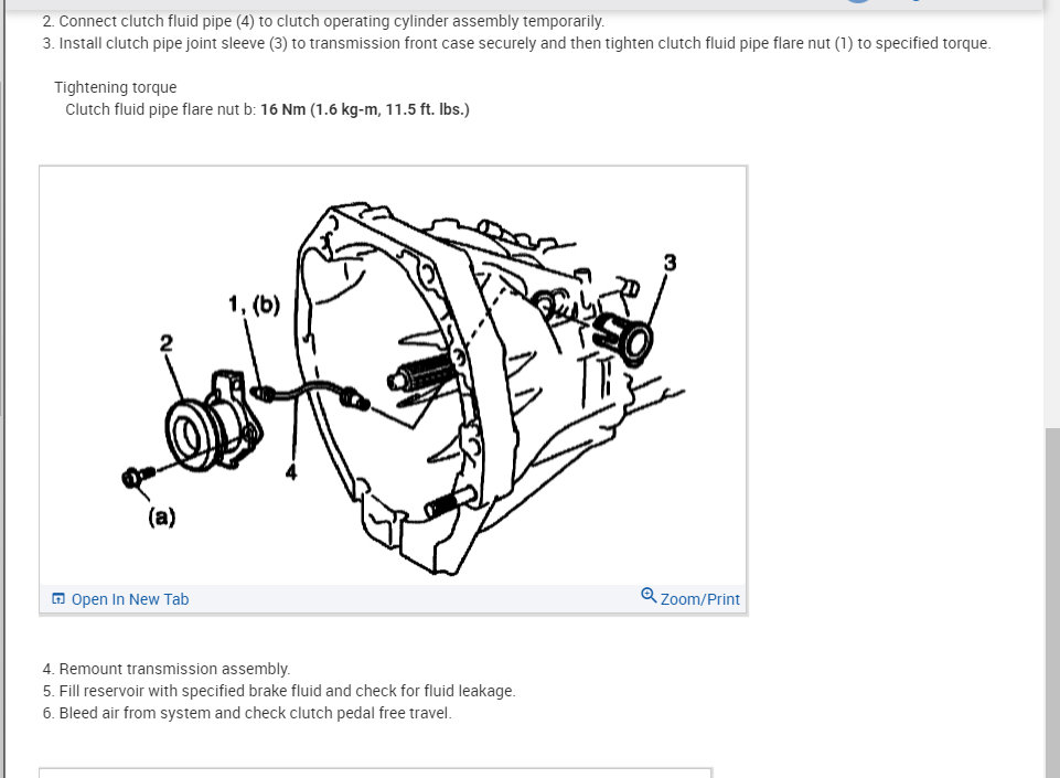

So, I am attaching the process for this but basically, we need to inspect it and look for leaks. If there are any visible leaks, then it has failed.
I suspect the slave is leaking and after the master replacement the system was filled and bled and then it lasted a short time and failed again because you still have the leaking slave.
If it were me, I would suggest taking it apart and inspecting this and go from there.
Please let us know what you find. Thanks
