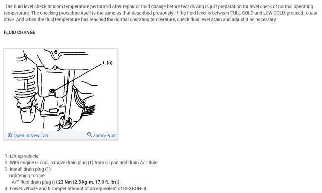

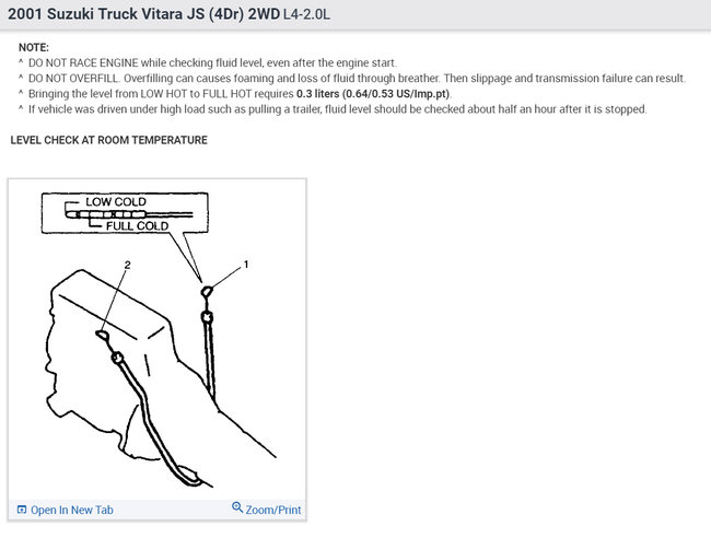

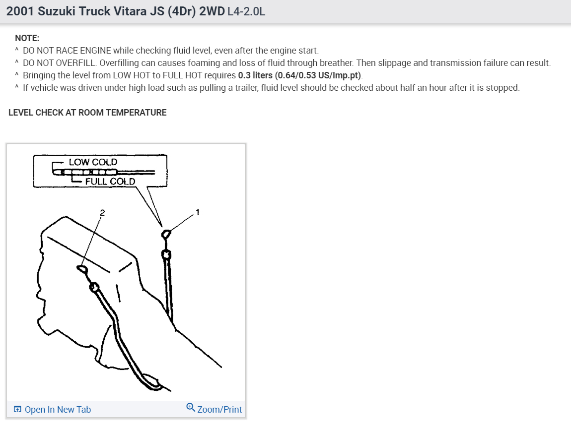

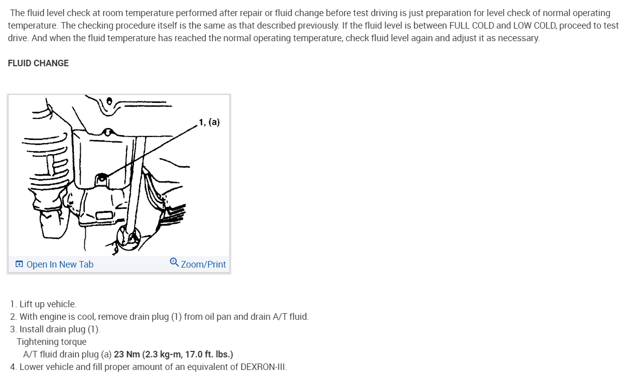

How can I service my automatic transmission?

Here is a guide to help walk you through the steps with instruction and diagrams below to show you on your car.
