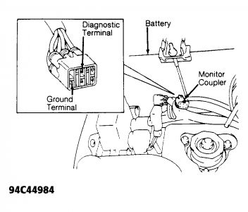

Is there a way to check what code is lighting up the Check engine light without going to someone with a scanner?

RETRIEVING CODES Fig. 1: Typical Code Display (Code 21 Is Shown) Courtesy of SUZUKI OF AMERICA CORP. Ensure Malfunction Indicator Light (MIL) (also known as CHECK ENGINE light) comes on when ignition is on and engine is not running. When engine is started, light should go off. If light remains on while engine is running, a trouble code is present. If light does not come on with key on and engine off, check MIL circuit before continuing. See CHART A-1 and CHART A-2 under CODE CHARTS for MIL diagnosis. If light operates and a no start condition exists, see CHART A-3 under CODE CHARTS. To retrieve codes, locate monitor coupler connector, near battery. Using a jumper wire, connect diagnostic terminal to ground terminal. See Fig. 2 . Fig. 2: Identifying Diagnostic Terminals Courtesy of SUZUKI OF AMERICA CORP. For example, Code 21 is identified by a flash, flash, pause and flash. See Fig. 1 . Each code is displayed 3 times, and then the next code is flashed. If engine control system is operating properly (with no faults), a Code 12 should exist with ignition on and engine off. This indicates diagnostic system is capable of storing codes. Ensure engine is in sound mechanical condition. Once all codes are displayed, record codes and proceed to CODE CHARTS for repair procedure. Remove jumper wire from diagnostic terminal. After repairs, erase codes by disconnecting battery cable for 60 seconds. Repeat code retrieval procedure to check for new or returning trouble codes.
