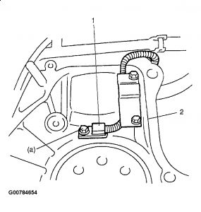

Crankshaft Position (CKP) Sensor Removal and Installation Removal Remove engine with transmission from vehicle referring to ENGINE ASSEMBLY REMOVAL AND INSTALLATION . Remove transmission from engine and then remove flywheel or drive plate from crankshaft. Disconnect connector from crankshaft position sensor. Remove crankshaft position sensor (1) from cylinder block (2). Installation Reverse removal procedure noting the following. Check to make sure that crankshaft position sensor (1) is free from any metal particles and damage. Apply engine oil to O-ring of sensor. Install crankshaft position sensor to cylinder block (2) with specified torque. Tightening torque Crankshaft position sensor bolt (a): 6 N.m (0.6 kg-m, 4.5 Lb-ft) Fig. 28: Installing Crankshaft Position Sensor To Cylinder Block Courtesy of SUZUKI OF AMERICA CORP.
https://images.2carpros.com/forum/automotive_pictures/266999_suz_7.jpg
Connect connector and fix wire harness with clamp securely.
