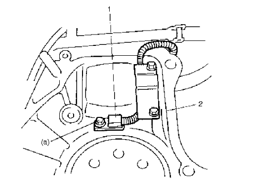

Where is the crankshaft sensor located?
Mar 8, 2010 at 12:29 AM
DAVE H
  • 13,384 POSTS
You are not going to like this. It looks like they put it behind the flywheel, requires engine removal for replacement. Here is a video of what you need to do to change it also, See the diagram below for the sensor location.

Remove the transmission the crankshaft position sensor is behind the flywheel

First you need to remove the engine or transmission it is in between them you cannot get to it without taking one of those two out.

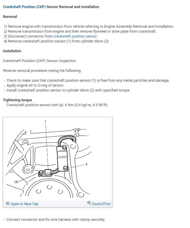

Yep unbelievable! Have to remove the engine or transmission. I would fire the design team who made this.
Removal
Remove engine with transmission from vehicle.
Remove transmission from engine and then remove flywheel or drive plate from crankshaft.
Disconnect connector from crankshaft position sensor.
Remove crankshaft position sensor (1) from cylinder block (2).
Installation
Reverse removal procedure noting the following.
Check to make sure that crankshaft position sensor (1) is free from any metal particles and damage.
Apply engine oil to o-ring of sensor.
Install crankshaft position sensor to cylinder block (2) with specified torque.
Tightening torque
Crankshaft position sensor bolt a: 6 N.m (0.6 kg-m, 4.5 lb-ft)
Connect connector and fix wire harness with clamp securely.
