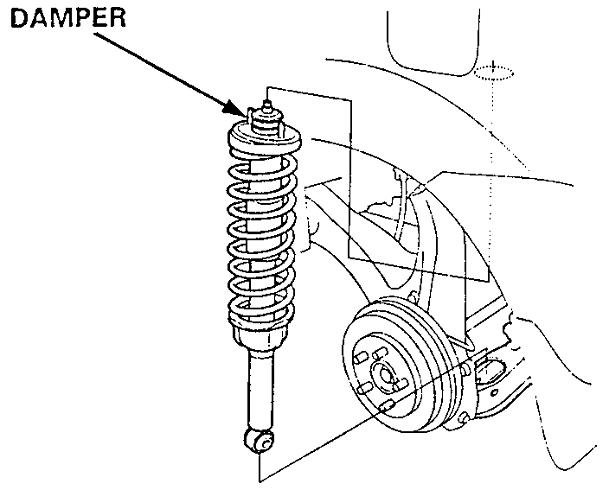

Given the age of your vehicle, the common suspects are worn struts and weak coil springs. The sagged springs let the vehicle sit too low, and worn struts allow too much bouncing, and excessive wheel movement when you drive over bumps in the road.
Where I would start is by visiting any independent repair shop and ask to look at their small book that lists every car model and year, then shows where to take the ride height measurements, and what they should be. I'm sorry that I can't find that information in my online service manuals. If you find ride height is too low, my recommendation is to replace the coil springs and struts as an assembly. They come already assembled with new upper mounting plates, (another wear item), and new dust boots. These go on real quickly and easily, and you won't need the dangerous strut compressor. In fact, these coil springs are so small and stiff that the cheap do-it-yourselfer spring compressor tools won't work. With the new assemblies, you'll pay just a little extra for the parts, but you'll save a real lot of time and you'll be safer.

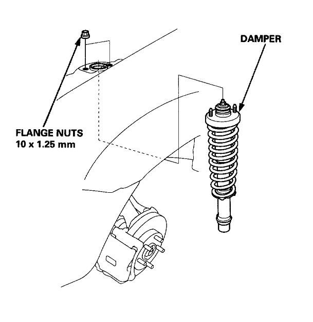

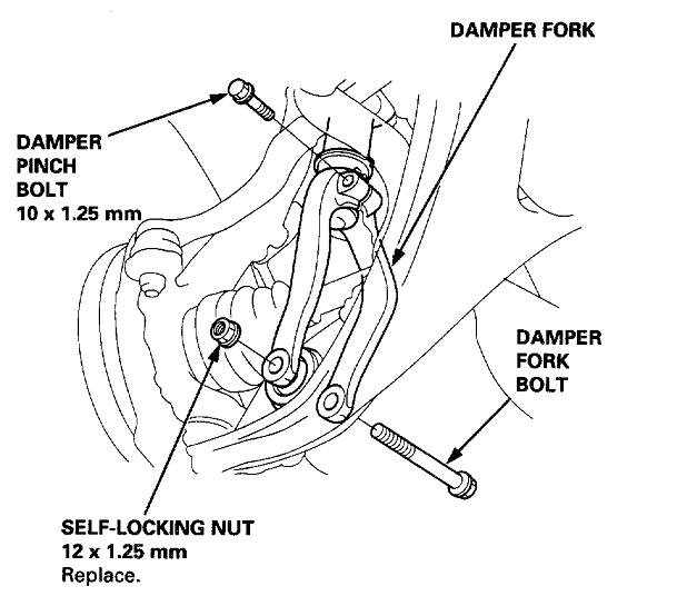

If you want to do this yourself, to replace a front strut assembly:
Removal
1. Remove the front wheels.
2. Remove the damper pinch bolt from the top of the damper fork.
3. Remove the damper fork bolt and self-locking nut from the bottom of the damper fork, then remove the damper fork.
4. Remove the damper by removing the two flange nuts.

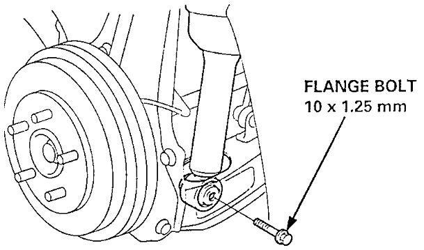

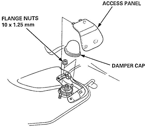

To replace a rear strut assembly:
REMOVAL
1. Remove the rear wheels.
2. Remove the damper access panel and the damper cap.
3. Remove the two flange nuts.
4. Remove the flange bolts.
5. Lower the rear suspension, and remove the rear damper.
