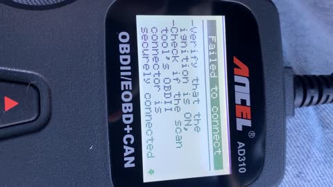

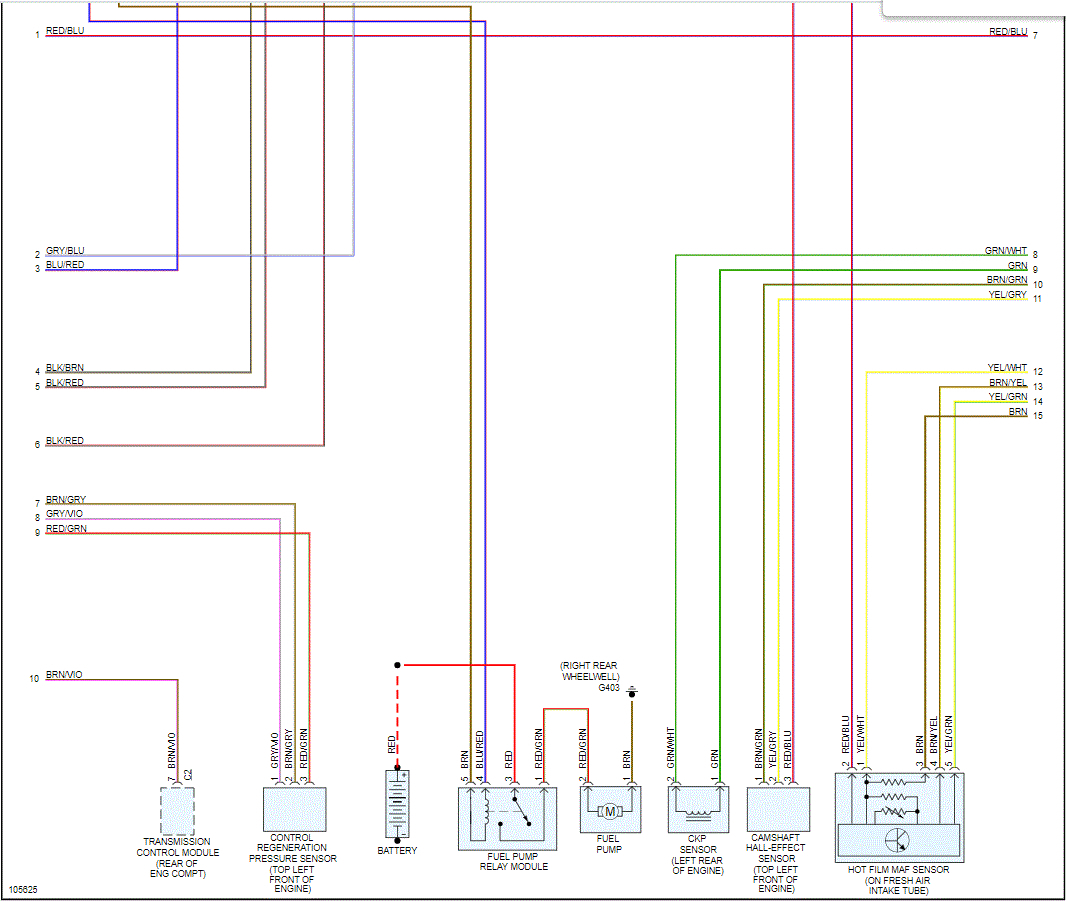

Hi, wife was driving the car. Suddenly engine stop, coasting to a stop. Try to restart, the starter has no cranking. All electrical works, gas is full, the battery is 2 years old. The car has been parked for a month in the driveway. I bought an ODB2 try to connect, device response "failure to connect" retry. Remove, reconnect, the same result. Tried OBD2 on an Odyssey van and it reads codes fine. This means the OBD2 is fine. What could be wrong with the C280? I am thinking: ECM failure so OBD cannot read. Could that cause the fuel pump and starter circuit to fail too? Thank you for your help. I thought I could read the code to see what system failed.

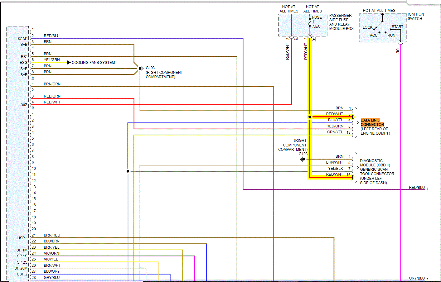

Does the scan tool power up when connected? If it doesn't, check pin 16 for power, It should be present at all times. Also, pin 4 should be the ground, so confirm there is continuity to ground at that pin.
If there is no power, check fuse 1 in the passenger side fuse box. In addition to checking the fuse, confirm there is power to and from it. Here is a link you may find helpful:

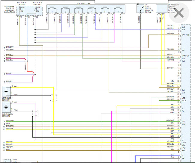

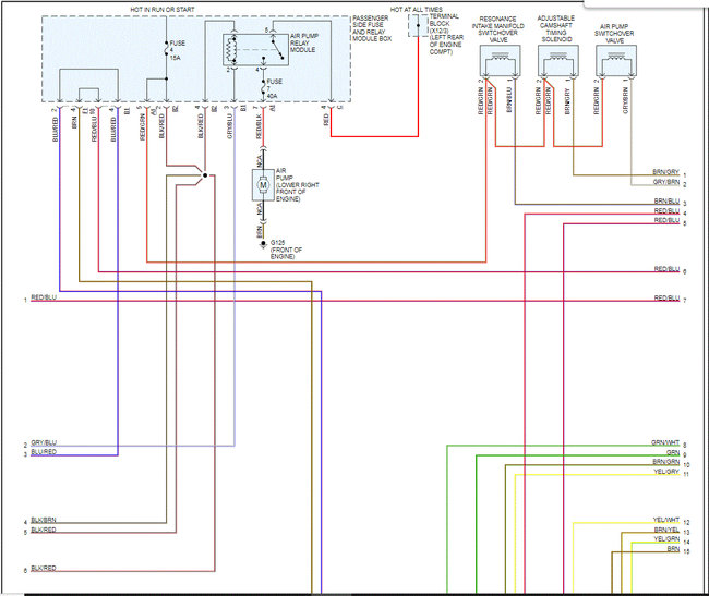

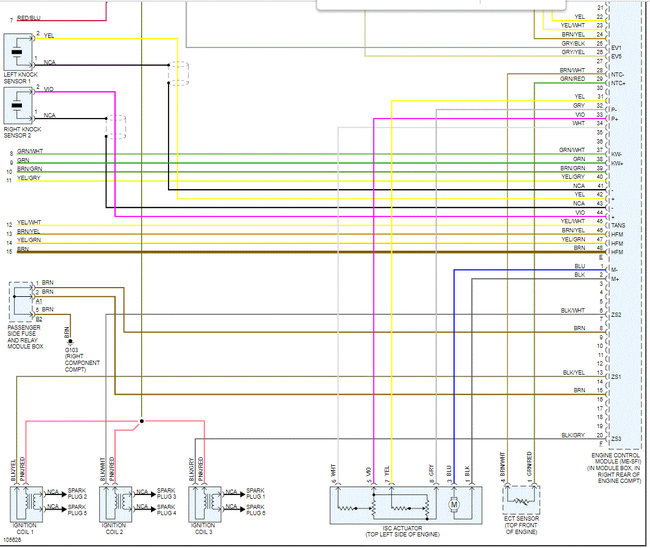

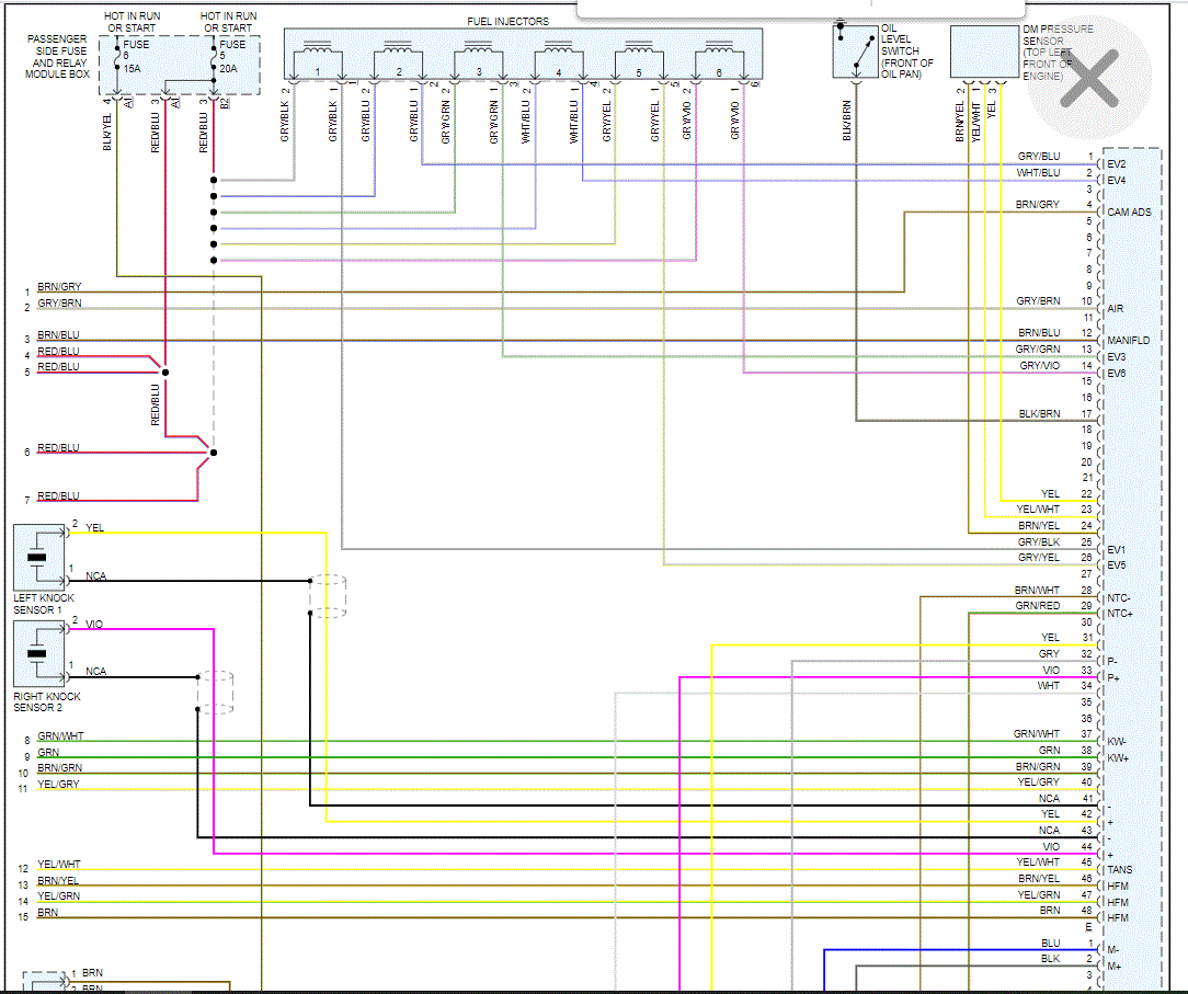

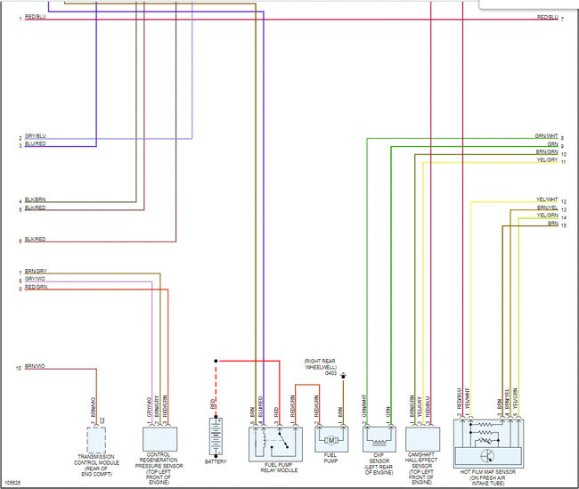

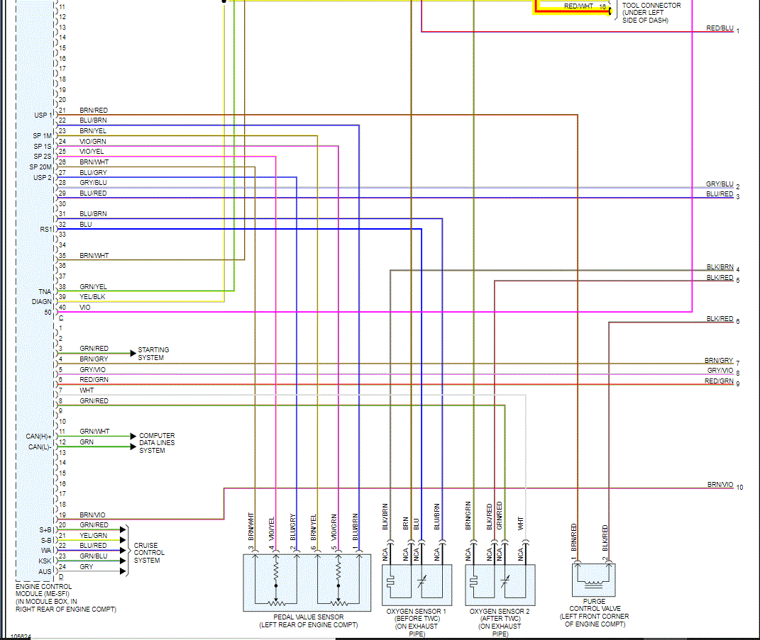

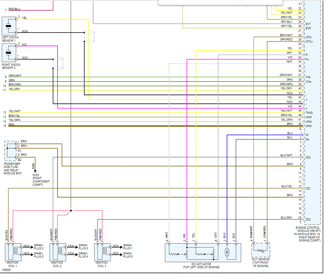

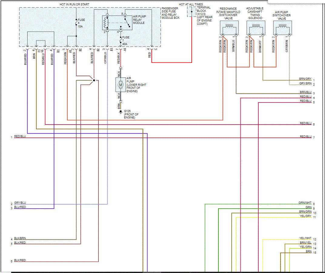

I attached the wiring schematics for the entire engine control system. I had to cut the pics in half, but I did overlap them so you can follow from one to the next. In the first pic below, I highlighted the DLC power supply and which fuse powers it.
May 16, 2021 at 12:28 PM

Thanks Joe, the obd2 has power when plug in and appears to attempt to connect, screen show black connecting bar moving then after 15 seconds failure message appears. I will check and update.

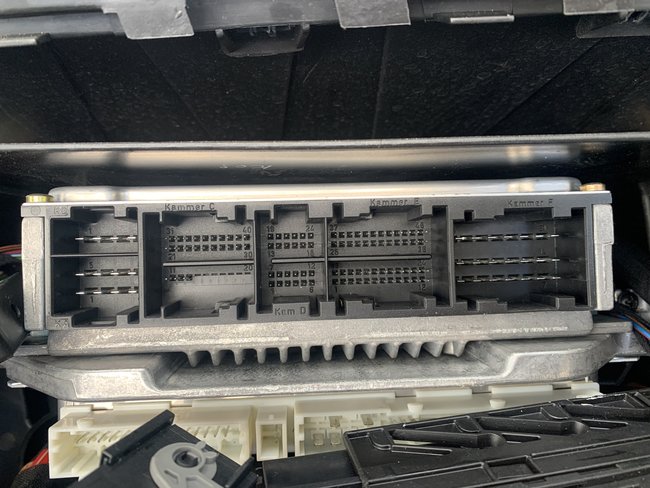

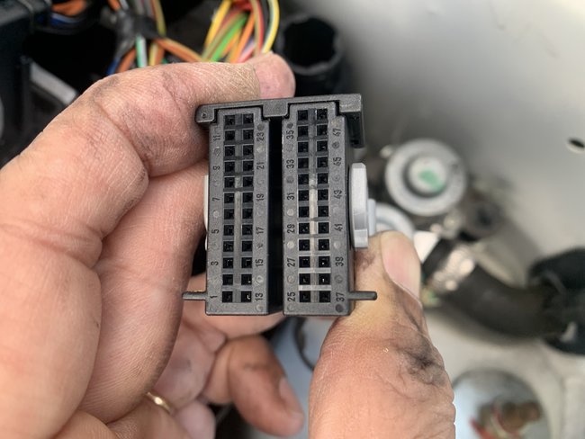

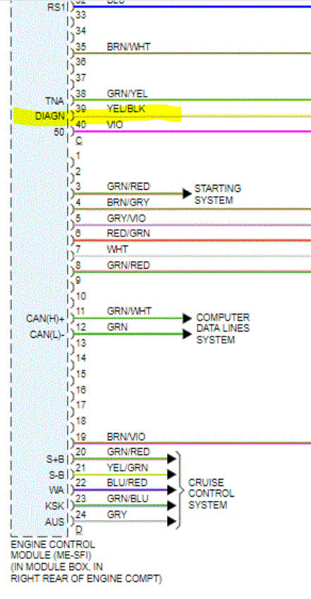

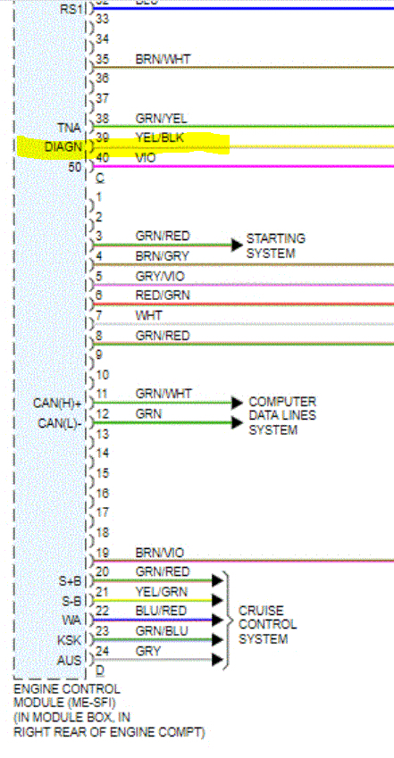

Disconnect the battery, locate a disconnect the ECU behind the engine. Check the pin connectors for corrosion or damage. Specifically, check pin 39. See pic below.
Let me know what you find.

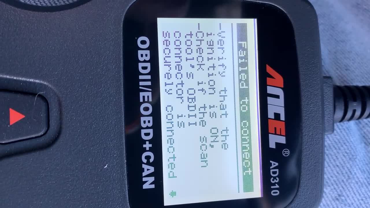

Hi Joe, I disconnect battery, pulled the ECU and ABS module and inspect them. All terminals and connectors/wires looks brand new. Pulled each and every one fuses in engine compartment and trunk, they are all good. Reconnect OBD 2 and still fail to connect . Took picture and video so you can see.

OBD2 connection failure.
