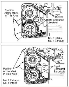

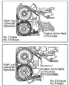

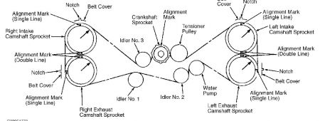

96 subaru leagacy wagon with 165,000 miles 2.5L I relaced the timing belt and put the new one in exactly how the book says but the car wont start it sounds like the timing is way off but im not sure. :Wink:

https://www.2carpros.com/forum/automotive_pictures/99387_sub_1.jpg
https://www.2carpros.com/forum/automotive_pictures/99387_sub1_1.jpg
Sunday, November 25th, 2007 AT 12:07 AM

https://www.2carpros.com/forum/automotive_pictures/99387_sub13_1.jpg
let me know if more needed
