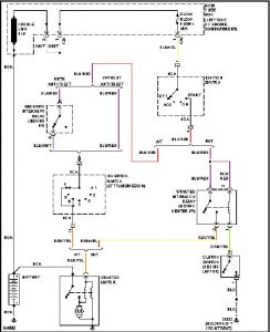

I have a 97 Subaru Outback, 2.5, 4cylinder motor, automatic transmission. For two years now, there are times when the car will not start (the radio and windows will work though). If you let it sit for anywhere from 5 to 15 minutes it will eventually start. Replaced the starter with NAPA starter - thought this starter was bad & replaced with another NAPA starter. Still at times it wouldn't start so we finally put on a Subaru starter. We are still having the same problem & replaced the battery. It seems to have the trouble more when the car & weather are hot - happens less often in the winter. The starter wires and battery cables were checked & good. Could there possibly be a sensor bad or is there a recall that we were not aware of. Any help would be greatly appreciated.

Hello !! Well the starting schematic shows that the relays and switches on the starting circuit are: the ignition switch, the starter interlock relay, the security anti-theft relay and the inhibitor switch (AT) Here the schematic:
https://images.2carpros.com/forum/automotive_pictures/576_subaru_97_1.jpg
I would start checking the starter interlock relay and the ignition switch (for intermitent fault) could be that the "heat" affect them on some way.. or the solder is weak and the temperature "expand it" and make it fail... Let us know and we will continue with the troubleshooting.. BTW; thanks a Lot for your donation! we appreciate that!

I assume the engine is not turning over.
For what it's worth the Subaru alternaters were a problem child. They would typically act up when hot. The alternater will show a charge that is good. But if you get the engine hot, and put a full acceory load on the alternater, the Alternater will fail at 1400 rpms.

I was in a hurry earlier when I wrote in. I forgot to include that the replacement battery is Mastercaft Titanium 640 cold cranking amps battery. Two days after the battery was replaced it wouldn't start again - sometimes it will eventually start, but it seems that more often than not it has to be jump started - it always jump starts when it won't start on its own. When you turn the key, the car doesn't turn over, most times you don't even hear the starter click. The lights, windows & stereo always work. Just wanted to make sure that this info wouldn't change what you suggested I check first (starter interlock relay & ignition switch). Thank you for your time & quick response.

[quote:47c46e198d="jdamian"]I was in a hurry earlier when I wrote in. I forgot to include that the replacement battery is Mastercaft Titanium 640 cold cranking amps battery. Two days after the battery was replaced it wouldn't start again - sometimes it will eventually start, but it seems that more often than not it has to be jump started - it always jump starts when it won't start on its own. When you turn the key, the car doesn't turn over, most times you don't even hear the starter click. The lights, windows & stereo always work. Just wanted to make sure that this info wouldn't change what you suggested I check first (starter interlock relay & ignition switch). Thank you for your time & quick response.[/quote:47c46e198d]
Hello again..
Well, if you have to jump-start to make it crank that change my mind..
I`m with Service Writer.. start checking the alternator..
I, also, hear about a problem with the subaru alternators..
they fail under load at high temp.
good luck and let us know!
