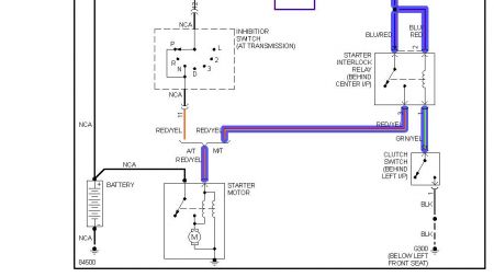

For the last couple weeks I've had issues starting my car. I'd keep turning the ignition and would hear the clicking of the starter solenoid but the starter motor didn't seem to turn. Eventually, it would turn and the engine would start. I went out and bought a new starter, but I didn't put it in. Yesterday, the same thing happened, but eventually I stopped hearing the click of the solenoid and I semeed to be low on juice from the battery. So, I thought I'd replace the starter and see if that fixed the problem.
So, after finally getting the starter swapped out with a new one, I'm still having the same problem. I'm getting nothing. I'm not hearing the solenoid click or anything. I am getting power from the battery and I even tried jumper cables to make sure. Still, I turn the key, my light don't dim, so I'm really not pulling any juice and the starter is doing nothing.
Please help, could it be some fusable link somewhere?

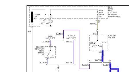

Look below and start at the fuse all the way down to the starter motor, determine your type of transmission and follow that circuit

I hope this isn't too dumb a question, but where is the fuse from the ignition to the starter. I have an automatic if that helps.

The fuse is located in the main fuse box left side of engine compartment. Slow blow fuse no.4 45amp

OK. The fuse and fusable link are intact and when I remove the fuse I get no power at all to the dash, lights, etc. So, at least that part is OK. Moving on, I assume there is some short or disconnected wire between my ignition switch and the solenoid. It would seem this is moving beyond my realm of ability/time and time to take it to a mechanic. Unless, of course, you can point out something obvious I should be checking.

Lets start at the clutch switch when key in start position one side of the switch should have power if so press the clutch in the other side should have power if not the switch is defective if there's no power at all the ignition switch is bad.

Since I have an automatic transmission, sorry I wasn't clear about that, I won't be able to test that way, right? Anyway, if I move the drive selector to any position, Part, Reverse, Neutral, etc, it acts exactly the same way. I have full power in the cabin and I actually do hear some stuff happening in the engine compartment, I assume the fuel pump, but nothing to the starter. No dimming lights like the starter is pulling any amps.
