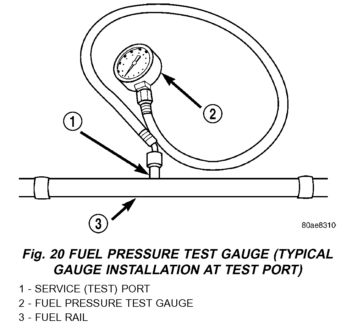

If the vehicle is running rich, the first thing I would check is fuel pressure. If it is too high due to a faulty fuel pressure regulator, it can cause this.
Let's start there. Here is a link that explains how to test fuel pressure:
Here are the directions specific to your vehicle. The attached pics correlate with these directions. Also, the manufacturer's specs are included in the directions.

Fig.20 Fuel Pressure Test Gauge (Typical Gauge Installation At Test Port)
pic 1
1. Remove protective cap at fuel rail test port. Connect the 0 - 414 kPa (0 - 60 psi) fuel pressure gauge (from gauge set 5069) to test port pressure fitting on fuel rail. The DRB III Scan Tool along with the PEP module, the 500 psi pressure transducer, and the transducer-to-test port adapter may also be used in place of the fuel pressure gauge.
2. Start and warm engine and note pressure gauge reading. Fuel pressure should be 339 + 34 kPa (49.2 + 5 psi) at idle.
3. If engine runs, but pressure is below 44.2 psi, check for a kinked fuel supply line somewhere between fuel rail and fuel pump module. If line is not kinked, but specifications for either the Fuel Pump Capacity, Fuel Pump Amperage or Fuel Pressure Leak Down Tests were not met, replace lower section of fuel pump module. Refer to Fuel Pump Module Removal/Installation.
4. If operating pressure is above 54.2 psi, electric fuel pump is okay, but fuel pressure regulator is defective. Replace lower section of fuel pump module. Refer to Fuel Pump Module Removal/Installation.
5. Install protective cap to fuel rail test port.

Just checked fuel pressure and its just below 60 PSI. so I guess I can rule out pump.
Dec 28, 2020 at 12:09 AM
  • 110,244 POSTS
I just read through the diagnostics. It indicates that if the pressure is above 54.2 (operating pressure) the pump is good, but the regulator is bad. Again, based on the specs, if you have 59 PSI, it's too high and is the likely cause of the rich fuel mixture.
Do me a favor. Take a look at number 4 in the diagnostics I sent. Are you above that pressure?
