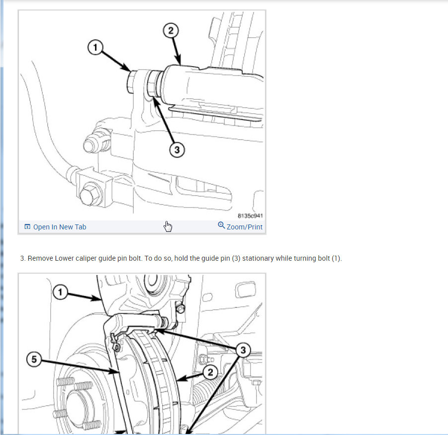

Can a stuck caliper pin cause brake squeal? The squealing was coming from the left front which is also the same side that had the stuck caliper pin?
Feb 17, 2018 at 7:03 PM

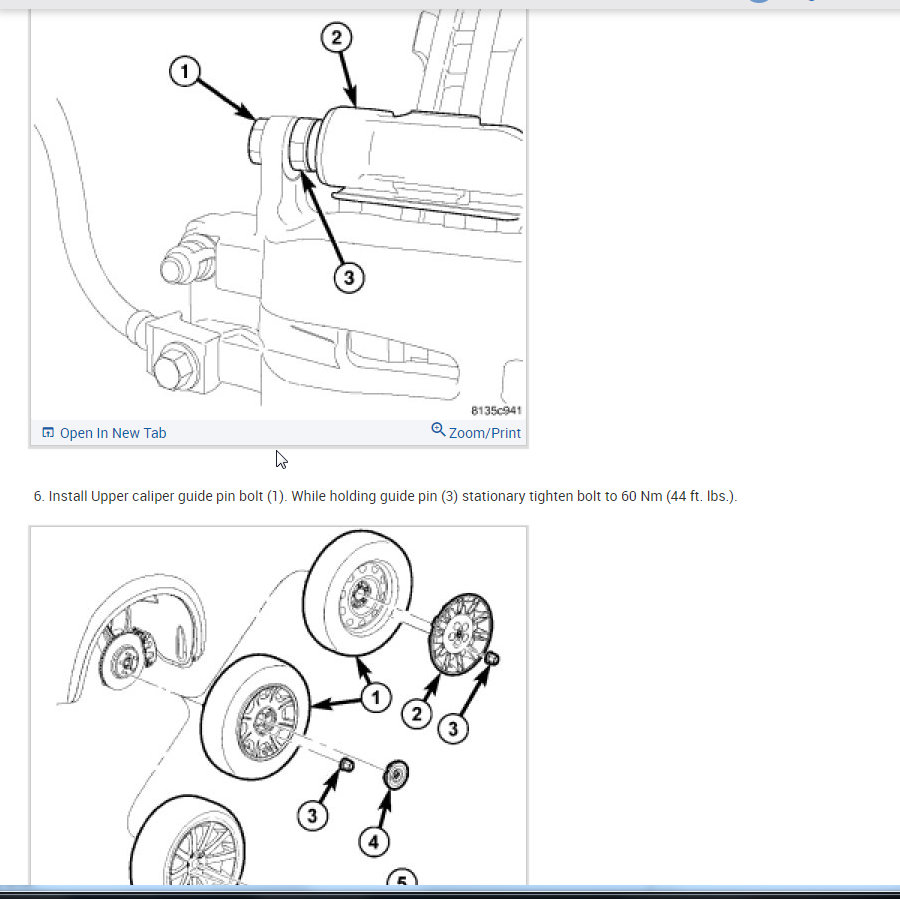

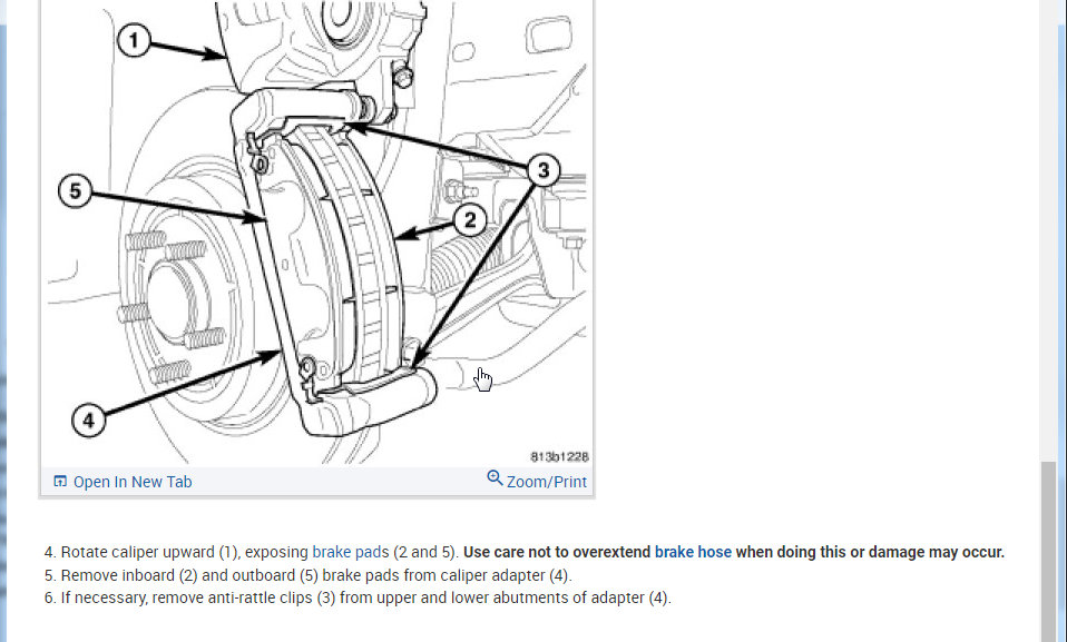

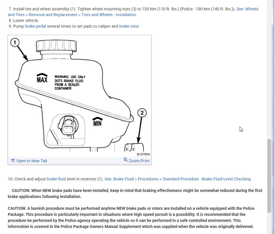

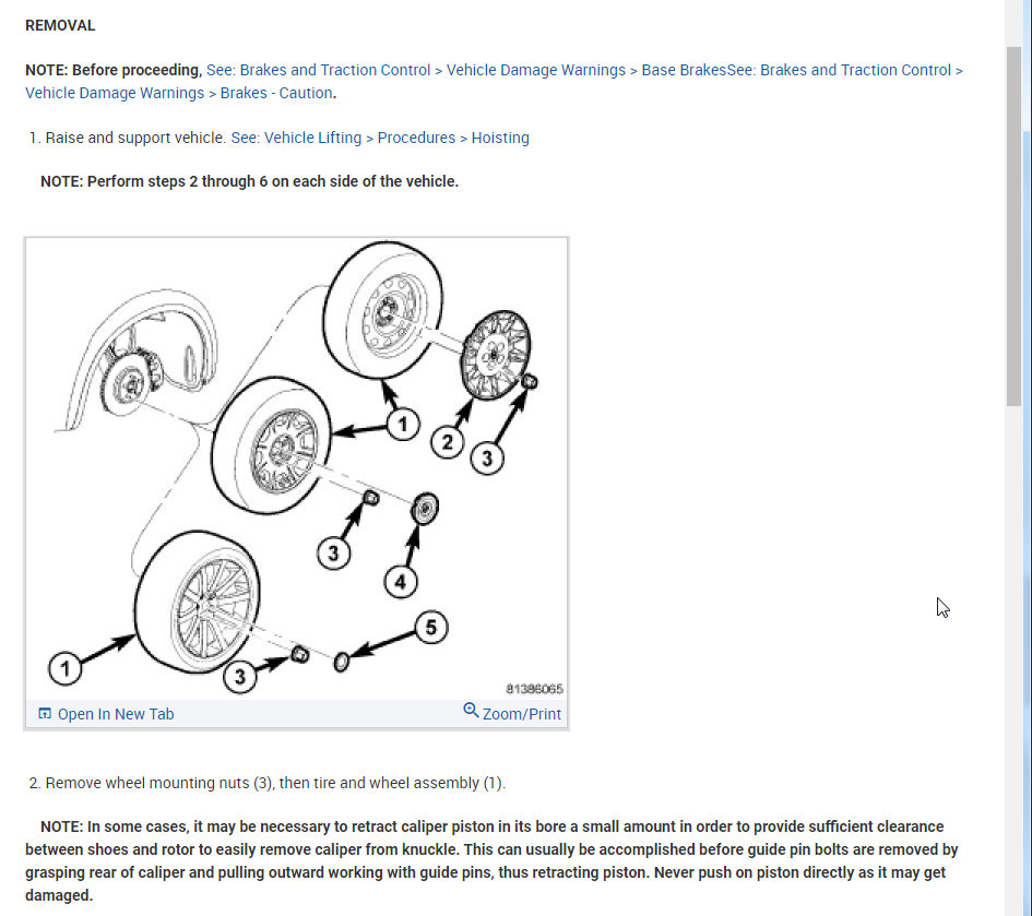

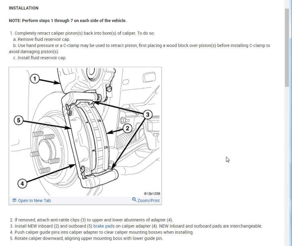

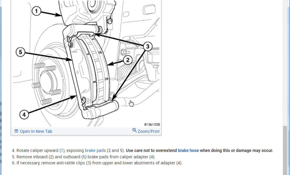

The squeaking is coming from the worn brakes so to answer the question, it can cause the brakes to wear which will start to cause the noise. Here is a guide that will help with replacing the pads and lubricating the pins as well:
Here is a video of a similar vehicle that will help as well:
https://www.youtube.com/watch?v=9S0im10Z2T0
Below you will find the detail from the manual on how to replace the pads and lubricate the pins as well to make sure they are moving.
Please let us know if you have questions. Thanks
