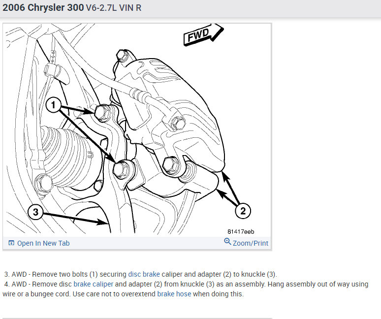

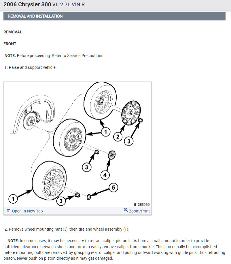

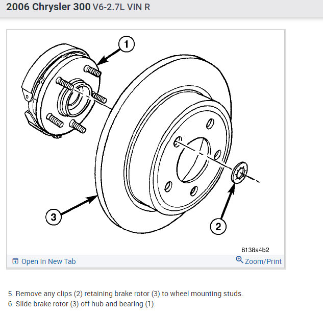

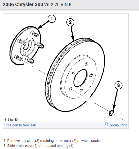

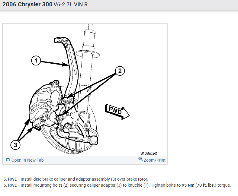

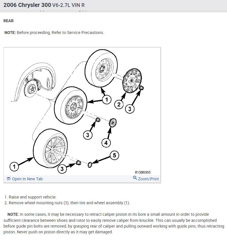

i have the tire,caliper assem. and the lock washers off and the rotor wont come off! any ideas?
Jun 29, 2009 at 1:32 PM
BLUELIGHTNIN6
  • CAR REPAIR CONTRIBUTOR
  • 16,542 POSTS
Okay, if the wheel /tire, caliper and clips /lock washers are already removed but rotor is still stuck on, you will need to gently tap on the rotor with a rubber headed mallet to budge it loose. Careful not to damage any nearby hoses or components.

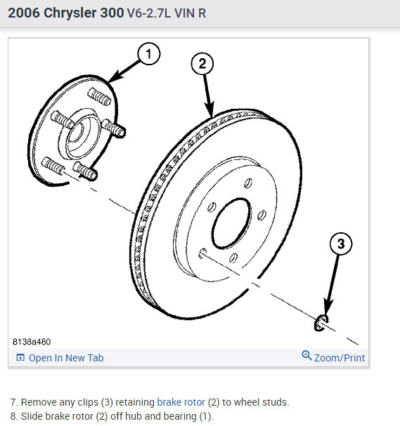

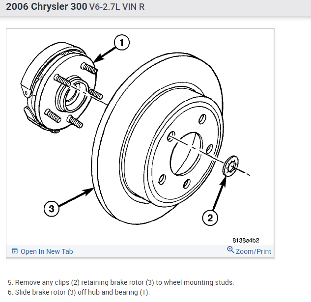

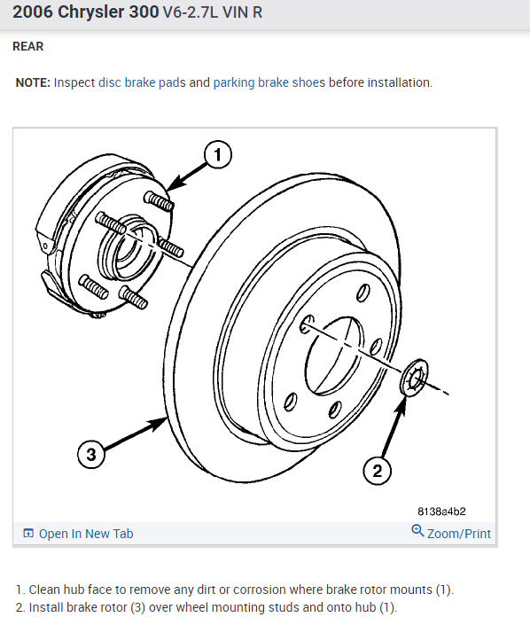

I TRIED THAT AND THE ROTOR BUDGED A LIL BIT,THEN SEEMED 2 GET CAUGHT UP ON SOMETHING..
Mar 15, 2021 at 9:52 AM
BLUELIGHTNIN6
  • 16,542 POSTS
There is no other parts that are installed to hold the rotor on, unless something was put on aftermarket..which I don't know what or why they would do that.. May need to just bang on it a little more. Make sure it's not getting hung up on any brake lines or anything of that nature.

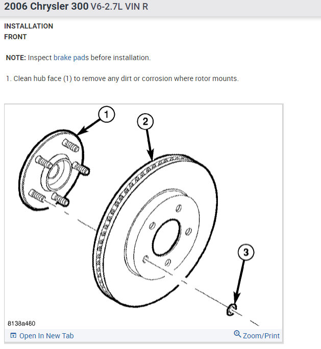

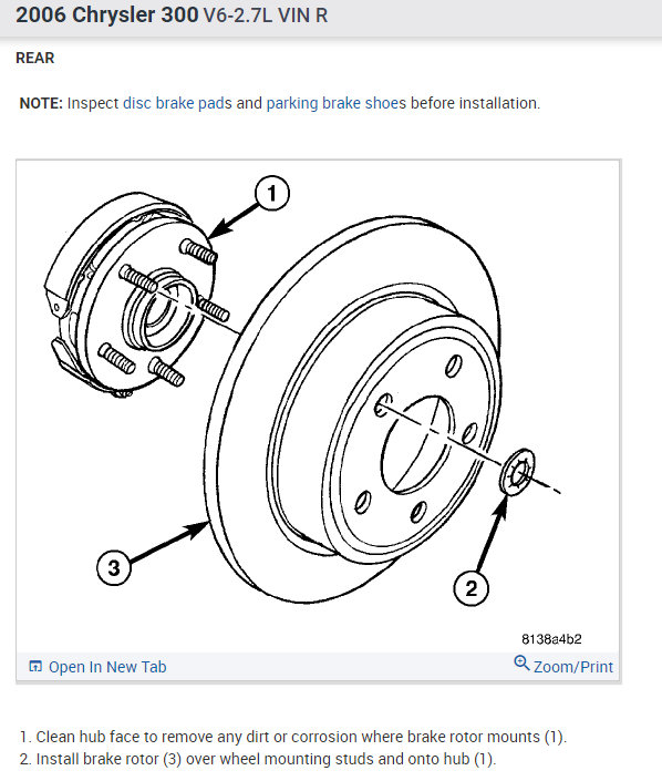

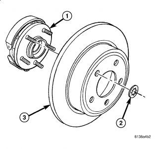

It is quite common for the rotors to be seized on the hub. Sometimes it almost appears that something else might be holding it in as it can sit very tight on the hub.
Hitting the rotor with a mallet typically does the job of loosening the rotor from the hub.
https://www.2carpros.com/articles/how-to-replace-rear-brake-pads-and-rotors
I have included a complete replacement procedure for the rear and the front brake rotors for anyone else that might be doing this job.
