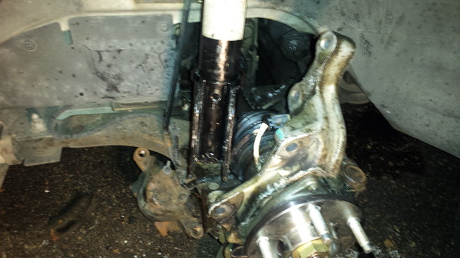

I was changing my front struts on my 2002 Monte Carlo I took the old ones off, And tried to put the new ones on but they are not lining up. The knuckle holes seem to far up from the strut. So I tried to put the old one back on and the same problem

The lower control arm dropped down. Lift it up and see if you can insert a long punch into one of the holes to hold it in place.

I tried that. I seems like the strut is too long. the bottom knuckle hole line up with the top strut screw hole even on the old one.

The lower control arm moves to line up the holes.

when I push down on the control arm the knuckle moves outward. could it be the struts needs to be compressed

The control arm is fine the strut seems like it decompressed after I took it off

I'll say it one more time. The lower control arm move and the knuckle swivels on a ball joint so it can be moved anywhere it needs to be.

this is a image of it
Dec 27, 2015 at 6:17 PM
SEAN27
  • 16 POSTS
the strut seems to long to go over the cv axel and line up in the knuckle I'm sorry if I'm not making everything clear
Dec 27, 2015 at 6:19 PM
WRENCHTECH
  • 20,761 POSTS
Make sure the axle is fully seated at both ends as that will push the knuckle away if it isn't. Also make sure you didn't separate the inner C/V joint.
Dec 27, 2015 at 6:20 PM
SEAN27
  • 16 POSTS
I just replaced the cv axel about an hour ago
Dec 27, 2015 at 6:22 PM
SEAN27
  • 16 POSTS
its weird because the old strut is doing the same thing
Dec 27, 2015 at 6:23 PM
SEAN27
  • 16 POSTS
Hey thanks I figured it out. I didn't have the front end jack up enough LOL Stupid ME
