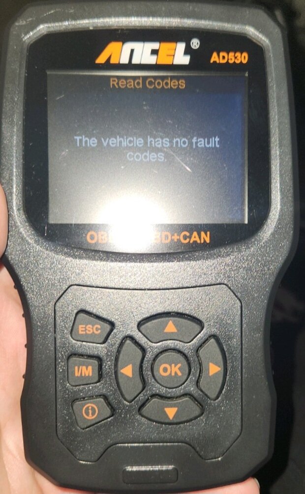

On two separate occasions, about 4 days apart driving the same distance out of town and back home, while driving (65/ 70 MPH on the interstate) the RPMs are running steady at approximately 2,600 RPMs. After driving for more than 45 minutes the RPMs jump from 2,600 RPMs to 4,000 RPMs, just for a few seconds, then drops back down to 2,600 RPMs. Then for the rest of my 2 1/2 hour trip everything is fine. No loss of power or shaking of the car when the episode happens. It doesn't happen again for the rest of the drive. I didn't get to scan my vehicle right away when I reached my destination, but I scanned it about 6 hours later and no error code was found.

Based on your original description, it sounds like the transmission slipped. The idea that there are no codes may simply be caused by the code type. Some require a fault to occur two times or a failure or fault to last a certain amount of time.
At this point, we have two ways to go. First, wait and see if it continues to happen and eventually sets a code or you could scan the can-bus to see if anything is stored.
