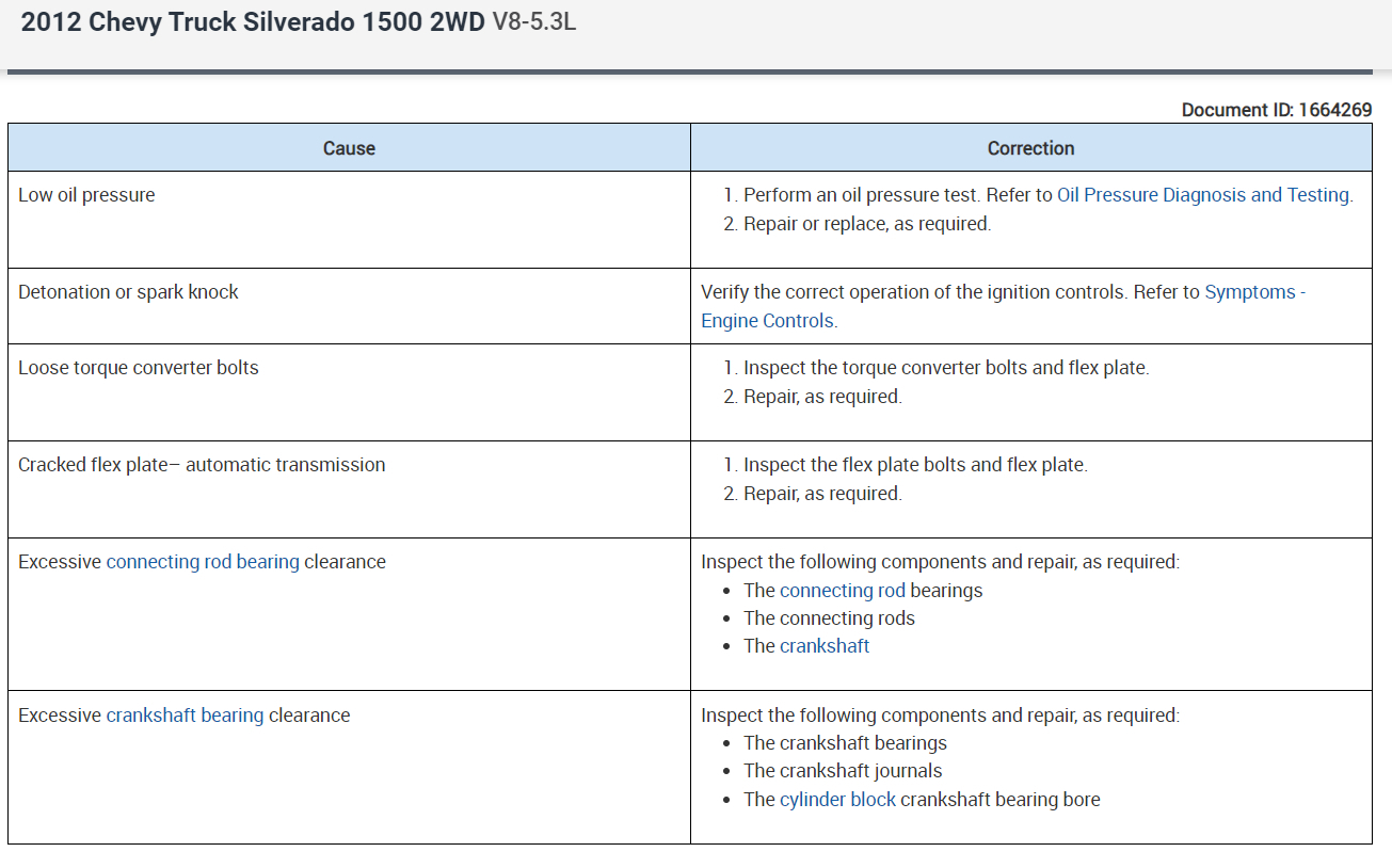

Changed the lifters in my truck listed above 1500 and now the ticking noise is still there. It’s definitely not as loud but it’s still there. Any ideas on what this is? Please help!!

Did you check for a broken valve spring or a bad roller rocker? Also, it could be carbon on top of the piston, or you have a seized wrist pin, can you tell which side of the engine noise is coming from?

Please check the images below for more trouble tree information. Check out the images (below). Please let us know what happens.
