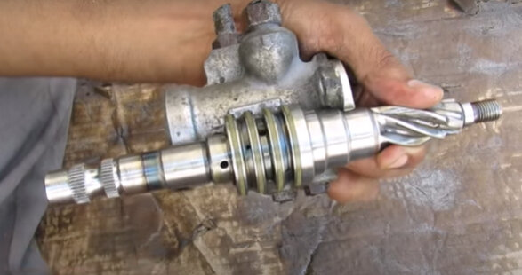

The pressure and return line generally have different pressures in them. If they were switched it is likely it would blow the return line off since it is made of multiple pieces and the pressure line is not. However just to be sure, I am going to look up the lines for you and see what the thread size is for them. Since it is a smaller, lighter vehicle, the pressures in the system would be a lot lower.
Where the lines enter the steering rack, the pressure and the return, there is a control valve. (see images) When you are not turning the steering wheel, the power steering fluid is pushed into the control valve by the pump and then exits immediately through the return line after passing through the valve. When you turn the wheel however fluid should be directed to one side or the other. It is possible this control valve is faulty.
There also may be air trapped in the steering rack. Since air compresses and fluid does not, the air might be getting compressed and acting like a spring, shooting the rack in the opposite direction. If there is air on both sides, then that could explain it going back and forth like that.

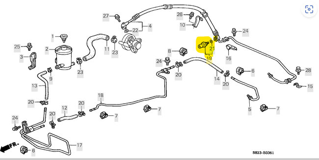

I also took a look at the lines and the rack and the fittings for the lines look like they are the same size. So, it is possible they are switched.
As far as symptoms if that had been done, I don't have any information on it.
I would keep trying to bleed it with the car off. If there is no air coming out, then maybe try switching the lines and start the bleeding process over.
Normally it is hard to get the lines in the wrong spot but not impossible. They usually fit one way.
I did find a video where the power steering pressure line looks like it is the forward most line, furthest from the firewall and should have pink paint on it.

Also check the pressure sensor on the pressure side. I have added an image. Looks like it is going to be closer to the rack. Maybe it was damaged?

Otherwise, I did not check the pressure switch. Which I should of but I was at my wits end.
