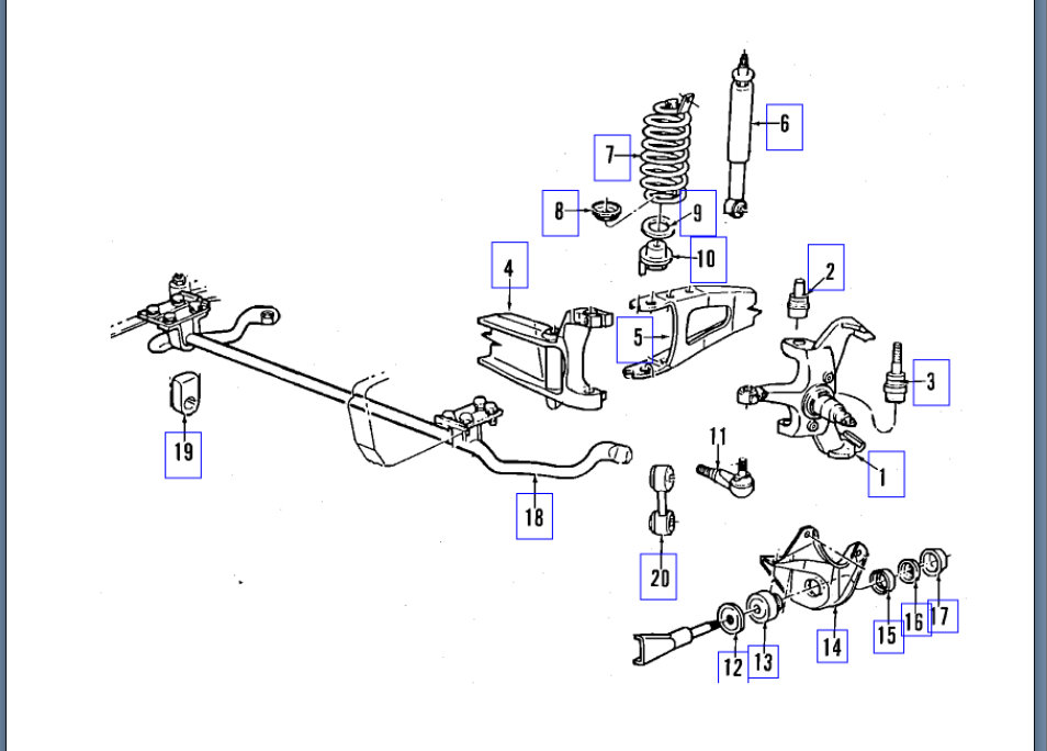

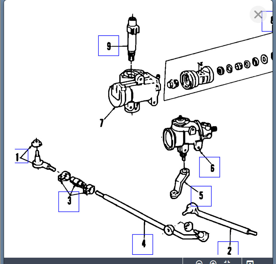

I was in a accident and ever since then I can turn to the right all the way but the left I can only turn barley at all until stops all the way.
Jun 27, 2021 at 3:28 PM
Was the accident involving the front end at all? More then likely this is due to a steering or suspension component is bent and it is preventing you from turning. There is a change that this is a steering gear issue but more then likely it is one of the steering components.
https://www.2carpros.com/articles/power-steering-problems
I am attaching the diagrams below for the suspension and steering components for you to review and then inspect them on your truck. I would lay on the ground and turn all the way in both directions to find where the binding is.
Please let us know if you have questions on this. Thanks
