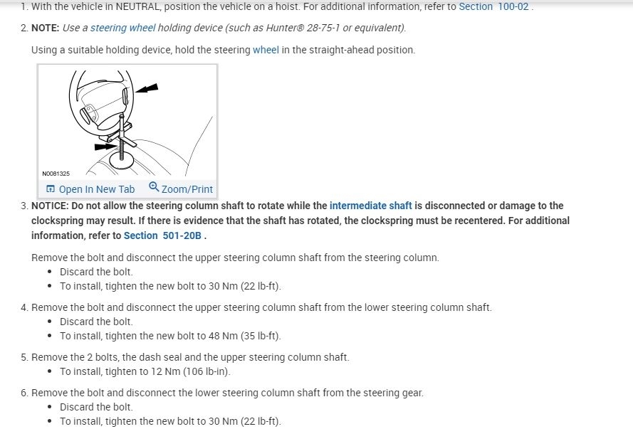

I have the truck listed above with a 6 inch lift kit. My transmission went bad so I purchased a rebuilt one and they also replaced two u joints. Now my steering won't return to center like before I had those repairs. Would the u joint replacement have anything to do with my steering not returning to center?

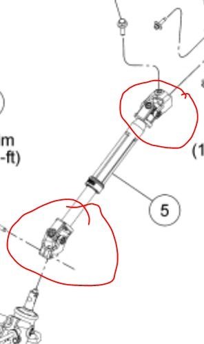

Good evening,
Do you mean the u joints in the driveshaft or the joints in the steering shaft?
The driveshaft would not affect it but if the ones in the steering shaft were replaced, they could cause this issue.
