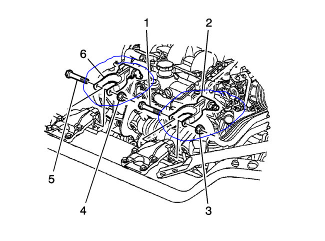

Also, there is a blowed clunking noise that that comes when I accelerate or brake. And you can fill it throughout the car as well as hear it. first i thought it was a motor mount or strut but now I am thinking it might be the steering rack. I am busy getting my new shop done before it snows and haven't had time to diagnose the issue yet.

The wobble may be a bad tire causing the wheel to wobble. The rack rarely causes this issue. Try rotating the tires and see if the wobble goes away.
https://www.2carpros.com/articles/steering-wheel-shakes-when-accelerating-or-braking

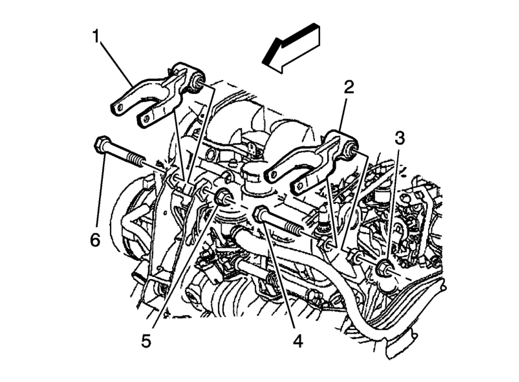

As far as the clunk, check the engine struts at the top of the motor. They are very common for this issue.
https://www.2carpros.com/articles/replace-motor-mounts
