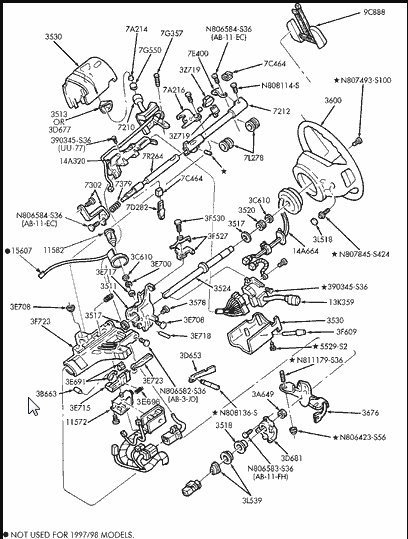

I want to know if a 2003 steering column will fit the truck listed above.
Jan 18, 2021 at 10:34 PM
  • 110,240 POSTS
I don't believe these two model years will cross. As far as replacement, here are directions for removal and replacement.

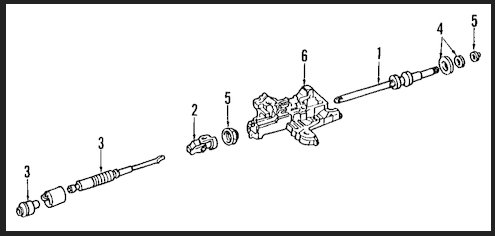

Jan 20, 2021 at 10:02 AM
You may be able to alter your mounting locations but these columns are different and do not appear to bolt up to each others locations.
The columns that will fit your vehicle with no issue appear to be from 1992-1996. Other then this, you may be able to get them to work but it is going to take alterations and you will have wiring issues.
Let us know if you have other questions. Below is the diagram for your vehicle and the 2003. They are not the best but do show these are different columns.
