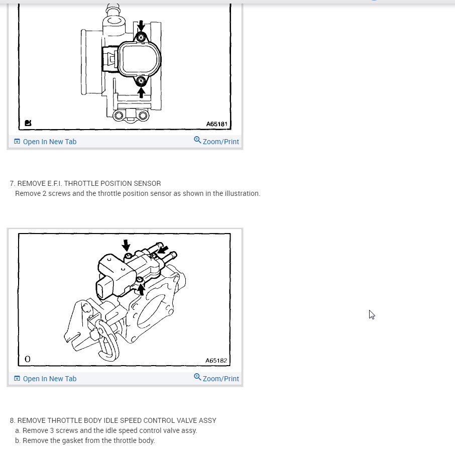

Can you give us the actual trouble code numbers? We need that to help you more effectively. This sounds like you have a vacuum leak, dirty throttle bore or the IAC motor is not working but to be sure lets check out these guides to help us fix it.

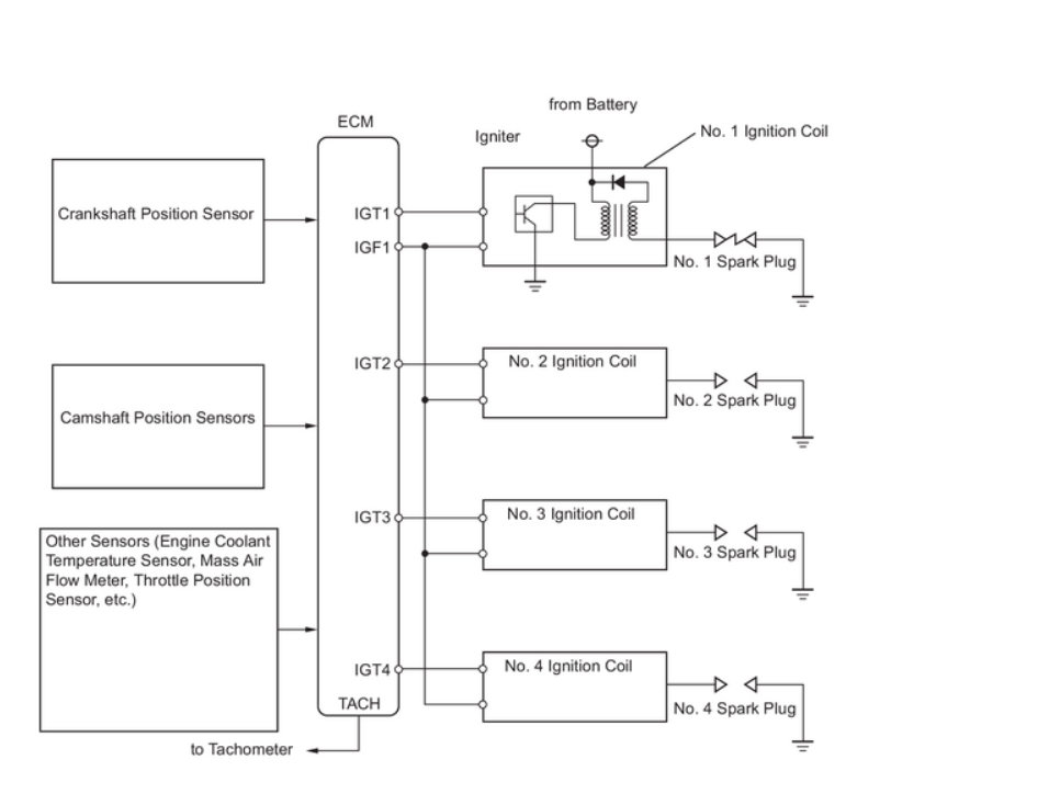

You could get those coil codes if the voltage to the coils was low or dropping out, that would also cause the stalling you have as the coils and injectors share that power feed.
It could be a short in a coil or injector that is shutting them all down as the codes all relate to the ignition signal not returning to the ECM from the coil. The coils all share the power feed, the ground and the signal return. To test the easiest way would be to simply unplug the connector on each coil one at a time and try running the engine, if it's a shorted coil or bad signal the coil you unplug and the engine runs is the one sending a bad return signal. If you unplug each and there is no change then Go to the IG2 relay in the box under the hood on the left side and see if it is turning off after the two seconds. If it isn't then check to see if the fuel pump relay (C/OPN) is turning on when you first turn on the key and then staying on once the engine tries to run, it's in the fuse panel on the end of the dash.

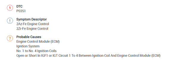

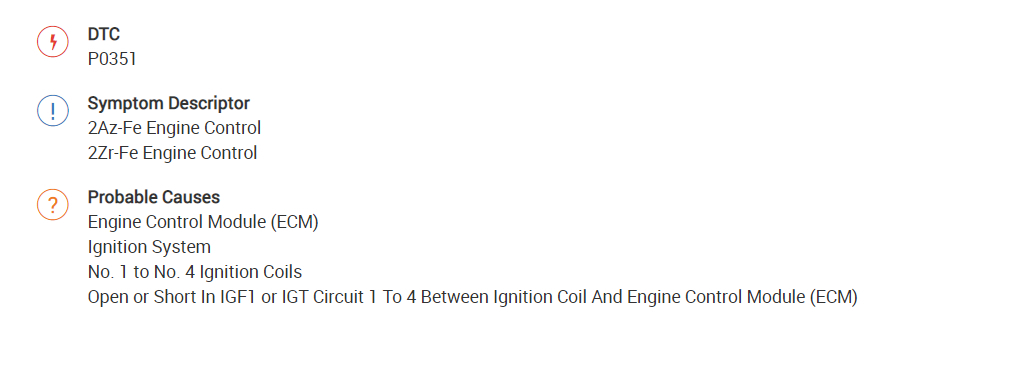

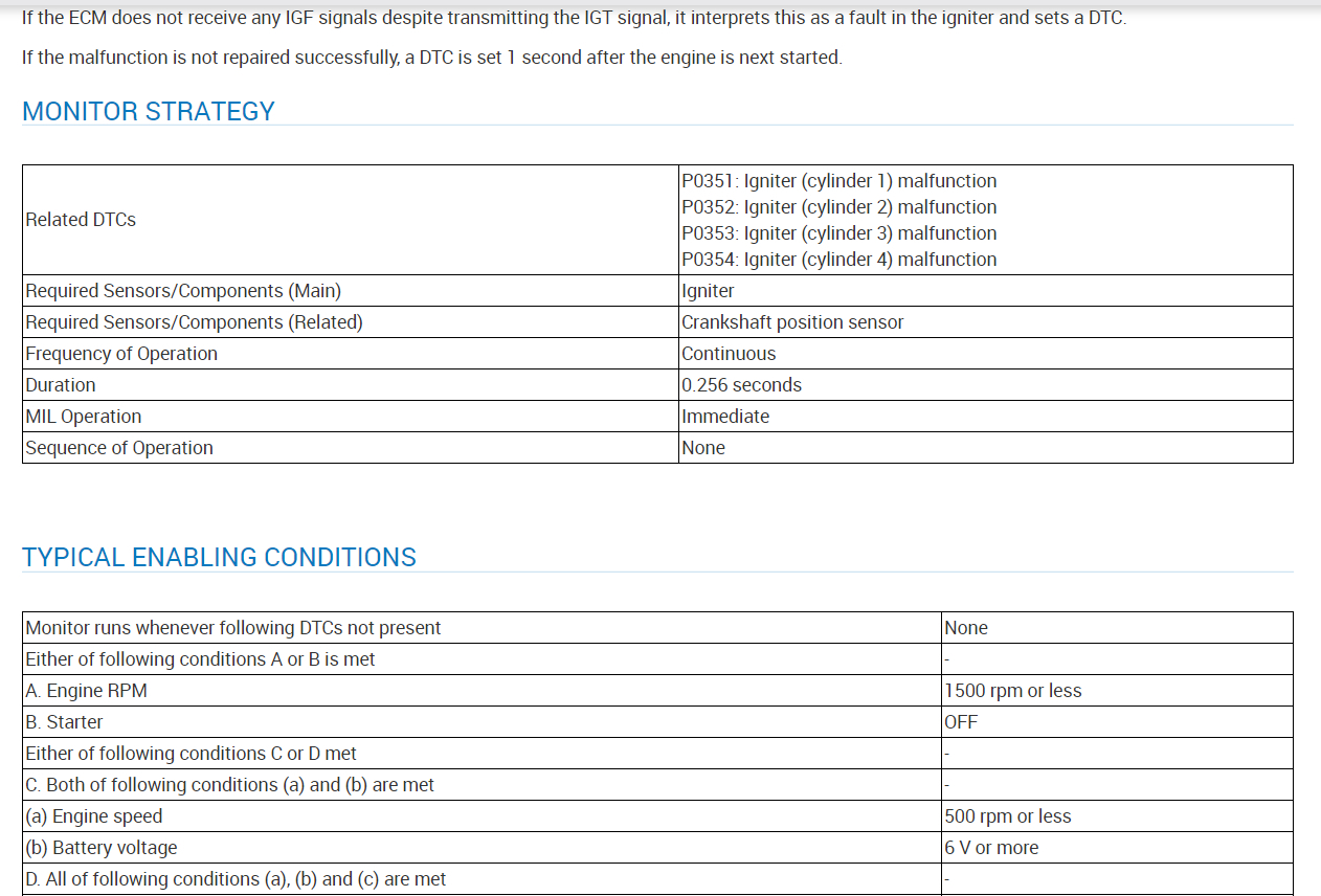

I attached the meanings of the codes for you below. You need to test for power to the coils to see if power is present for them to work.
How did you test the coils? They should have power with the key in the on position. I attached a wiring diagram for you as well.
DESCRIPTION
HINT:
These DTCs indicate malfunctions relating to the primary circuit.
If DTC P0351 is set, check the No. 1 ignition coil circuit.
If DTC P0352 is set, check the No. 2 ignition coil circuit.
If DTC P0353 is set, check the No. 3 ignition coil circuit.
If DTC P0354 is set, check the No. 4 ignition coil circuit.
A Direct Ignition System (DIS) is used on this vehicle.
The DIS is an ignition system in which each cylinder is ignited by it's own ignition coil and spark plug. The secondary wiring of each ignition coil generates a powerful voltage which is applied directly to each spark plug. The spark passes from the center electrode of the spark plug to the ground electrode.
The ECM determines the ignition timing and transmits the ignition (IGT) signals to each cylinder. Using the IGT signal, the ECM turns the power transistor inside the igniter on and off. The power transistor, in turn, switches on and off the current to the primary coil. When the current to the primary coil is cut off, a powerful voltage is generated in the secondary coil. This voltage is applied to the spark plugs, causing them to spark inside the cylinders. As the ECM cuts the current to the primary coil, the igniter sends back an ignition confirmation (IGF) signal to the ECM, for each cylinder ignition.

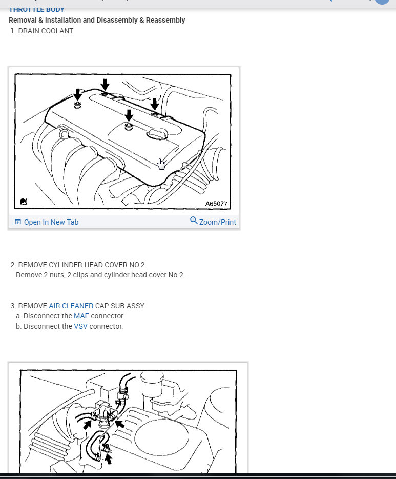

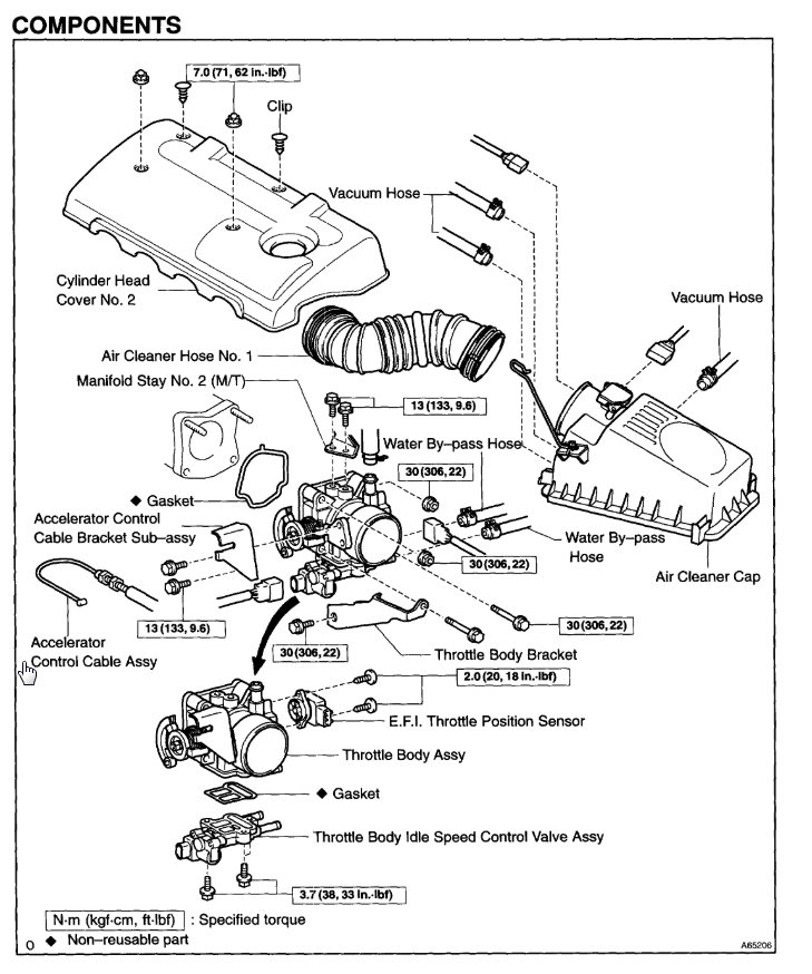

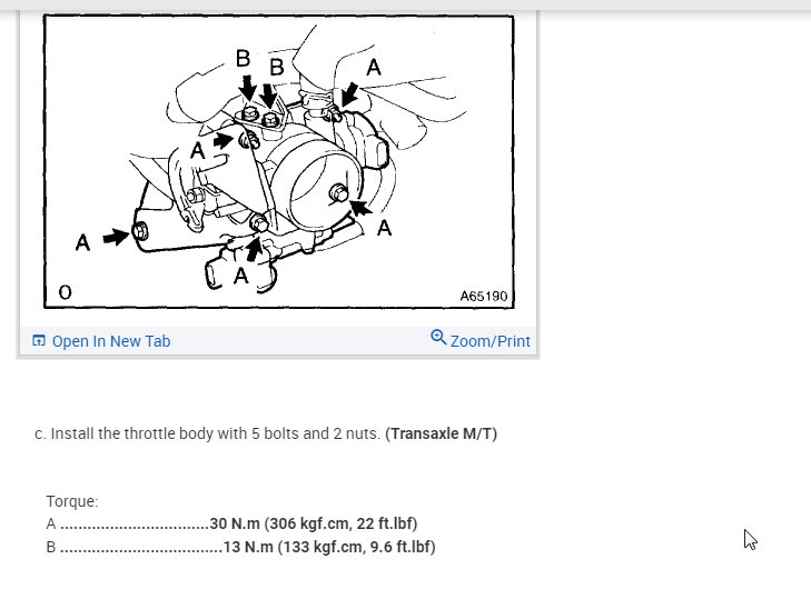

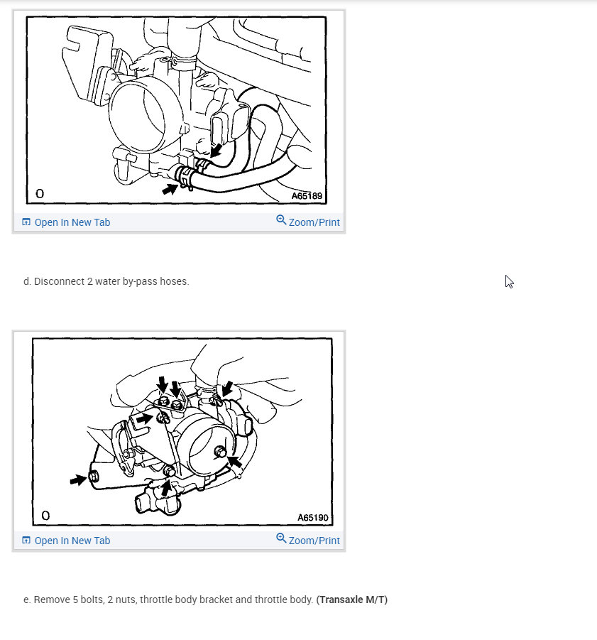

Hi and welcome to 2CarPros. I would recommend you clean the throttle body first. Here is a link on throttle body issues:
Clean it out first and let us know if that help the issue.

This could be as simple as the idle control valve is causing it to stall. However, this normally causes a stall at start up not only when it is warm. However, it would be a good idea to clean the throttle body and ISC valve.
If this does not correct the issue then we need to check for a vacuum leaks. Here is a guide that can help with that. Let me know what you find and we can go from there. Thanks

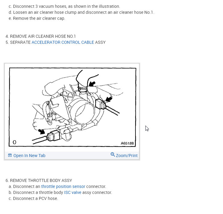

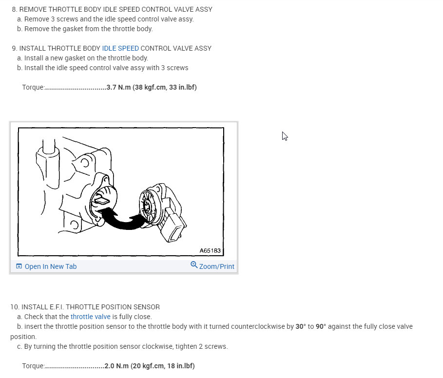

Try cleaning the Idle Air Control Motor. Also clean out around the butterfly in the throttle bore with carb cleaner and a rag. This should help stabilize the idle.Also be sure the tune up is in good shape, at that mileage you should be on your second major tune up
