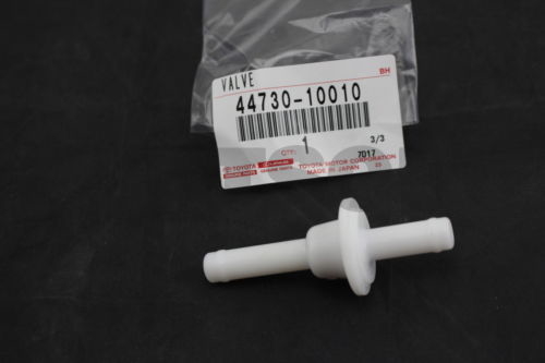

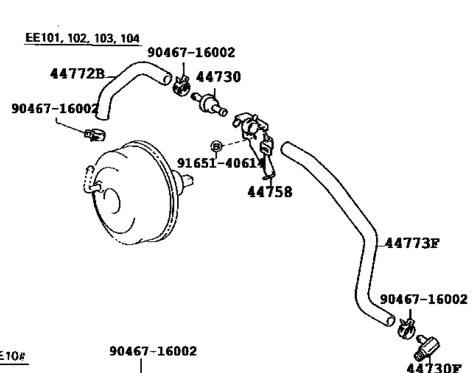

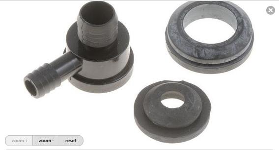

The check valve is plugged into the booster, see pic and look at your booster.
Jan 22, 2021 at 2:55 AM (Merged)
MARIOC68
  • 120 POSTS
The model of my vehicle the valve is not coupled to the booster. It is between the booster hose and the intake manifold, as seen in the images(see 44730).
MHPAUTOS
  • 31,937 POSTS
it should be easy to replace, have you done that yet?
MARIOC68
  • 120 POSTS
I got one. Missing install. Then verify your performance.

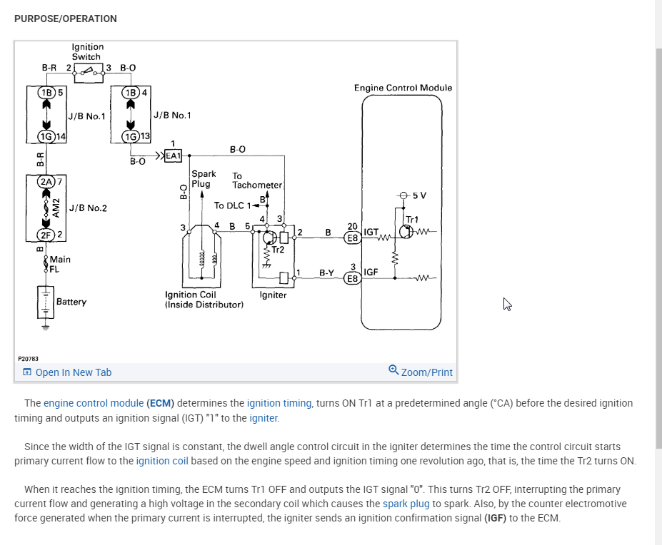

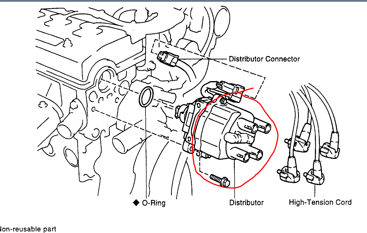

The first thing I would think is the ignition is affected by the moisture. Do me a favor. When this happens and it won't start, check to see if there is spark to the plugs. Here is a link that shows how it's done:
If there is no spark or a weak spark, the first thing I would do is check the distributor cap to make sure it is tight and has no cracks. Also, check to see if the ignition plug wires are in good condition as well as the coil wire to the cap. Have a helper crank the vehicle and see if you notice anything sparking. If you have some down time, open the hood, start the engine, and lightly mist the areas I mentioned with water to see if it causes a stall.
Picture 1 below shows the distributor cap.
Do this and let me know what you find or if you have other questions.

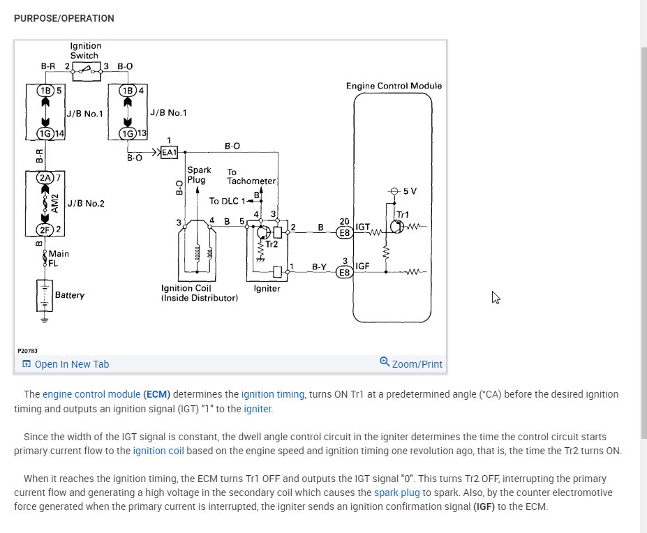

The main thing that is going to affect starting or running when wet is the ignition system. So we need to pull a spark plug and check for a strong blue spark. I suspect you have an issue with the igniter or the coil itself. If you have spark but it is not strong or is even yellowish in color then most likely the secondary side of the coil is the issue so you are not getting the high voltage spark that you need.
I attached the basic info about this system. Let me know what you find with the condition of the spark when this is happening and we can go from there.
